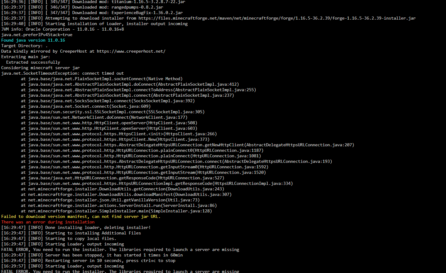

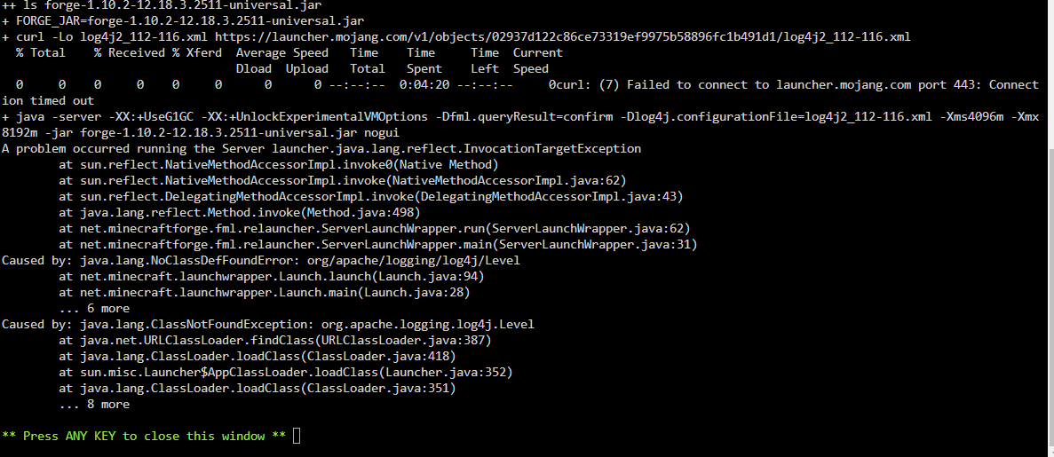

Having issues with multiple versions of the servers - it DID install and work breifly for me.
I was playing Enigmatica 6 with my kid and we restarted the server because I did not give OP to them.
However on restarting we ran into an issue giving "authentication server down"
So checked DNS, Time Settings etc.
Ended up removing docker and reinstalling it.
However it now fails to reinstall at all.
It gets to this part and hangs for around 5 mins then downloads the pack and crashes.
+ curl -Lo log4j2_112-116.xml https://launcher.mojang.com/v1/objects/02937d122c86ce73319ef9975b58896fc1b491d1/log4j2_112-116.xml
This is on the second attempt at starting the server
This is the initial crash message when doing a fresh install.
Any ideas or suggestions at all? I can access intener normally with everything else, have tried without any pihole / pfblocker / suricata etc. still no luck.
Thanks
Edited by Arcau

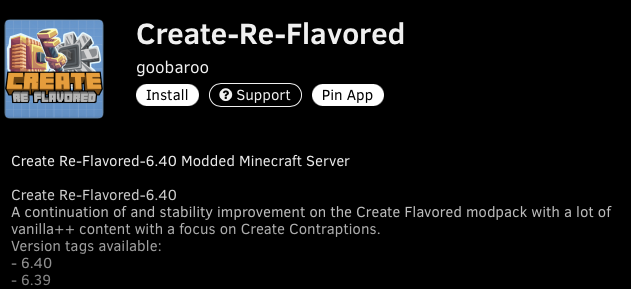

Side note, I figure you must already know, but just in case, your Reflavored container for 6.40 still says it's 6.39 in the unraid container description.
