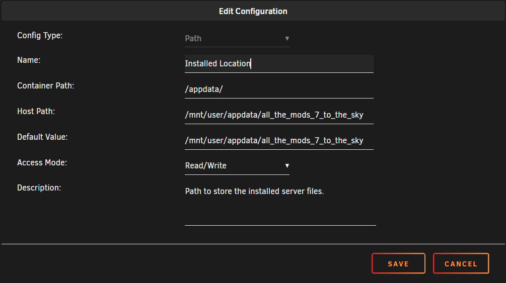

Where are the server files stored? I installed atm7tothesky and it made a folder in appdata, but nothing is in that folder. i did have to change the installed location container path to /appdata in order to get it to start at all, so I don't know if that changed things.
Every template has a value named "Installed Location:" this has the path where the files are stored.  Normally appdata is on the array under /mnt/user/appdata and a sub-directory is created there on start.
I am seeing the folder, but nothing is in there.
@michaelopolis You changed the Container Path to /appdata/. That needs to be reset back to /data/
The way a path works in Docker, is that the container path is where the Host Path will be mounted inside the container.  Changing it to /appdata/ means that the scripts couldn't create any of the files on startup.

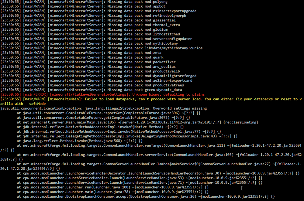

Exception in thread "main" cpw.mods.niofs.union.UnionFileSystem$UncheckedIOException: java.util.zip.ZipException: zip END header not found
Caused by: java.util.zip.ZipException: zip END header not found
        at jdk.zipfs/jdk.nio.zipfs.ZipFileSystem.findEND(ZipFileSystem.java:1320)
        at jdk.zipfs/jdk.nio.zipfs.ZipFileSystem.initCEN(ZipFileSystem.java:1534)
        at jdk.zipfs/jdk.nio.zipfs.ZipFileSystem.<init>(ZipFileSystem.java:179)
        at jdk.zipfs/jdk.nio.zipfs.ZipFileSystemProvider.getZipFileSystem(ZipFileSystemProvider.java:125)
        at jdk.zipfs/jdk.nio.zipfs.ZipFileSystemProvider.newFileSystem(ZipFileSystemProvider.java:120)
        at java.base/java.nio.file.FileSystems.newFileSystem(FileSystems.java:528)
        at java.base/java.nio.file.FileSystems.newFileSystem(FileSystems.java:475)
        at cpw.mods.securejarhandler/cpw.mods.niofs.union.UnionFileSystem.openFileSystem(UnionFileSystem.java:136)
        at java.base/java.util.stream.ReferencePipeline$3$1.accept(ReferencePipeline.java:197)
        at java.base/java.util.stream.ReferencePipeline$2$1.accept(ReferencePipeline.java:179)
        at java.base/java.util.AbstractList$RandomAccessSpliterator.forEachRemaining(AbstractList.java:720)
        at java.base/java.util.stream.AbstractPipeline.copyInto(AbstractPipeline.java:509)
        at java.base/java.util.stream.AbstractPipeline.wrapAndCopyInto(AbstractPipeline.java:499)
        at java.base/java.util.stream.ReduceOps$ReduceOp.evaluateSequential(ReduceOps.java:921)
        at java.base/java.util.stream.AbstractPipeline.evaluate(AbstractPipeline.java:234)
        at java.base/java.util.stream.ReferencePipeline.collect(ReferencePipeline.java:682)
        at cpw.mods.securejarhandler/cpw.mods.niofs.union.UnionFileSystem.<init>(UnionFileSystem.java:131)
        at cpw.mods.securejarhandler/cpw.mods.niofs.union.UnionFileSystemProvider.newFileSystemInternal(UnionFileSystemProvider.java:115)
        at cpw.mods.securejarhandler/cpw.mods.niofs.union.UnionFileSystemProvider.newFileSystem(UnionFileSystemProvider.java:105)
        at cpw.mods.securejarhandler/cpw.mods.jarhandling.impl.Jar.<init>(Jar.java:84)
        at cpw.mods.securejarhandler/cpw.mods.jarhandling.SecureJar.from(SecureJar.java:70)
        at MC-BOOTSTRAP/[email protected]/net.minecraftforge.fml.loading.moddiscovery.ModJarMetadata.buildFile(ModJarMetadata.java:41)
        at MC-BOOTSTRAP/[email protected]/net.minecraftforge.fml.loading.moddiscovery.MinecraftLocator.scanMods(MinecraftLocator.java:37)
        at MC-BOOTSTRAP/[email protected]/net.minecraftforge.fml.loading.moddiscovery.ModDiscoverer.discoverMods(ModDiscoverer.java:75)
        at MC-BOOTSTRAP/[email protected]/net.minecraftforge.fml.loading.FMLLoader.beginModScan(FMLLoader.java:164)
        at MC-BOOTSTRAP/[email protected]/net.minecraftforge.fml.loading.FMLServiceProvider.beginScanning(FMLServiceProvider.java:86)
        at MC-BOOTSTRAP/[email protected]/cpw.mods.modlauncher.TransformationServiceDecorator.runScan(TransformationServiceDecorator.java:112)
        at MC-BOOTSTRAP/[email protected]/cpw.mods.modlauncher.TransformationServicesHandler.lambda$runScanningTransformationServices$8(TransformationServicesHandler.java:100)
        at java.base/java.util.HashMap$ValueSpliterator.forEachRemaining(HashMap.java:1779)
        at java.base/java.util.stream.AbstractPipeline.evaluate(AbstractPipeline.java:575)
        at java.base/java.util.stream.AbstractPipeline.evaluateToArrayNode(AbstractPipeline.java:260)
        at java.base/java.util.stream.ReferencePipeline.toArray(ReferencePipeline.java:616)
        at java.base/java.util.stream.ReferencePipeline.toArray(ReferencePipeline.java:622)
        at java.base/java.util.stream.ReferencePipeline.toList(ReferencePipeline.java:627)
        at MC-BOOTSTRAP/[email protected]/cpw.mods.modlauncher.TransformationServicesHandler.runScanningTransformationServices(TransformationServicesHandler.java:102)
        at MC-BOOTSTRAP/[email protected]/cpw.mods.modlauncher.TransformationServicesHandler.initializeTransformationServices(TransformationServicesHandler.java:55)
        at MC-BOOTSTRAP/[email protected]/cpw.mods.modlauncher.Launcher.run(Launcher.java:88)
        at MC-BOOTSTRAP/[email protected]/cpw.mods.modlauncher.Launcher.main(Launcher.java:78)
        at MC-BOOTSTRAP/[email protected]/cpw.mods.modlauncher.BootstrapLaunchConsumer.accept(BootstrapLaunchConsumer.java:26)
        at MC-BOOTSTRAP/[email protected]/cpw.mods.modlauncher.BootstrapLaunchConsumer.accept(BootstrapLaunchConsumer.java:23)
        at [email protected]/cpw.mods.bootstraplauncher.BootstrapLauncher.main(BootstrapLauncher.java:141)
2024-05-27 12:12:17,861 main WARN Advanced terminal features are not available in this environment
[12:12:18] [main/INFO] [cp.mo.mo.Launcher/MODLAUNCHER]: ModLauncher running: args [--launchTarget, forgeserver, --fml.forgeVersion, 47.2.20, --fml.mcVersion, 1.20.1, --fml.forgeGroup, net.minecraftforge, --fml.mcpVersion, 20230612.114412]
[12:12:18] [main/INFO] [cp.mo.mo.Launcher/MODLAUNCHER]: ModLauncher 10.0.9+10.0.9+main.dcd20f30 starting: java version 17.0.2 by Oracle Corporation; OS Linux arch amd64 version 6.1.38-Unraid
[12:12:29] [main/INFO] [ne.mi.fm.lo.ImmediateWindowHandler/]: ImmediateWindowProvider not loading because launch target is forgeserver
[12:12:29] [main/INFO] [mixin/]: SpongePowered MIXIN Subsystem Version=0.8.5 Source=union:/data/libraries/org/spongepowered/mixin/0.8.5/mixin-0.8.5.jar%2365!/ Service=ModLauncher Env=SERVER
Please advise.
