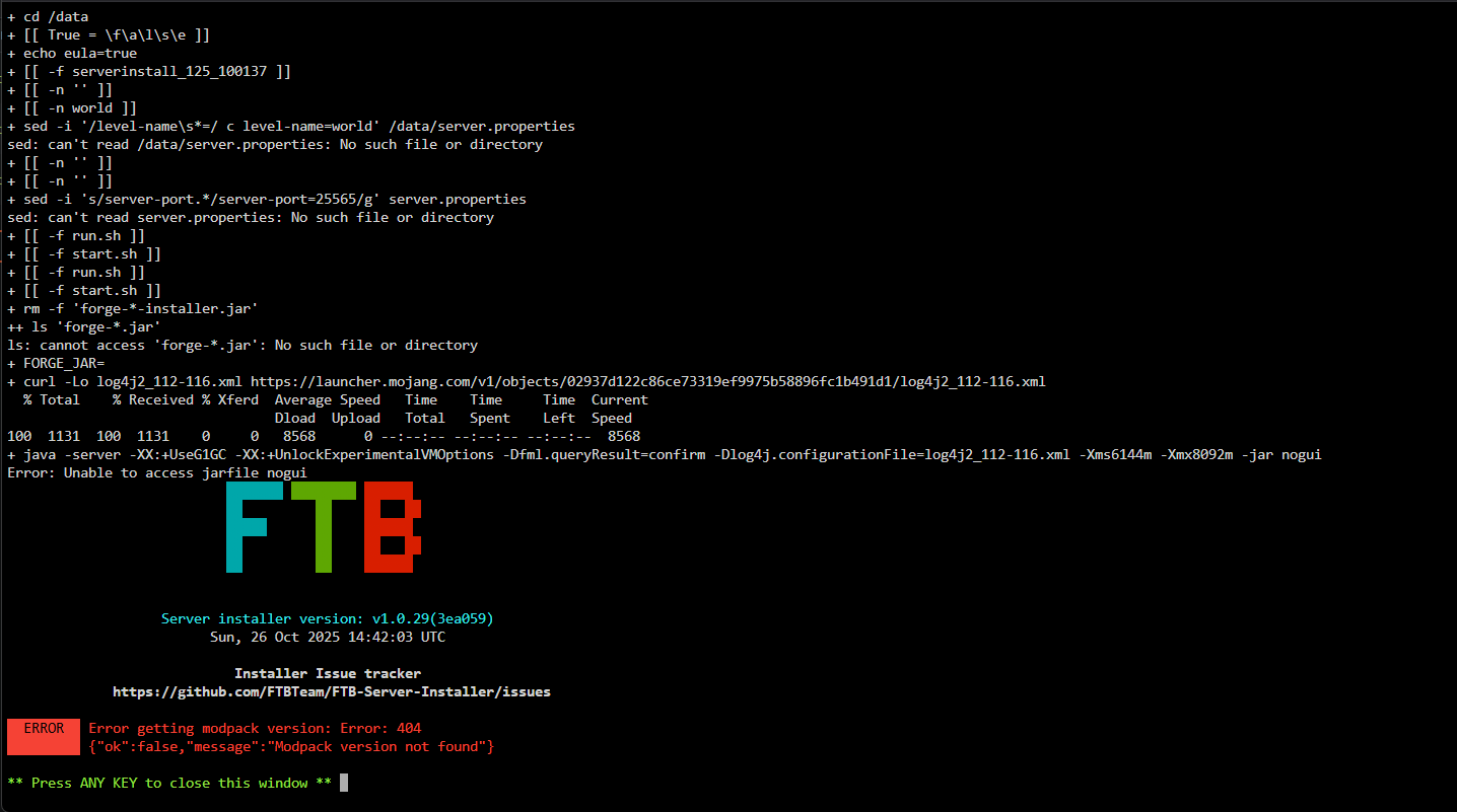

@Goobaroo any idea on how to get past this error? I am using FTB Evolution and (I am ashamed to admit) I destroyed my world because I copied it to my PC to update it manually and then deleted the one from my unraid without FIRST checking I had copied everything, so ye, props to my brain.
Anyhow I am trying to start from scratch, so I removed all the files in appdata and removed the docker and image, now I am trying to install it again but I keep running into this error, no matter what I try I cannot get past it.
No worries I managed to get past it by restoring an older backup of the normal server files and then re-updating the docker container.
@Goobaroo I am getting this same error when attempting to install fresh.
I had this same error this morning. I compared the backups I had and only found one file missing run.sh. Once I placed that file back I was able to get my server up and going again. Just needed to drop it in the root of folder where run.bat is located.
run.sh
@younkster There was an issue with that release and the container was updated while it was broken. There is a newer version that was just published that should work.
That error you see is the FTB installer failing, which is an FTB issue, not a problem with the container itself.
Version 1.24.2 should be fine though.
cc: @skiiwee29
Edited by Goobaroo

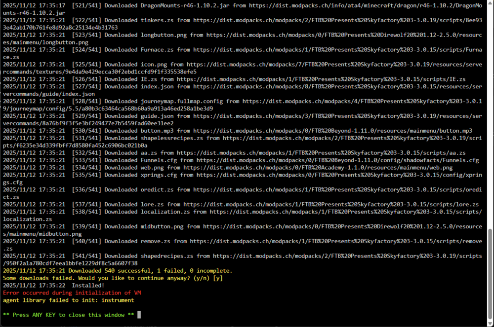

Hello @Goobaroo
Im running into this problem when installing Sky Factory 3 Server.
Edited by FreakFriends
  • 4 weeks later...
@FreakFriends Should be fixed. You'll just need to clear out the appdata/ftbskyfactory3 and force update the docker container so it will pull the fixed image and restart the install.

2025-12-15T14:55:39.832619180Z [09:55:39] [main/WARN] [minecraft/MinecraftServer]: Missing data pack mod:supermartijn642corelib
2025-12-15T14:55:39.833077716Z [09:55:39] [main/WARN] [minecraft/MinecraftServer]: Missing data pack mod:simplylight
2025-12-15T14:55:39.833496927Z [09:55:39] [main/WARN] [minecraft/MinecraftServer]: Missing data pack mod:botania
2025-12-15T14:55:39.833914394Z [09:55:39] [main/WARN] [minecraft/MinecraftServer]: Missing data pack mod:fairylights
2025-12-15T14:55:39.834373278Z [09:55:39] [main/WARN] [minecraft/MinecraftServer]: Missing data pack mod:highlighter
2025-12-15T14:55:39.834610445Z [09:55:39] [main/WARN] [minecraft/MinecraftServer]: Missing data pack mod:spark
2025-12-15T14:55:39.835016994Z [09:55:39] [main/WARN] [minecraft/MinecraftServer]: Missing data pack mod:curios
2025-12-15T14:55:39.835303253Z [09:55:39] [main/WARN] [minecraft/MinecraftServer]: Missing data pack mod:patchouli
2025-12-15T14:55:39.835730493Z [09:55:39] [main/WARN] [minecraft/MinecraftServer]: Missing data pack mod:camera
2025-12-15T14:55:39.835977812Z [09:55:39] [main/WARN] [minecraft/MinecraftServer]: Missing data pack mod:blockcarpentry
2025-12-15T14:55:39.836396986Z [09:55:39] [main/WARN] [minecraft/MinecraftServer]: Missing data pack mod:libnonymous
2025-12-15T14:55:39.836812131Z [09:55:39] [main/WARN] [minecraft/MinecraftServer]: Missing data pack mod:elevatorid
2025-12-15T14:55:39.837127837Z [09:55:39] [main/WARN] [minecraft/MinecraftServer]: Missing data pack mod:runelic
2025-12-15T14:55:39.837530421Z [09:55:39] [main/WARN] [minecraft/MinecraftServer]: Missing data pack mod:cfm
2025-12-15T14:55:39.837818598Z [09:55:39] [main/WARN] [minecraft/MinecraftServer]: Missing data pack mod:architectury
2025-12-15T14:55:39.838274336Z [09:55:39] [main/WARN] [minecraft/MinecraftServer]: Missing data pack mod:weirdinggadget
2025-12-15T14:55:39.838562551Z [09:55:39] [main/WARN] [minecraft/MinecraftServer]: Missing data pack mod:mcwfurnitures
2025-12-15T14:55:39.839085410Z [09:55:39] [main/WARN] [minecraft/MinecraftServer]: Missing data pack mod:trashcans
2025-12-15T14:55:39.840567403Z [09:55:39] [main/WARN] [minecraft/MinecraftServer]: Missing data pack mod:geckolib3
2025-12-15T14:55:39.841067933Z [09:55:39] [main/WARN] [minecraft/MinecraftServer]: Missing data pack mod:mcwlights
2025-12-15T14:55:39.841324569Z [09:55:39] [main/WARN] [minecraft/MinecraftServer]: Missing data pack mod:cucumber
2025-12-15T14:55:39.841756913Z [09:55:39] [main/WARN] [minecraft/MinecraftServer]: Missing data pack mod:snad
2025-12-15T14:55:39.842476774Z [09:55:39] [main/WARN] [minecraft/MinecraftServer]: Missing data pack mod:jei
2025-12-15T14:55:39.842730534Z [09:55:39] [main/WARN] [minecraft/MinecraftServer]: Missing data pack mod:bdlib
2025-12-15T14:55:39.843008558Z [09:55:39] [main/WARN] [minecraft/MinecraftServer]: Missing data pack mod:waystones
2025-12-15T14:55:39.843297631Z [09:55:39] [main/WARN] [minecraft/MinecraftServer]: Missing data pack mod:clumps
2025-12-15T14:55:39.843740498Z [09:55:39] [main/WARN] [minecraft/MinecraftServer]: Missing data pack mod:shutupexperimentalsettings
2025-12-15T14:55:39.844036522Z [09:55:39] [main/WARN] [minecraft/MinecraftServer]: Missing data pack mod:comforts
2025-12-15T14:55:39.844471819Z [09:55:39] [main/WARN] [minecraft/MinecraftServer]: Missing data pack mod:naturescompass
2025-12-15T14:55:39.844846923Z [09:55:39] [main/WARN] [minecraft/MinecraftServer]: Missing data pack mod:storagenetwork
2025-12-15T14:55:39.845142379Z [09:55:39] [main/WARN] [minecraft/MinecraftServer]: Missing data pack mod:framedcompactdrawers
2025-12-15T14:55:39.845459330Z [09:55:39] [main/WARN] [minecraft/MinecraftServer]: Missing data pack mod:decorative_blocks
2025-12-15T14:55:39.845888550Z [09:55:39] [main/WARN] [minecraft/MinecraftServer]: Missing data pack mod:botanypots
2025-12-15T14:55:39.846153829Z [09:55:39] [main/WARN] [minecraft/MinecraftServer]: Missing data pack mod:mcjtylib
2025-12-15T14:55:39.846455013Z [09:55:39] [main/WARN] [minecraft/MinecraftServer]: Missing data pack mod:rftoolsbase
2025-12-15T14:55:39.846778999Z [09:55:39] [main/WARN] [minecraft/MinecraftServer]: Missing data pack mod:xnet
2025-12-15T14:55:39.847152829Z [09:55:39] [main/WARN] [minecraft/MinecraftServer]: Missing data pack mod:ispawner
2025-12-15T14:55:39.851494009Z [09:55:39] [main/WARN] [minecraft/MinecraftServer]: Missing data pack mod:everycomp
2025-12-15T14:55:39.852159526Z [09:55:39] [main/WARN] [minecraft/MinecraftServer]: Missing data pack mod:jeitweaker
2025-12-15T14:55:39.852433236Z [09:55:39] [main/WARN] [minecraft/MinecraftServer]: Missing data pack mod:terralith
2025-12-15T14:55:39.852742138Z [09:55:39] [main/WARN] [minecraft/MinecraftServer]: Missing data pack mod:mininggadgets
2025-12-15T14:55:39.853279292Z [09:55:39] [main/WARN] [minecraft/MinecraftServer]: Missing data pack mod:crafttweaker
2025-12-15T14:55:39.853529372Z [09:55:39] [main/WARN] [minecraft/MinecraftServer]: Missing data pack mod:mekanism
2025-12-15T14:55:39.853811961Z [09:55:39] [main/WARN] [minecraft/MinecraftServer]: Missing data pack mod:chunkymcchunkface
2025-12-15T14:55:39.854095741Z [09:55:39] [main/WARN] [minecraft/MinecraftServer]: Missing data pack mod:waddles
2025-12-15T14:55:39.854367385Z [09:55:39] [main/WARN] [minecraft/MinecraftServer]: Missing data pack mod:colossalchests
2025-12-15T14:55:39.854651117Z [09:55:39] [main/WARN] [minecraft/MinecraftServer]: Missing data pack mod:selene
2025-12-15T14:55:39.855272776Z [09:55:39] [main/WARN] [minecraft/MinecraftServer]: Missing data pack mod:supplementaries
2025-12-15T14:55:39.855460871Z [09:55:39] [main/WARN] [minecraft/MinecraftServer]: Missing data pack mod:craftingtweaks
2025-12-15T14:55:39.855903270Z [09:55:39] [main/WARN] [minecraft/MinecraftServer]: Missing data pack mod:cofh_core
2025-12-15T14:55:39.856152244Z [09:55:39] [main/WARN] [minecraft/MinecraftServer]: Missing data pack mod:thermal
2025-12-15T14:55:39.856576957Z [09:55:39] [main/WARN] [minecraft/MinecraftServer]: Missing data pack mod:thermal_expansion
2025-12-15T14:55:39.859864558Z [09:55:39] [main/WARN] [minecraft/MinecraftServer]: Missing data pack mod:terrablender
2025-12-15T14:55:39.861807271Z [09:55:39] [main/WARN] [minecraft/MinecraftServer]: Missing data pack mod:sophisticatedbackpacksvh
2025-12-15T14:55:39.862095502Z [09:55:39] [main/WARN] [minecraft/MinecraftServer]: Missing data pack mod:sophisticatedbackpacks
2025-12-15T14:55:39.862440716Z [09:55:39] [main/WARN] [minecraft/MinecraftServer]: Missing data pack mod:titanium
2025-12-15T14:55:39.862784403Z [09:55:39] [main/WARN] [minecraft/MinecraftServer]: Missing data pack mod:jade
2025-12-15T14:55:39.863217879Z [09:55:39] [main/WARN] [minecraft/MinecraftServer]: Missing data pack mod:ae2
2025-12-15T14:55:39.863473301Z [09:55:39] [main/WARN] [minecraft/MinecraftServer]: Missing data pack mod:merequester
2025-12-15T14:55:39.863749741Z [09:55:39] [main/WARN] [minecraft/MinecraftServer]: Missing data pack mod:ae2things
2025-12-15T14:55:39.864030429Z [09:55:39] [main/WARN] [minecraft/MinecraftServer]: Missing data pack mod:createtweaker
2025-12-15T14:55:39.865348363Z [09:55:39] [main/WARN] [minecraft/MinecraftServer]: Missing data pack mod:rottencreatures
2025-12-15T14:55:39.865648042Z [09:55:39] [main/WARN] [minecraft/MinecraftServer]: Missing data pack mod:easy_villagers
2025-12-15T14:55:39.866103407Z [09:55:39] [main/WARN] [minecraft/MinecraftServer]: Missing data pack mod:pipez
2025-12-15T14:55:39.866402087Z [09:55:39] [main/WARN] [minecraft/MinecraftServer]: Missing data pack mod:iceberg
2025-12-15T14:55:39.866827249Z [09:55:39] [main/WARN] [minecraft/MinecraftServer]: Missing data pack mod:flywheel
2025-12-15T14:55:39.867104102Z [09:55:39] [main/WARN] [minecraft/MinecraftServer]: Missing data pack mod:create
2025-12-15T14:55:39.867631233Z [09:55:39] [main/WARN] [minecraft/MinecraftServer]: Missing data pack mod:mantle
2025-12-15T14:55:39.867920275Z [09:55:39] [main/WARN] [minecraft/MinecraftServer]: Missing data pack mod:ecologics
2025-12-15T14:55:39.869569036Z [09:55:39] [main/WARN] [minecraft/MinecraftServer]: Missing data pack mod:xaerominimap
2025-12-15T14:55:39.870022532Z [09:55:39] [main/WARN] [minecraft/MinecraftServer]: Missing data pack mod:serverconfigupdater
2025-12-15T14:55:39.871002969Z [09:55:39] [main/WARN] [minecraft/MinecraftServer]: Missing data pack mod:pigpen
2025-12-15T14:55:39.872288831Z [09:55:39] [main/WARN] [minecraft/MinecraftServer]: Missing data pack mod:fastbench
2025-12-15T14:55:39.873063991Z [09:55:39] [main/WARN] [minecraft/MinecraftServer]: Missing data pack mod:polymorph
2025-12-15T14:55:39.873525482Z [09:55:39] [main/WARN] [minecraft/MinecraftServer]: Missing data pack mod:autoreglib
2025-12-15T14:55:39.874671101Z [09:55:39] [main/WARN] [minecraft/MinecraftServer]: Missing data pack mod:akashictome
2025-12-15T14:55:39.875187890Z [09:55:39] [main/WARN] [minecraft/MinecraftServer]: Missing data pack mod:quark
2025-12-15T14:55:39.876419261Z [09:55:39] [main/WARN] [minecraft/MinecraftServer]: Missing data pack mod:storagedrawers
2025-12-15T14:55:39.876951963Z [09:55:39] [main/WARN] [minecraft/MinecraftServer]: Missing data pack mod:fluxnetworks
2025-12-15T14:55:39.879273515Z [09:55:39] [main/WARN] [minecraft/MinecraftServer]: Missing data pack mod:neoncraft2
2025-12-15T14:55:39.880010048Z [09:55:39] [main/WARN] [minecraft/MinecraftServer]: Missing data pack mod:enercell
2025-12-15T14:55:39.881054869Z [09:55:39] [main/WARN] [minecraft/MinecraftServer]: Missing data pack mod:appleskin
2025-12-15T14:55:39.881727063Z [09:55:39] [main/WARN] [minecraft/MinecraftServer]: Missing data pack mod:ferritecore
2025-12-15T14:55:39.882381697Z [09:55:39] [main/WARN] [minecraft/MinecraftServer]: Missing data pack mod:puzzleslib
2025-12-15T14:55:39.882951440Z [09:55:39] [main/WARN] [minecraft/MinecraftServer]: Missing data pack mod:modularrouters
2025-12-15T14:55:39.883809491Z [09:55:39] [main/WARN] [minecraft/MinecraftServer]: Missing data pack mod:refinedstorageaddons
2025-12-15T14:55:39.884457251Z [09:55:39] [main/WARN] [minecraft/MinecraftServer]: Missing data pack mod:openloader
2025-12-15T14:55:39.886257969Z [09:55:39] [main/WARN] [minecraft/MinecraftServer]: Missing data pack mod:the_vault
2025-12-15T14:55:39.886920019Z [09:55:39] [main/WARN] [minecraft/MinecraftServer]: Missing data pack mod:vaultintegrations
2025-12-15T14:55:39.887617850Z [09:55:39] [main/WARN] [minecraft/MinecraftServer]: Missing data pack mod:vault_hunters_jewel_sorting
2025-12-15T14:55:39.888291892Z [09:55:39] [main/WARN] [minecraft/MinecraftServer]: Missing data pack Everycomp Generated Pack
2025-12-15T14:55:39.889008513Z [09:55:39] [main/WARN] [minecraft/MinecraftServer]: Missing data pack Supplementaries Generated Pack
2025-12-15T14:55:39.889692074Z [09:55:39] [main/WARN] [minecraft/MinecraftServer]: Missing data pack data/blacklist.zip
2025-12-15T14:55:39.890284366Z [09:55:39] [main/WARN] [minecraft/MinecraftServer]: Missing data pack data/catchable.zip
2025-12-15T14:55:39.891441837Z [09:55:39] [main/WARN] [minecraft/MinecraftServer]: Missing data pack data/mobdrops.zip
2025-12-15T14:55:39.891800662Z [09:55:39] [main/WARN] [minecraft/MinecraftServer]: Missing data pack data/snad.zip
2025-12-15T14:55:39.891901629Z [09:55:39] [main/WARN] [minecraft/MinecraftServer]: Missing data pack mod:entangled
2025-12-15T14:55:39.892110651Z [09:55:39] [main/WARN] [minecraft/MinecraftServer]: Missing data pack mod:buildersdelight
2025-12-15T14:55:39.893426665Z [09:55:39] [main/WARN] [minecraft/MinecraftServer]: Missing data pack mod:laserbridges
2025-12-15T14:55:39.893632340Z [09:55:39] [main/WARN] [minecraft/MinecraftServer]: Missing data pack mod:rubidium
2025-12-15T14:55:39.893856196Z [09:55:39] [main/WARN] [minecraft/MinecraftServer]: Missing data pack mod:controlling
2025-12-15T14:55:39.894123112Z [09:55:39] [main/WARN] [minecraft/MinecraftServer]: Missing data pack mod:reauth
2025-12-15T14:55:39.894397710Z [09:55:39] [main/WARN] [minecraft/MinecraftServer]: Missing data pack mod:equipmentcompare
2025-12-15T14:55:39.894667892Z [09:55:39] [main/WARN] [minecraft/MinecraftServer]: Missing data pack mod:drippyloadingscreen
2025-12-15T14:55:39.894872923Z [09:55:39] [main/WARN] [minecraft/MinecraftServer]: Missing data pack mod:simplebackups
2025-12-15T14:55:39.895348279Z [09:55:39] [main/WARN] [minecraft/MinecraftServer]: Missing data pack mod:voicechat
2025-12-15T14:55:39.895552711Z [09:55:39] [main/WARN] [minecraft/MinecraftServer]: Missing data pack mod:mousetweaks
2025-12-15T14:55:39.898614608Z [09:55:39] [main/WARN] [minecraft/MinecraftServer]: Missing data pack mod:justzoom
2025-12-15T14:55:39.898991522Z [09:55:39] [main/WARN] [minecraft/MinecraftServer]: Missing data pack mod:vaultlootbeams
2025-12-15T14:55:39.900472224Z [09:55:39] [main/WARN] [minecraft/MinecraftServer]: Missing data pack mod:vaultfilters
2025-12-15T14:55:39.900830808Z [09:55:39] [main/WARN] [minecraft/MinecraftServer]: Missing data pack mod:vaultarhud
2025-12-15T14:55:39.901076583Z [09:55:39] [main/WARN] [minecraft/MinecraftServer]: Missing data pack mod:vaultfruitbag
2025-12-15T14:55:43.836243389Z [09:55:43] [main/ERROR] [minecraft/LevelStorageSource]: Exception reading ./world/level.dat
2025-12-15T14:55:43.836300451Z java.lang.IllegalStateException: Trying to access unbound value 'ResourceKey[minecraft:worldgen/biome / the_vault:yarrr]' from registry Registry[ResourceKey[minecraft:root / minecraft:worldgen/biome] (Stable)]
2025-12-15T14:55:43.836311625Z at net.minecraft.core.Holder$Reference.m_203334_(Holder.java:146) ~[server-1.18.2-20220404.173914-srg.jar%2341!/:?] {re:classloading,pl:accesstransformer:B}
2025-12-15T14:55:43.836318638Z at net.minecraft.world.level.levelgen.flat.FlatLevelGeneratorSettings.m_204920_(FlatLevelGeneratorSettings.java:119) ~[server-1.18.2-20220404.173914-srg.jar%2341!/:?] {re:classloading}
2025-12-15T14:55:43.836324675Z at net.minecraft.world.level.levelgen.FlatLevelSource.<init>(FlatLevelSource.java:38) ~[server-1.18.2-20220404.173914-srg.jar%2341!/:?] {re:classloading}
2025-12-15T14:55:43.836331228Z at com.mojang.serialization.DataResult$Instance.ap2(DataResult.java:315) ~[datafixerupper-4.1.27.jar%2328!/:?] {}
2025-12-15T14:55:43.836336968Z at com.mojang.serialization.codecs.RecordCodecBuilder$Instance$3.decode(RecordCodecBuilder.java:246) ~[datafixerupper-4.1.27.jar%2328!/:?] {}
2025-12-15T14:55:43.836342739Z at com.mojang.serialization.codecs.RecordCodecBuilder$2.decode(RecordCodecBuilder.java:107) ~[datafixerupper-4.1.27.jar%2328!/:?] {}
2025-12-15T14:55:43.836348372Z at com.mojang.serialization.codecs.KeyDispatchCodec.lambda$null$1(KeyDispatchCodec.java:67) ~[datafixerupper-4.1.27.jar%2328!/:?] {}
2025-12-15T14:55:43.836387183Z at com.mojang.serialization.DataResult.lambda$flatMap$10(DataResult.java:138) ~[datafixerupper-4.1.27.jar%2328!/:?] {}
2025-12-15T14:55:43.836395696Z at com.mojang.datafixers.util.Either$Left.map(Either.java:38) ~[datafixerupper-4.1.27.jar%2328!/:?] {}
2025-12-15T14:55:43.836401350Z at com.mojang.serialization.DataResult.flatMap(DataResult.java:136) ~[datafixerupper-4.1.27.jar%2328!/:?] {}
2025-12-15T14:55:43.836406986Z at com.mojang.serialization.codecs.KeyDispatchCodec.lambda$decode$2(KeyDispatchCodec.java:58) ~[datafixerupper-4.1.27.jar%2328!/:?] {}
2025-12-15T14:55:43.836412676Z at com.mojang.serialization.DataResult.lambda$flatMap$10(DataResult.java:138) ~[datafixerupper-4.1.27.jar%2328!/:?] {}
2025-12-15T14:55:43.836418308Z at com.mojang.datafixers.util.Either$Left.map(Either.java:38) ~[datafixerupper-4.1.27.jar%2328!/:?] {}
2025-12-15T14:55:43.836425459Z at com.mojang.serialization.DataResult.flatMap(DataResult.java:136) ~[datafixerupper-4.1.27.jar%2328!/:?] {}
2025-12-15T14:55:43.836430967Z at com.mojang.serialization.codecs.KeyDispatchCodec.decode(KeyDispatchCodec.java:56) ~[datafixerupper-4.1.27.jar%2328!/:?] {}
2025-12-15T14:55:43.836436573Z at com.mojang.serialization.MapDecoder.lambda$compressedDecode$0(MapDecoder.java:52) ~[datafixerupper-4.1.27.jar%2328!/:?] {}
2025-12-15T14:55:43.836442379Z at com.mojang.serialization.DataResult.lambda$flatMap$10(DataResult.java:138) ~[datafixerupper-4.1.27.jar%2328!/:?] {}
2025-12-15T14:55:43.836447863Z at com.mojang.datafixers.util.Either$Left.map(Either.java:38) ~[datafixerupper-4.1.27.jar%2328!/:?] {}
2025-12-15T14:55:43.836453562Z at com.mojang.serialization.DataResult.flatMap(DataResult.java:136) ~[datafixerupper-4.1.27.jar%2328!/:?] {}
2025-12-15T14:55:43.836459174Z at com.mojang.serialization.MapDecoder.compressedDecode(MapDecoder.java:52) ~[datafixerupper-4.1.27.jar%2328!/:?] {}
2025-12-15T14:55:43.836464603Z at com.mojang.serialization.MapCodec$MapCodecCodec.decode(MapCodec.java:91) ~[datafixerupper-4.1.27.jar%2328!/:?] {}
2025-12-15T14:55:43.836469770Z at com.mojang.serialization.Decoder.parse(Decoder.java:18) ~[datafixerupper-4.1.27.jar%2328!/:?] {}
2025-12-15T14:55:43.836475332Z at com.mojang.serialization.codecs.FieldDecoder.decode(FieldDecoder.java:29) ~[datafixerupper-4.1.27.jar%2328!/:?] {}
2025-12-15T14:55:43.836480809Z at com.mojang.serialization.MapCodec$1.decode(MapCodec.java:34) ~[datafixerupper-4.1.27.jar%2328!/:?] {}
2025-12-15T14:55:43.836486321Z at com.mojang.serialization.codecs.RecordCodecBuilder$Instance$3.decode(RecordCodecBuilder.java:249) ~[datafixerupper-4.1.27.jar%2328!/:?] {}
2025-12-15T14:55:43.836491796Z at com.mojang.serialization.codecs.RecordCodecBuilder$Instance$3.decode(RecordCodecBuilder.java:248) ~[datafixerupper-4.1.27.jar%2328!/:?] {}
2025-12-15T14:55:43.836497381Z at com.mojang.serialization.codecs.RecordCodecBuilder$2.decode(RecordCodecBuilder.java:107) ~[datafixerupper-4.1.27.jar%2328!/:?] {}
2025-12-15T14:55:43.836503353Z at com.mojang.serialization.MapDecoder.lambda$compressedDecode$0(MapDecoder.java:52) ~[datafixerupper-4.1.27.jar%2328!/:?] {}
2025-12-15T14:55:43.836508554Z at com.mojang.serialization.DataResult.lambda$flatMap$10(DataResult.java:138) ~[datafixerupper-4.1.27.jar%2328!/:?] {}
2025-12-15T14:55:43.836527611Z at com.mojang.datafixers.util.Either$Left.map(Either.java:38) ~[datafixerupper-4.1.27.jar%2328!/:?] {}
2025-12-15T14:55:43.836535795Z at com.mojang.serialization.DataResult.flatMap(DataResult.java:136) ~[datafixerupper-4.1.27.jar%2328!/:?] {}
2025-12-15T14:55:43.836541620Z at com.mojang.serialization.MapDecoder.compressedDecode(MapDecoder.java:52) ~[datafixerupper-4.1.27.jar%2328!/:?] {}
2025-12-15T14:55:43.836547250Z at com.mojang.serialization.MapCodec$MapCodecCodec.decode(MapCodec.java:91) ~[datafixerupper-4.1.27.jar%2328!/:?] {}
2025-12-15T14:55:43.836552956Z at com.mojang.serialization.Decoder.parse(Decoder.java:18) ~[datafixerupper-4.1.27.jar%2328!/:?] {}

VaultHunters3rdEdition-2025-12-15T14-56-18.log
