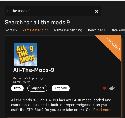

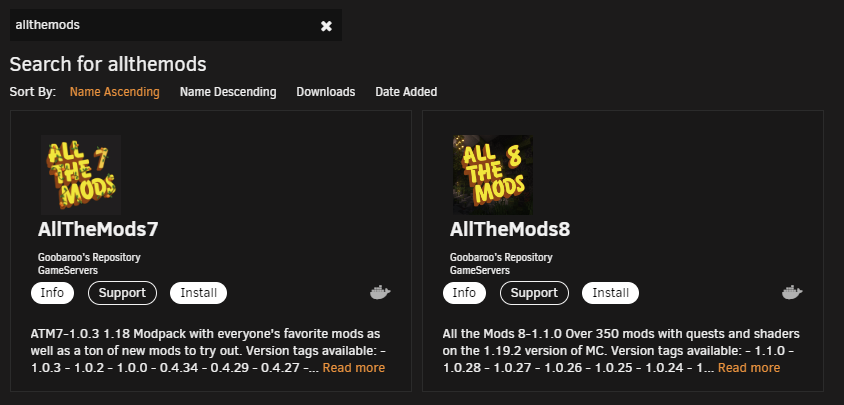

Hello, @Goobaroo
i miss the AlltheMods9 Server in App Store of Unraid.
I have it active Running, with about 6 Players on my Server...
What happend or will it come back with a bit of improvement?
Thanks in advance.
Kind Regards,
Mofa
@Mofarocker33 It's still on the store, it just has spaces in the name.  If you search by my name you'll see it too.

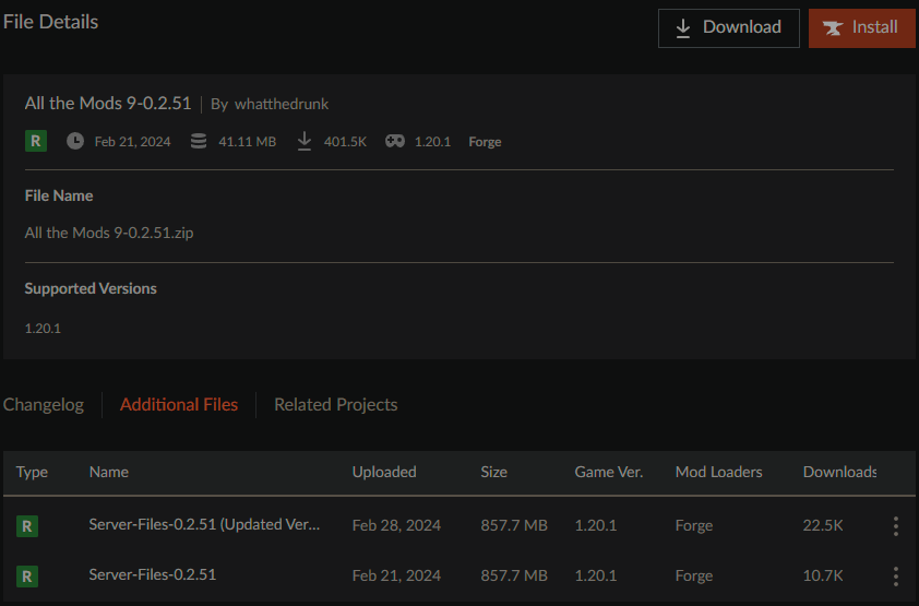

@Goobaroodo u have plans to update ATM9 to version 0.2.52 ?
@PaddyZockt 0.2.52 doesn't have a server release, it is client only.  The 0.2.51 server should be compatible with it.
Edited by Goobaroo
nope, when i try to connect it says mod mismatch and outdated mods
@PaddyZockt Hmm, there is not a server pack up for the 0.2.52 on curseforge, without one I can't publish one.  Maybe it will show up a bit later.
Hey @Goobarooi've asked it on their discord it should be imminent :
Can confirm the server pack is up now, wish I had seen this thread before I tried to manually update my server haha
All The Mods 9 0.2.52 should be up
