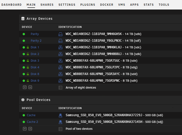

Currently, I'm sitting here:
P1 14TB
P2 14TB
D1 14TB
D2 14TB
D3 8TB
D4 8TB
D5 (removed)
D6 (removed)
D7 (removed)
D8 8TB
D9 8TB
I have 2x SAS9211 cards.
Card 1 has 2x SFF8087-4SATA cables. I can't look right now, but I believe:
1st cable has 4 drives (1 of which is parity)
1nd cable has 2 drives
Card 2 has 1x SFF8087-4SATA cable.
1st (only) cable has 1 drive (I think this is the other parity drive).
I know for a fact that I can trace my cables to drives, look at my serial numbers, and determine which 2 drives are the 2x 14TB (and which is #1 and which is #2).
I'd like to remove card 2 from the system. Hook up all 8 drives to card #1.
I think (someone tell me if I'm wrong?) it would be smart to have
1st cable - probably 1st drive parity, other 3 data drives
2nd cable - probably 1st drive parity, other 3 data drives
Is there a safe/easy way to do this? I understand I'll have to rebuild parity drive #2 from this thread: https://forums.unraid.net/topic/54221-reorder-disks/
Is it as simple as disconnecting everything, removing my 2nd card, attaching drives as I've indicated to the 8 slots that are left (in the order I choose), identify both the parity drives, and the other 6 as the data drives, and start array?

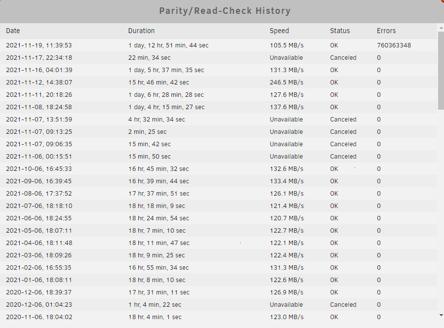

Also, when I 'cleared' the last 2 5TB drives, the script just stopped working - on both instances. (I ran and tried separately). I went ahead and removed the drives and changed configuration each time because I had already moved the data off each drive using unbalance.  I assumed it failed, and that my parity, even though it said valid wasn't valid.
After I got the 2nd one out, I ran another parity check to be sure. It just finished:
Last check completed on Fri 19 Nov 2021 11:39:53 AM EST (today)
Finding 760363348 errors Duration: 1 day, 12 hours, 51 minutes, 44 seconds. Average speed: 105.5 MB/se
I assume because I was right, I removed and it didn't finish/update parity along the way when I tried to clear. However, I do appear to still have same size used array, all my larger drives in place, and I just finished the parity check so it all should be good now.
Was that a correcting parity check?
Doesn't really matter since it is simpler to just go ahead and rebuild both parity when you New Config to close that gap.
Yes, I'm pretty sure, but have no way to know?
So, as long as I rearrange SAS cards, put drives back in the same order (1-2 parity in serial # order, 3-8 in serial # order) in new slots 1-8, I should be good?
Added screenshot of parity checks - this is the only time I've ever received errors on a parity check, so my assumption is they are 'correcting parity check' errors.
Edited by wildwolf
providing screenshot of parity checks
1 hour ago, wildwolf said:
no way to know?
If you manually run a parity check there is a checkbox you have to check to make it correct parity errors, so you should know whether or not you checked the box. All that history is showing is that it found a large number of sync errors and doesn't tell you whether or not they were corrected.
Post new diagnostics if you haven't rebooted and we can see from syslog whether or not it was correcting, but as I said
even though technically only parity2 would need rebuilding to close the gap (assuming parity1 is valid which is in doubt).
Yes, it was checked, so I assume it was correcting parity errors, and not some other type of errors.

This is where I'm confused then. I want to accomplish both. I want to physically rearrange the 8 disks that remain, by swapping cables & such around so they are all on 1 controller card, instead of 2. Plus, I also hope to "close the gap" in the GUI layout.
Or, will physically rearranging things (thus eliminating the 3 empty slots by eliminating all the extra slots from that 2nd card when it's removed and consolidating down to 1 card) automatically cause the drives to show up in all the right places, as long as I have parity  & parity 2 identified as the correct 2 drives? Are you/others stating I/anybody could (in my view below) move disk 9 to the cable connector that is disk 5 (different controller card), and it'd still boot up with all the data intact, without having to run new config or do anything else?
To change disk numbers in the Unraid array layout, you must use the new config function and build parity2 fresh.
To physically move drives between controllers requires no changes in the Unraid software, and the drives will stay in the same disk slots in the Unraid array layout. They will not change places in Unraid.
Physical location and disk number assignment are two totally separate concepts in Unraid, they do not interact. At all.
13 hours ago, JonathanM said:
Physically rearranging disks doesn't require any configuration changes or rebuilding of parity. Unraid tracks disks by serial number, it doesn't care which cable they connect to.
Rearranging logical slots in the management GUI is what you are referencing in the reorder disks thread.
Totally different and unrelated concepts in Unraid.
I think I finally understand. I can remove my other card, rearrange physical disks as I want. But my setup will still remain:
P1
P2
D1
D2
D3
D4
D8
D9
until I do new config, which will then require rebuilding new parity 2 to 'close the gap' in the GUI to:
P1
p2
D1
D2
D3
D4
D5
D6
Is that correct?

Thanks for all the help guys. Card removed, down to 1 card, 2 breakout cables, and all is looking a little better to me.
Now, off the wall question. My card (9211) has 2 connected cables with 2 drives connected each. Is there any benefit to having 1 parity drive on each connected breakout cable? Either performance or parity/data safety? Or no real world difference, just slap the drives where it's most convenient/easier to maintain/know where your drives are?
When I originally built, I put 1 parity per cable, thinking it might be safer. However, I now realize that may not be true and wanted to ask if it matters.
The system has 8 drives mounted vertically (Fractal Define R5), might be easier to know which drive is which if I put Parity at top, Parity 2 below that, Data 1 3rd, Data 2 4th, and on down the line. But is there any real detriment to doing that? Or would it be better to still separate parity drives per card's cable bundle?
Label each drive with the last 4 characters of the serial number. It is the serial numbers you need to depend on when trying to decide which disk is which, because that is how Unraid is going to decide which disk is assigned to which slot. Many drives already have serial number on a small label on the end of the drive opposite the connections.
They're already labeled by manufacturer (WD drives are awesome for this!). Just wondering if there's any protection or performance benefit to separate the parity 1 per cable, or if not, I'll just slap them into a slot to match what the new config to be - labeled top to bottom 2 parity and 6 data.
Might be some slight safety benefit to having parity on different connections.
Even though the webUI lists parity2 just below parity, internally Unraid refers to parity as disk0 and parity2 as disk29. So you could think of parity2 as the last array disk.
