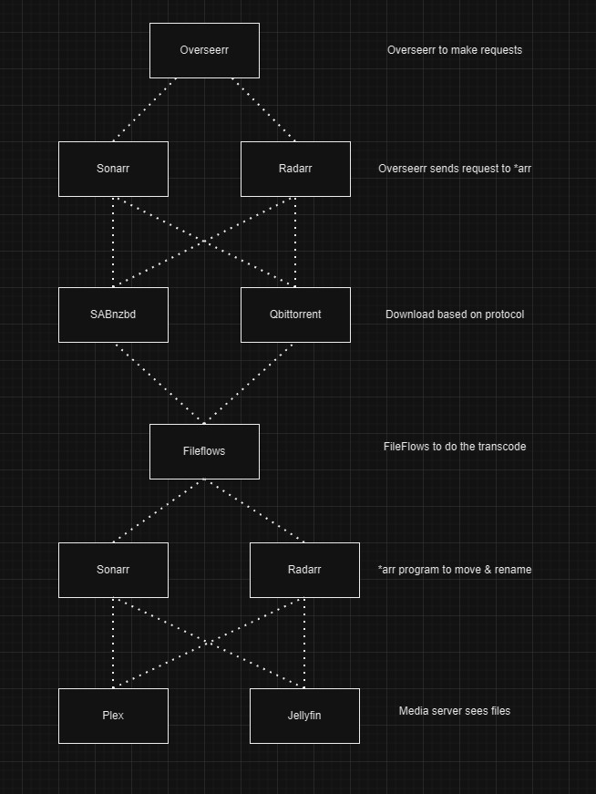

Afternoon, I would like to use fileflows in-between sabnzbd / qbittorent and sonarr / radarr.
I use overseerr to do my requesting plus some manual adding. Overseerr send the request to Sonarr / Radarr which then sends the command to download to Qbittorrent or Sabnzbd, when the downloads are finished I'd like fileflows to pick up the completed download do what it needs to do then place the file where Sonarr / Radarr can pick it up and rename, place in correct folder etc...
Is this possible?
