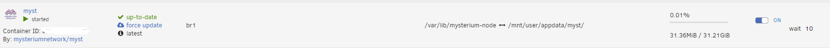

April 6, 20242 yr I've been having connection issues since moving to a br1 network. All the other containers seem to have IP addresses and port mappings in the Docker UI, but none show for Myst. I think this might be causing the node to go unreachable. Any idea on how to fix? I've added port mappings and static IP addresses when setting up, but it doesn't seem to work... Under docker allocations: Edited April 6, 20242 yr by 0weavern Added diagnostic image
April 6, 20242 yr i don't know, why you have connection issues, but IP's will only be showen when you have ports in your template (which are irrelevant, when using br0/eth0).
April 6, 20242 yr 3 hours ago, 0weavern said: I've been having connection issues since moving to a br1 network. All the other containers seem to have IP addresses and port mappings in the Docker UI, but none show for Myst. I think this might be causing the node to go unreachable. Any idea on how to fix? I've added port mappings and static IP addresses when setting up, but it doesn't seem to work... Under docker allocations: Do you have two nic's and, usually the first/main nic is br0. if you have two nic's, is the second nic configured and working?
