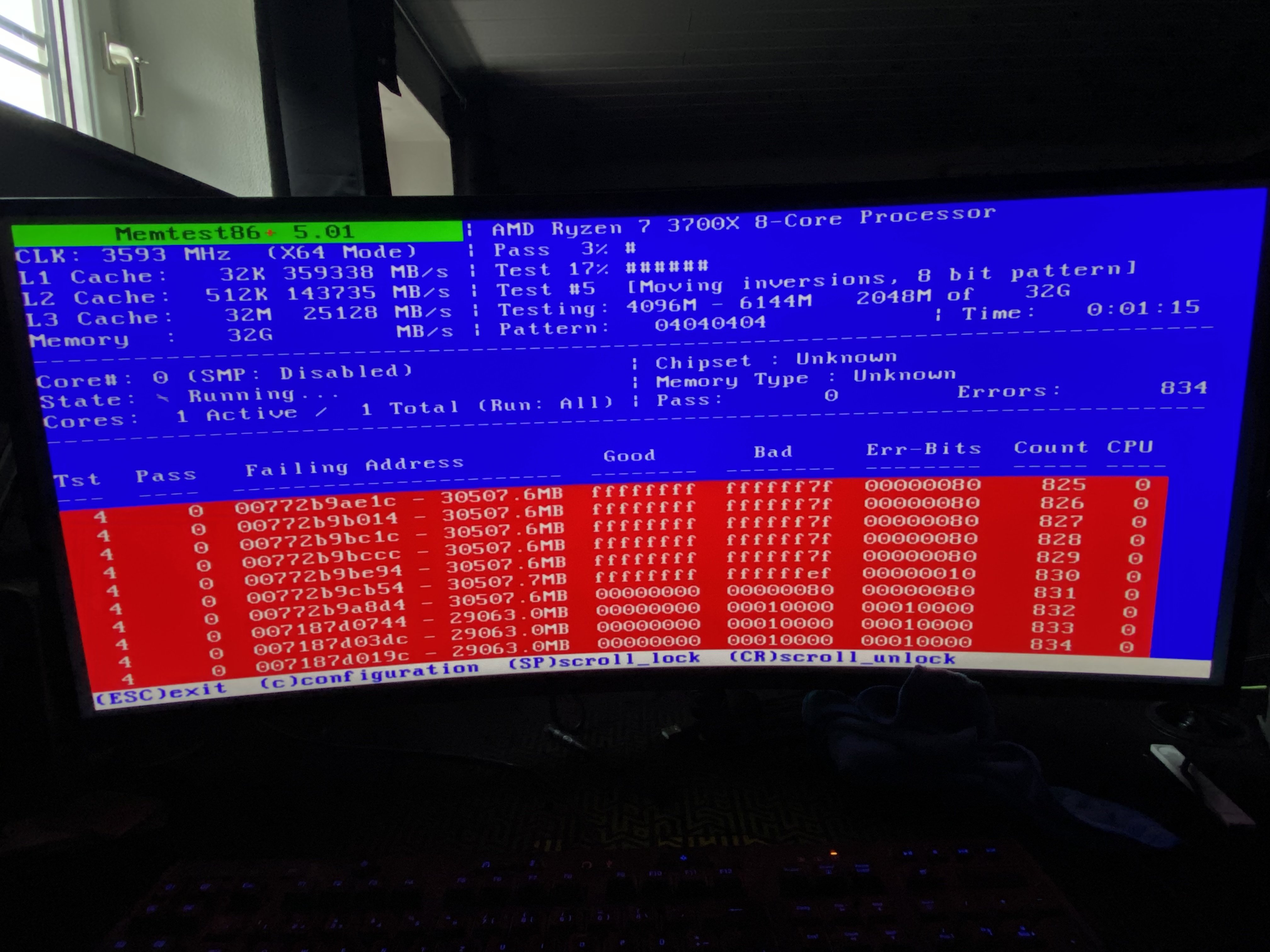

@JorgeB Thanks - I started it and it immediately looks horrible 🙈🥺 (see Screenshot)
 I’ll run the test to the end to see, what’s coming next.
But from this screen, I can’t see which RAM module is defect or did I?
And honestly I didn’t get it.
UnRAID runs smooth. VMs run smooth. Access to all files - even the one that showed up in the logfile - working. But copying the files from cache drive to the normal drives failed and the screenshot shows so many errors that (imho) the server shouldn’t even start.
May be you can say/teach me these „connections“ of logic - I can’t understand it. 🙈
Have some wonderful Christmas
 p.s I’ll upload a screenshot of the final as soon as the memtest is over
Not much point, you can run it with just one DIMM at a time to see if you can find the culprit.
Ahh - ok - so there will be no summary at the end that helps indicating. Thank you.
Is it possible that the XMP feature causes this errors? Because I activated XMP due to better speeds with my gaming VM.
XMP is basically overclocking, so you should avoid that, especially with Ryzen, but I checked before and RAM was @ 2133 MT/s, so XMP was disable.

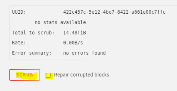

That's expected, data corruption resulting from running the server with bad RAM, you can run a scrub on the pool, it will list in the syslog all corrupt files, those files need to be deleted/restored from backups.
Thanks @JorgeB but how do I do that? I just found another thread where you replied but sadly you nor the thread-starter said how to do this?
Edited by Maddeen
On the main page click on the first pool member, then:
That did the trick. 6 Files were corrupt - luckily 5 within the krusader docker and one on the cache drive itself
Deleted - run another scrub - all fine.
Backup also worked fine.
Thank you very much @JorgeB
