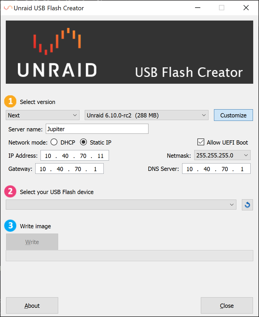

I did take a picture of the Unraid USB Creator configured for my USB drive:
