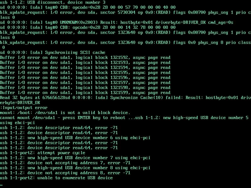

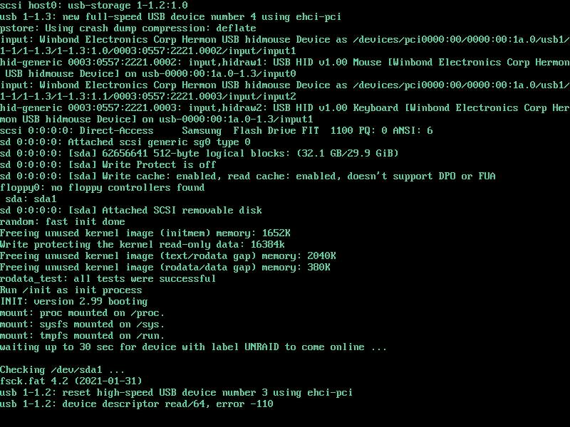

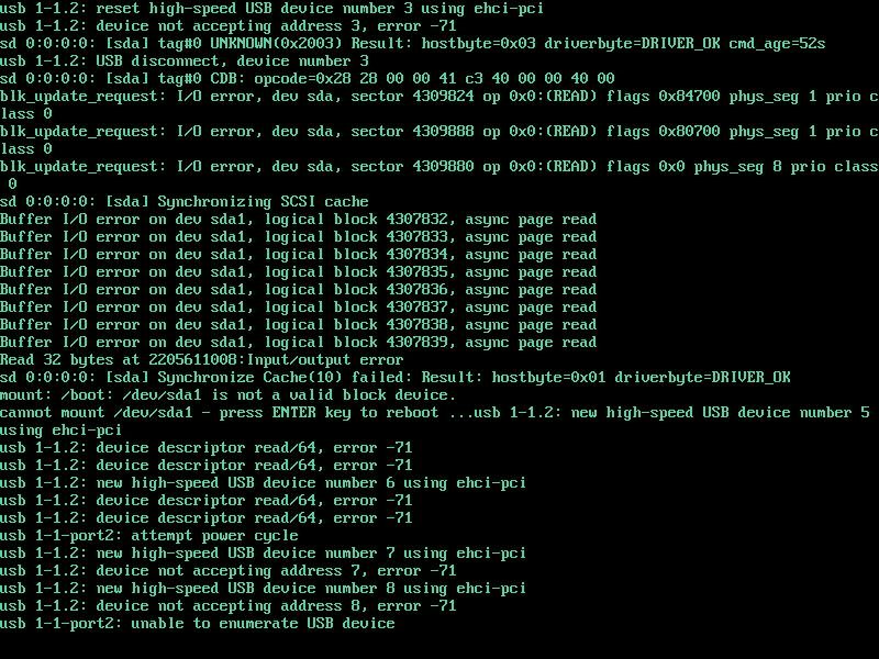

@JorgeB So I just power cycled my server with the option you gave me.  And Its hanging during boot.  with the attached USB error.  I'm going to power cycle the server again, but... Could this entire problem be the bootable USB is failing? @.@  Its a supposedly good Samsung Fit 32GB small form factor flash drive.  I'm going to reboot the server again and see if it comes up.  Though I might as well run memtest for giggles.

Yep, just got another reset.  With the same USB error upon attempting to boot again.
I'm going to run scandisk and such on the current USB.  In the mean time, anyone know what the read/64. error -71 is?

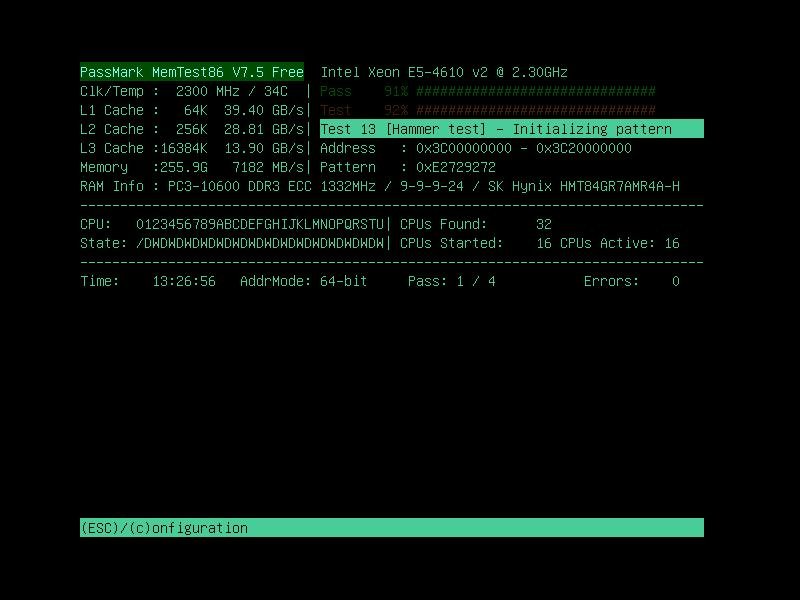

So I'm currently running Memtest, but its going to take a couple of days given my large ammount of Ram.  I'm at a loss as to what it could be at this point, unless its, as I've said in a prior post, a CPU, or Motherboard issue, which would be a big shame.  I'd be having to build a new server, which wouldn't be the End of the world, but meh.  Sigh.

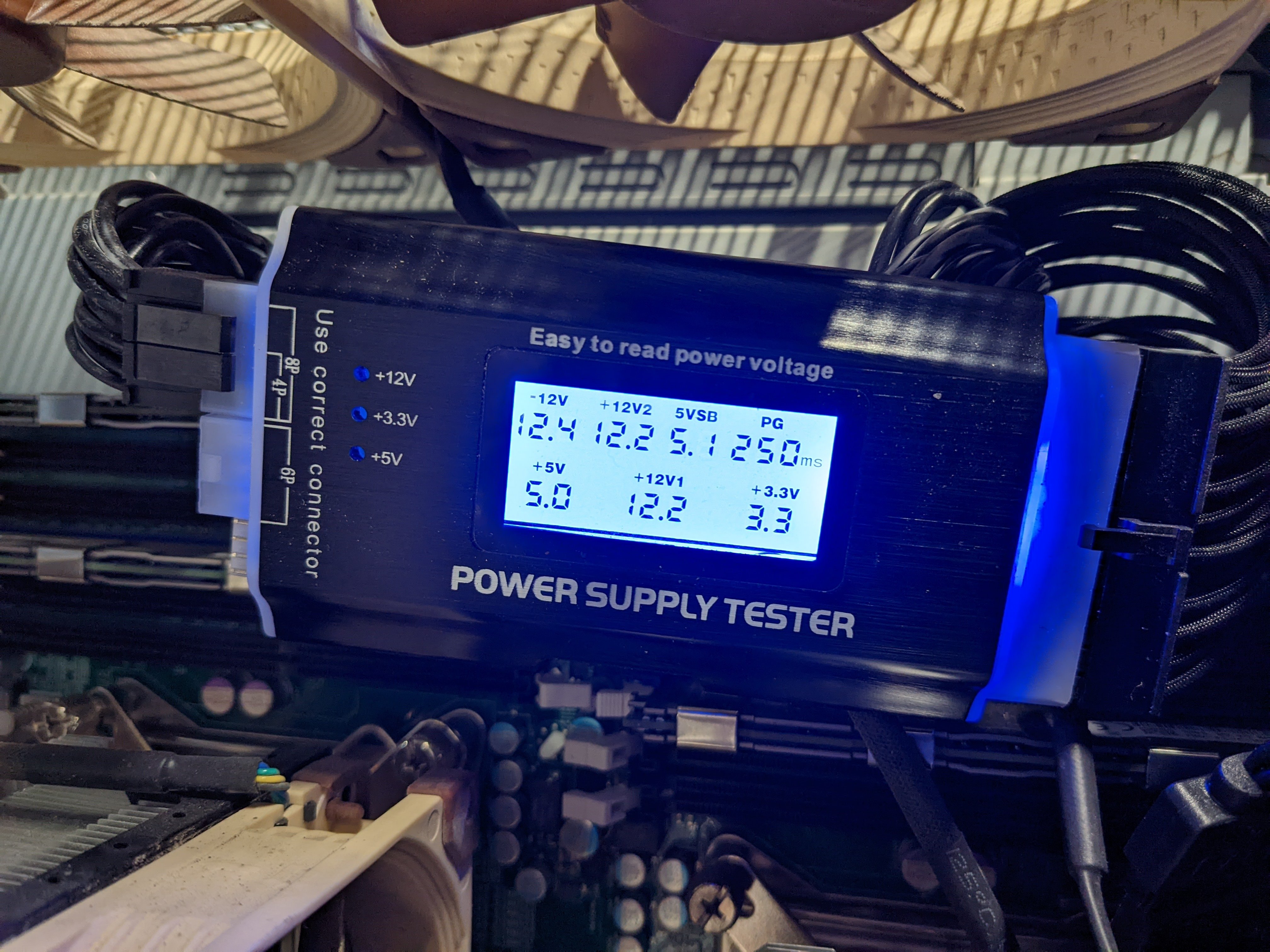

A fair idea, though I JUST replaced the PSU about 6 months ago with the overkill EVGA Supernova 1000 T2, 80+ Titanium.  I'll plug it into my PSU tester once the memtest is complete... Perhaps the power cabled need re-seating.  Ugh.  I reseated the PCIE cards about 50 times, but didn't think to re-seat the power cables.
Edited by nexusjosh
I let the RamTest get to step 2, then halted it.  No errors found.  Plugged the PSU into a PSU tester, and it tested out fine.  I've re-reated the power cables, so... we'll see if it power cycles.

4 minutes ago, nexusjosh said:
RamTest
Were you running the Memtest from Unraid's boot menu?  If so, it will not find any ECC issues (and most servers with ECC will completely halt the system if it runs into an uncorrectable ECC error).  Setup a new boot stick and download from https://www.memtest86.com/
On 3/4/2022 at 3:11 AM, nexusjosh said:
USB
These problems won't affect the "stability" of the server.  However based on your screenshots your flash is dropping offline and reconnecting.  Try a different port.  If it continues, then replace the flash drive and transfer your registration
Thanks for your feedback!  I did use a Memtest USB I had, not the one Unraid is coupled with.  The one coupled with Unraid actually wouldn't boot for whatever reason.
