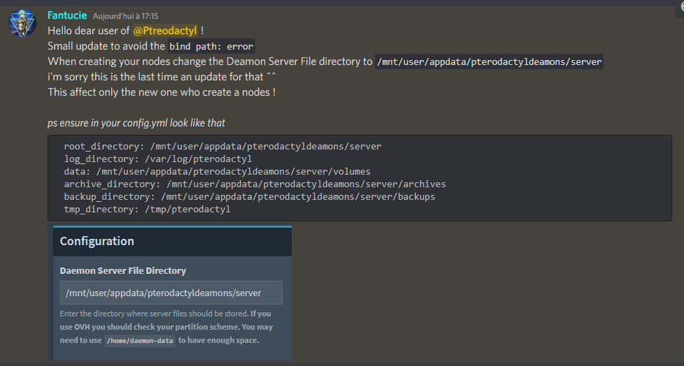

  data: /var/lib/pterodactyl/volumes isn't goooddd go read the install tuto that i made page 1
! PREVENTING MESSAGE !

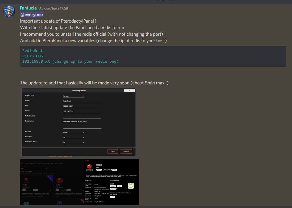

In this night PterodactylPanel got an update if your panel is in error 500 that actually normal !
You need to have a Redis Docker on your server now !
The update of the patern for unraid has been make RN so wait a few hours to got the update and make everything work again !
If you dont wanna wait and do it yourself
EDIT:
I have setup a version selector, who will let you choose between Latest or version v1.7.0 who is the before this update !
Edited by Fantucie
Check edit

Otherwise has said on my Wiki ! On docker mount for the deamons need to be 1:1 !
Meaning if your mount on unraid is /mnt/user/appdata/mount on docker, it need be the same, same has inside your config !
