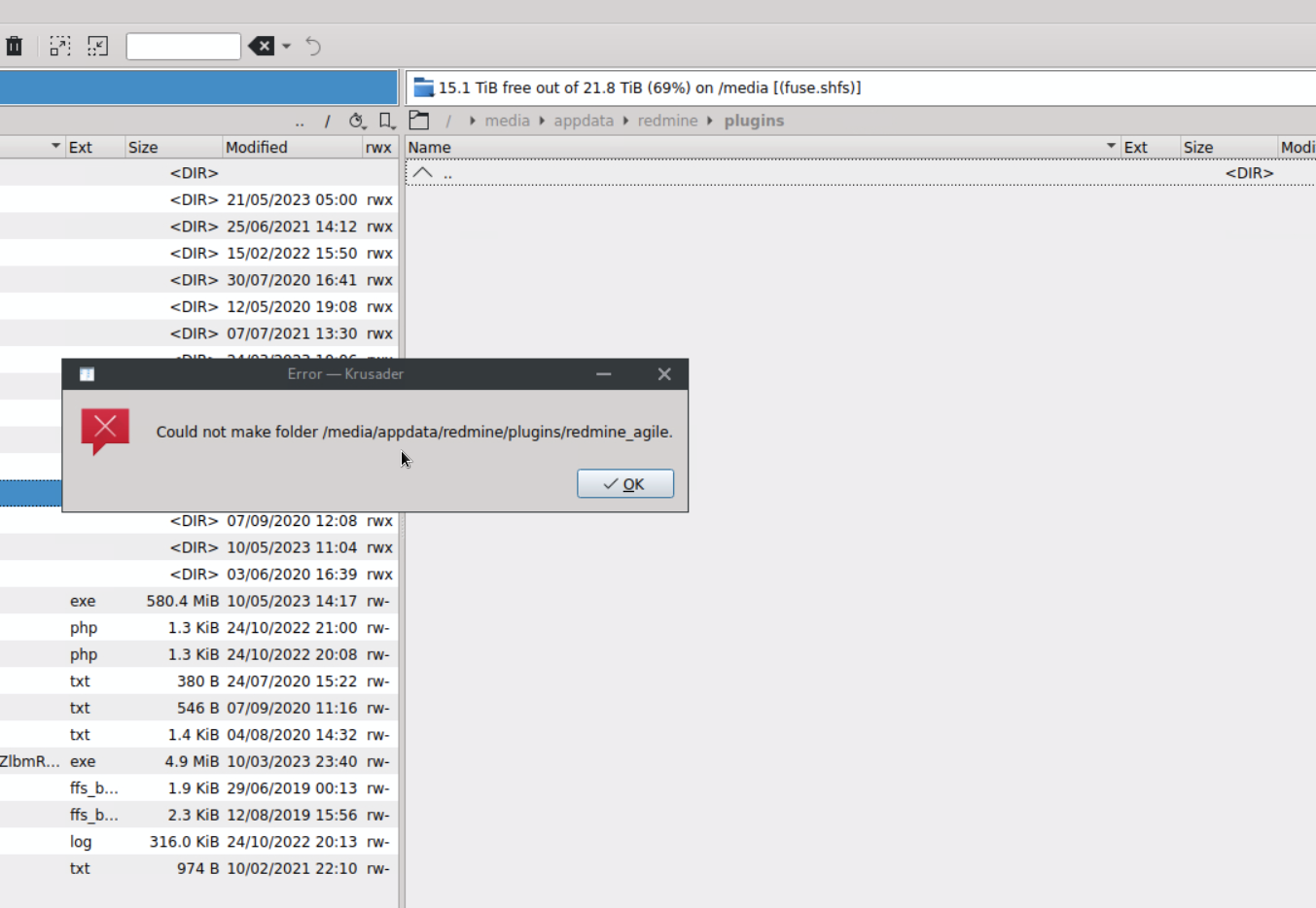

Hi, For some reason I cannot copy folders or files to the plugins directory :(

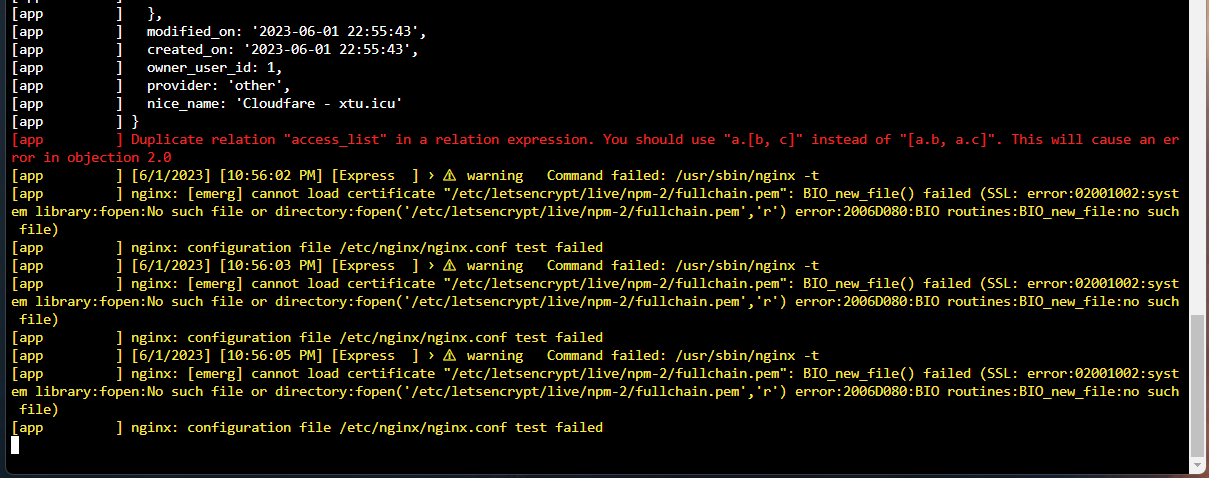

I'm having numerous issues with this container.
The above logs pertain to me using my own cert given to me by Cloudfare.
I am not sure if it's a problem getting an error that it cannot delete those files.
Now onto the real issue. The one which is completely breaking my NginxProxyManager container. Remember this is a fresh installation.
I am trying to add this custom cert to NPM. I've done that successfully. You can see here in the logs:
[app         ] [6/1/2023] [10:55:43 PM] [SSL      ] › ℹ  info      Writing Custom Certificate: {
[app         ]   id: 3,

[app         ] Duplicate relation "access_list" in a relation expression. You should use "a.[b, c]" instead of "[a.b, a.c]". This will cause an error in objection 2.0
[app         ] [6/1/2023] [10:56:02 PM] [Express  ] › ⚠  warning   Command failed: /usr/sbin/nginx -t
[app         ] nginx: [emerg] cannot load certificate "/etc/letsencrypt/live/npm-2/fullchain.pem": BIO_new_file() failed (SSL: error:02001002:system library:fopen:No such file or directory:fopen('/etc/letsencrypt/live/npm-2/fullchain.pem','r') error:2006D080:BIO routines:BIO_new_file:no such file)
[app         ] nginx: configuration file /etc/nginx/nginx.conf test failed
[app         ] [6/1/2023] [10:56:03 PM] [Express  ] › ⚠  warning   Command failed: /usr/sbin/nginx -t
[app         ] [6/1/2023] [10:56:05 PM] [Express  ] › ⚠  warning   Command failed: /usr/sbin/nginx -t
You can see the errors here in color:
This causes my entire container to crash continuously. This happens specifically when I go to a site on my list in NPM and select to use the custom cert I just added.
I instead get those errors and this in the GUI: (excuse the blown out HDR screenshot)
I have no idea what is causing this at all...
Container is using just the normal settings... it seems the problem is that the certs are not being written to:
but I have no idea why... that's just my normal \\TOWER\appdata\NginxProxyManager-CrowdSec\letsencrypt folder... except for some reason it's completely empty???
This problem will allow me to start the container but it won't do anything and will just spam the logs with the errors in yellow.
Change the folder permission to 777 it's should fix your issue :)

hi there i have a problem wirth the crowdsexnpm Container the nginx bouncer dose not conect to crowdsec after following your guid any idears
NginxProxyManager-CrowdSec: I am having problems renewing the SSL certs. It always says "Internal Error".
I read your Wiki: "When creating SSL, using the button "Use a DNS challenge" does not work ..." But I am not using this button.
Port 80 and 443 are also forwarded correctly. Back in August I was able to create the certificates. Now, renewing or creation always fails.
Hello sorry for the very late answer, I've been quite busy irl, I would like to see your log on container side when this error appear to see what concretly is the error if you still have it, feel free to join the discord there is more poeple to help and less latency for answer, I sadly don't have full time to check up here always unless than on discord ^^'
