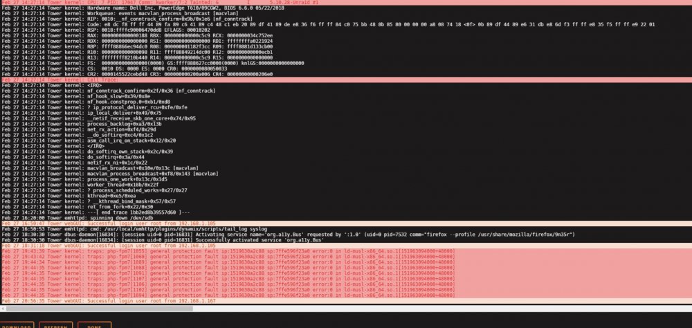

I have been watching server and came across this though— see attached pic and error below:
Feb 27 19:44:35 Tower kernel: traps: php-fpm7[1107] general protection fault ip:1519630a2c88 sp:7ffe596f23a0 error:0 in ld-musl-x86_64.so.1[151963094000+48000]
Could this have anything to do with my crashes lately? I was able to find one thread in forum with similar error but seems was radarr specific.

Macvlan call traces are usually the result of having dockers with a custom IP address, upgrading to v6.10 and switching to ipvlan might fix it (Settings -> Docker Settings -> Docker custom network type -> ipvlan (advanced view must be enable, top right)), or see below for more info.

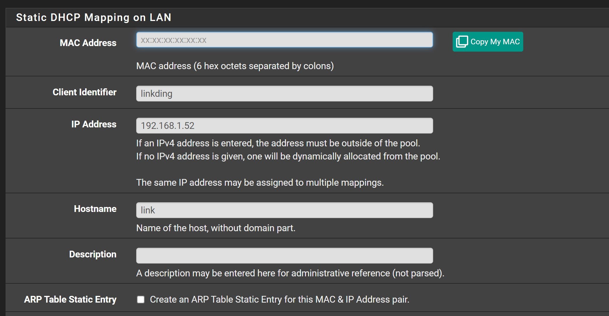

I used to have everything with STATIC IP in pfSense. When I converted to IPVLAN stuff was all borked. In DHCP Server>One of the listings for something on IPVLAN had to UNCHECK "Create an ARP Table Static Entry for this MAC & IP Address pair" AND remove the MAC ADDRESS for the items setup with IPVLAN. You can keep static entry; just have to uncheck THAT specific box.
Here is a example for something I have a static IP on:
Hopefully this makes some sense. 🙂
