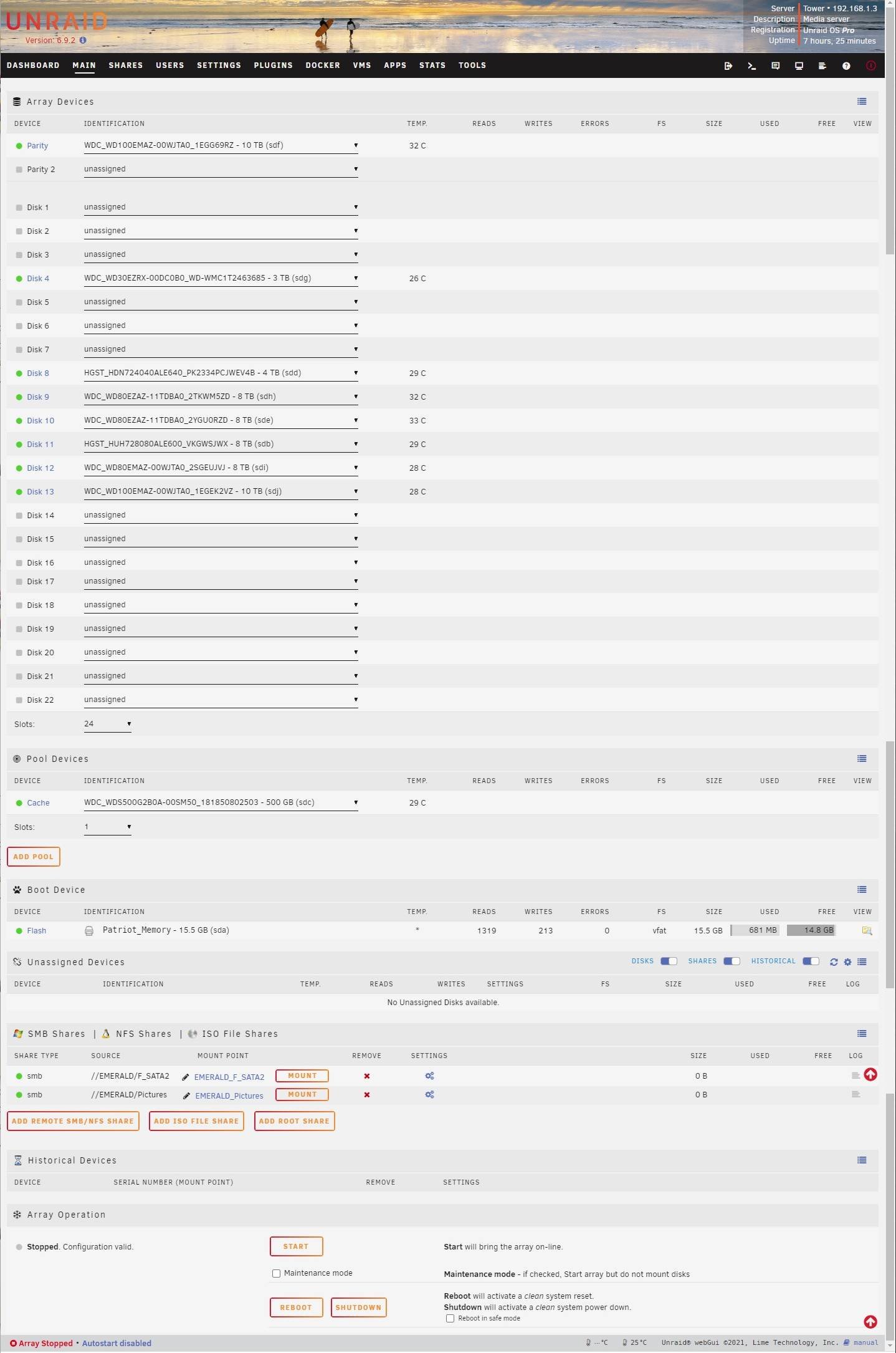

Here's a screen shot of main now (after shutdown, re-attaching the disk and booting).
3 hours ago, CaptainTivo said:
So, parity should be good and can just start the array now, right?
Yes, only if the array was started with a missing disk a rebuild would be required, you can also see that by looking a the disk status, all are green.
