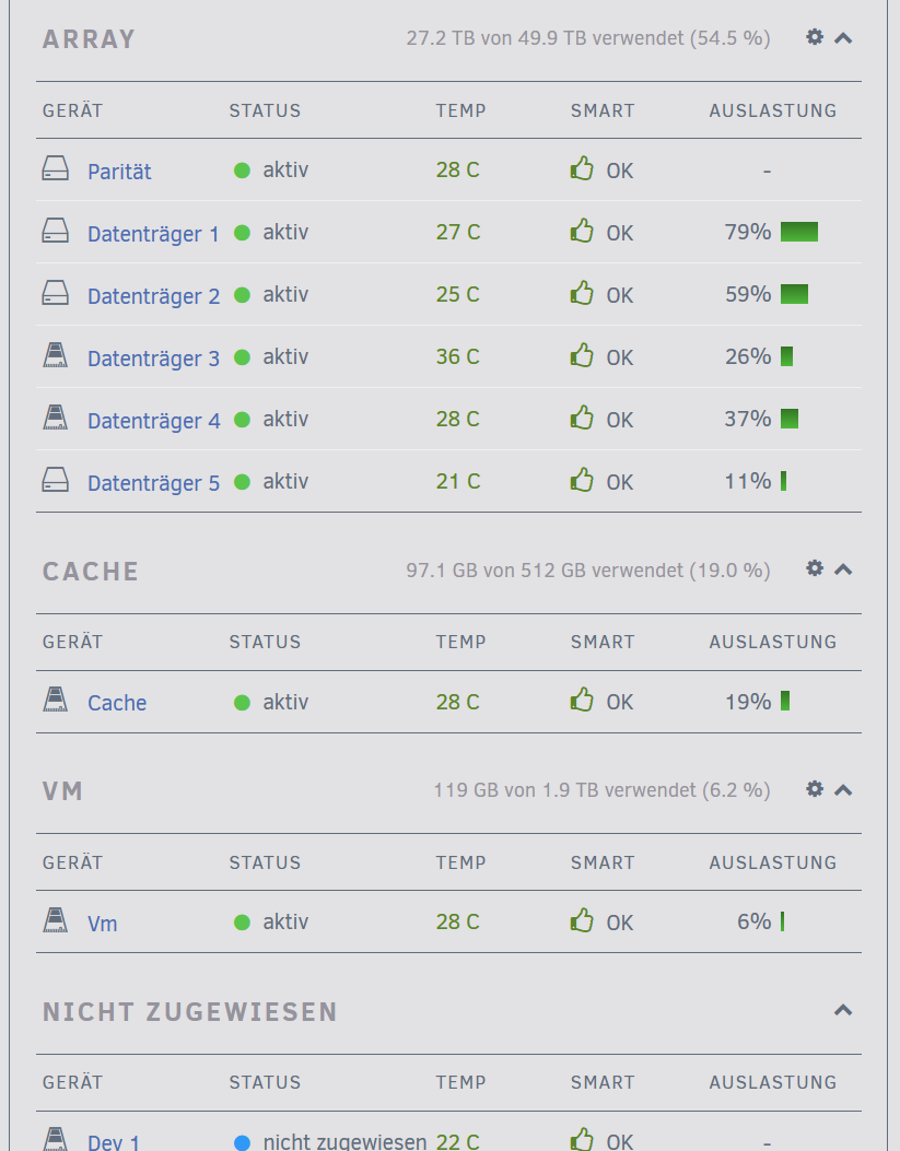

And the big one: 3 of my 6 month old drives are showing SMART errors (reallocated sector counts) and the temps even with excellent airflow right across them have 4 at 45-47C and the other two at 39C steady. They're rebranded Seagate Constellation drives (2 are Exos drives) and as I understand it the Constellation ones run a bit hot.
yeah, sounds not too healthy in the long run. But you need to look into the specs of your drives for the suggested operational temperature. You can then adjust the warning/error levels within UNRAID. For instance, my NVmes never go below 40°, but they are allowed up to 90°. So without adjustments, they would always signal "too hot".
Also, it helps to find out which drives becomes hotter than the others and then rearrange the drives in the cages in the way that a hot drive is surrounded by cool drives. Many hot drives tightly together will give additional heat pain to their neighbors.
I only have 6 drives spread within 16cages currently, so there is plenty of free slots between them
like
Why are yours so hot even being off-line???
But I would be more concerned about the reallocated blocks. Keep an tight eye on them, if they rise and rise, something is utterly wrong and the drive will fail soon.

@Michael: Those temps are from a few hours into a preclear so they were pretty active for a while when I took that screenshot. They're still holding steady at 45-46 55% through the zeroing part. Higher than I'd like them but from what I've read pretty normal for those particular drives. Interesting that both of the cooler-running drives, the Exos ones both show reallocation errors. Turning into more of a project than I'd hoped but I'll keep plugging...

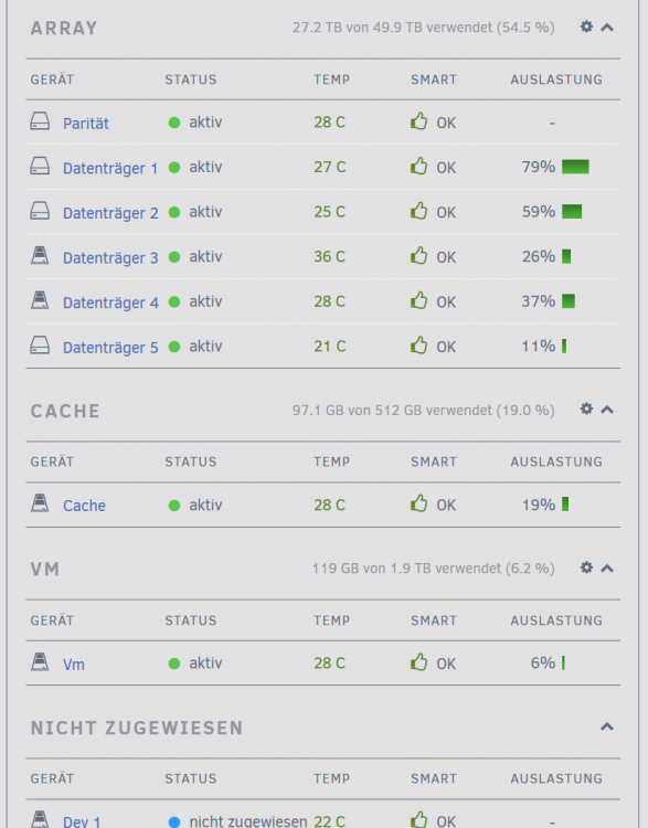

7 hours ago, Michael Meiszl said:
Not really surprising if you look at the stats. The "2" device is the older one, it uses 8 lanes PCIe 2.0.
You got that backwards.  The "2" is the newer version and supports 6G whereas the original only supports 3G
yes and no 😁
Depends on what you are looking for. If you go for drive speed, you are right, if you go for bus speed and version, I am correct. But I guess, there are also 6G Versions with 4 lanes 3.0 out there in the wild...
Anyway, he won't need any of them.
