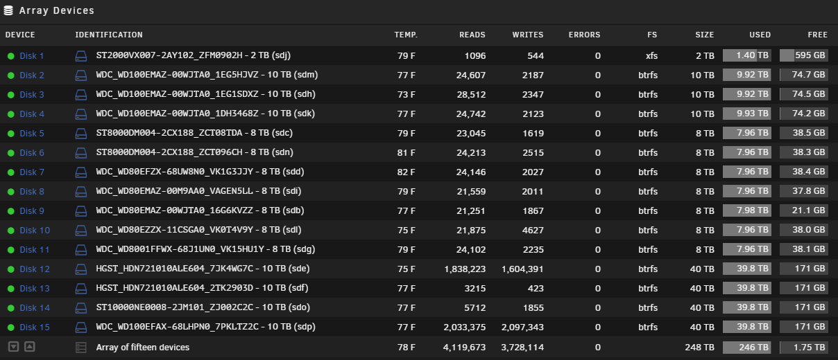

Removed Drives From a disk pool and add to an array - I messed up, how do I fix this?
This is my chia server, I had the last four drives in a disk pool on another server. I yanked them out and stuffed them into my cable spaghetti server.
Obviously, I didn't think through the single drive mode and didn't change the metadata parity settings.
Obviously it's just chia plots, but I'd rather not blow them away as it costs money to replot.
That's a new one to me. Maybe @JorgeB will have some ideas.
Since you don't have a parity drive, I'm thinking you can just do a new config and leave out 12 - 15, then add them to a pool so at least you will get back to a "normal" config and go from there. Whether you can split the 4 drive pool without moving data around, I don't think so, but like I said maybe JorgeB will have some options.
That was my initial urge to do, but I'm holding off on the off chance someone has advice on this.

This happened to me before, and it can happen with parity, usually easily fixable, just no clear why a balance is running, if it started automatically post the diagnostics to see why.
I patched to rc6, last night while drunk. So no logs.
Question though, is there a way to convert the meta data to single drive mode and remove the mirror?
Yes, if they are in a pool now:
btrfs balance start -f -mconvert=single /mnt/pool_name
