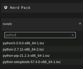

A3.  Install nerdpack plugin, which allows you to install packages through the GUI, with User Scripts plugin being a nice frontend for running scripts on a schedule.
Alternatively you could look at running the scripts through a python based docker.
VM is also possible, normally you would just create a vdisk for it to run on, but passing a whole disk is also possible.
