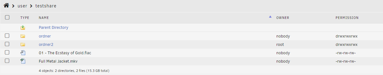

These are the permissions on Films and TV Shows, in all files (drwxrwxrwx)
Edited by dellorianes

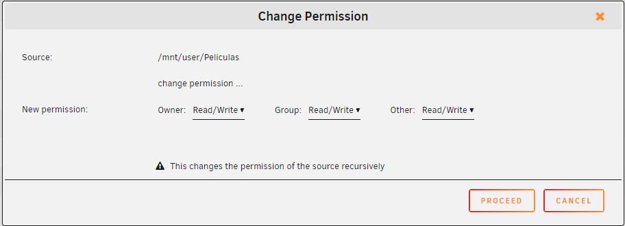

I myself ended up running "New Permissions", as the current ones didn't work after upgrade on many shares.
I did and no changes.
