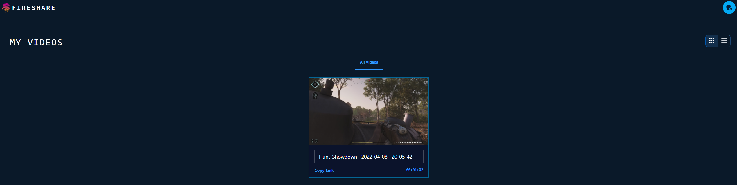

Shane Israel Posted May 26, 2022 Share Posted May 26, 2022 (edited) Fireshare is an application that allows you to share your your media to anyone via publicly accessible share links. _________________________________________________________________ Have game clips you want to share to friends but don't want to deal with uploading them to YouTube or maybe they are too large to send in Discord? Simply add your game clips to a directory mounted to Fireshare and they will automatically have share links created for them. Application Name: Fireshare Docker Hub: https://hub.docker.com/r/shaneisrael/fireshare Github: https://github.com/ShaneIsrael/fireshare Please post any questions / issues relating to this docker you have in this thread. If you are not using Unraid, then please do not post here, rather report the issue on the Github project page. Edited May 26, 2022 by Shane Israel grammar Quote Link to comment

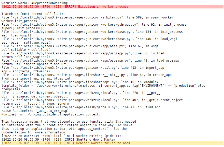

Reziem Posted May 26, 2022 Share Posted May 26, 2022 (edited) I've been looking for somthing like this for a while! I am currently having an issue though getting it to work on my Unraid server via the Docker image. I'd like to change the port from 80 to somthing else. It appears the default port can't be changed? Below is a screenshot of the error I am receiving when I spin up the container. I also get this same error when I change nothing in the container settings. Let me know if you need more info. Edited May 26, 2022 by Reziem Quote Link to comment
Shane Israel Posted May 26, 2022 Author Share Posted May 26, 2022 1 hour ago, Reziem said: I've been looking for somthing like this for a while! I am currently having an issue though getting it to work on my Unraid server via the Docker image. I'd like to change the port from 80 to somthing else. It appears the default port can't be changed? Below is a screenshot of the error I am receiving when I spin up the container. I also get this same error when I change nothing in the container settings. Let me know if you need more info. The port within the container can not be changed from 80 at the moment. But you should be able to map any port to that 80. By default it should be mapping port 8080 -> 80. Let me double check that the default settings are still correct for Unraid and work, I may have fudged something in the xml. Quote Link to comment
Reziem Posted May 26, 2022 Share Posted May 26, 2022 (edited) 37 minutes ago, Shane Israel said: The port within the container can not be changed from 80 at the moment. But you should be able to map any port to that 80. By default it should be mapping port 8080 -> 80. Let me double check that the default settings are still correct for Unraid and work, I may have fudged something in the xml. No worries, I tried deleting the container, starting over, changing none of the settings and I still receive the same error. I am little new to Unraid and I am a bit confused with the message that pops up when installling regarding that it uses a custom network. I've used / created custom networks before but this container defaults to "none" which I've never really seen before. Could you explain that a bit? Maybe that is what I am doing wrong. Edited May 26, 2022 by Reziem Quote Link to comment

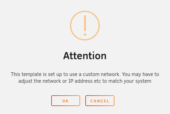

Shane Israel Posted May 26, 2022 Author Share Posted May 26, 2022 @Reziem Okay so looks like there was a bug (which I thought was working but apparently not) so I reverted that change for now. Update the container and also set the Network mode to "Bridge" or whatever your custom network setup is. Its being set to "None" by default which is wrong and I pushed a fix for that too. Then you should be able to change the 8080 port to whatever you want and start the container. Also, please note the application doesn't yet have the ability to automatically scan your media folder (I'm working on this feature now) so until that feature is ready you'll have to initiate a manual scan by clicking the "Scan" button which is located under the Admin avatar image at the top right of the app when logged in. Just click that button, wait like 30 seconds and refresh your page and you should see your videos. Quote Link to comment
Shane Israel Posted May 26, 2022 Author Share Posted May 26, 2022 You'll have to open the "advanced view" and then you will see the "force update" button. Press that, then edit the container settings and choose a different port from 8080 to one that isn't being used by one of your other containers. A lot of stuff uses 8080 as the default. Then start the container. Quote Link to comment
Reziem Posted May 26, 2022 Share Posted May 26, 2022 1 hour ago, Shane Israel said: @Reziem Okay so looks like there was a bug (which I thought was working but apparently not) so I reverted that change for now. Update the container and also set the Network mode to "Bridge" or whatever your custom network setup is. Its being set to "None" by default which is wrong and I pushed a fix for that too. Then you should be able to change the 8080 port to whatever you want and start the container. Also, please note the application doesn't yet have the ability to automatically scan your media folder (I'm working on this feature now) so until that feature is ready you'll have to initiate a manual scan by clicking the "Scan" button which is located under the Admin avatar image at the top right of the app when logged in. Just click that button, wait like 30 seconds and refresh your page and you should see your videos. 1 hour ago, Shane Israel said: You'll have to open the "advanced view" and then you will see the "force update" button. Press that, then edit the container settings and choose a different port from 8080 to one that isn't being used by one of your other containers. A lot of stuff uses 8080 as the default. Then start the container. Thank you very much! All is working now! Quote Link to comment
Shane Israel Posted May 26, 2022 Author Share Posted May 26, 2022 1 hour ago, Reziem said: Thank you very much! All is working now! Awesome! Quote Link to comment

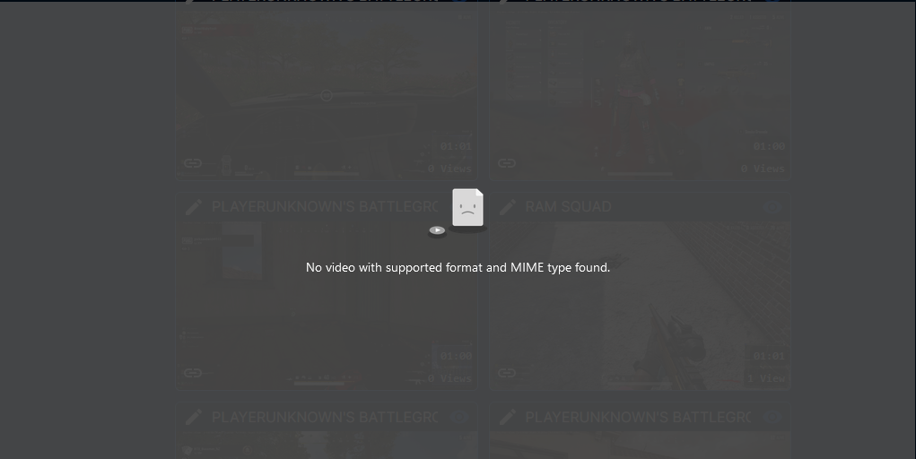

Neldonado Posted October 29, 2022 Share Posted October 29, 2022 Started running into this issue where all my videos show this error when I go to play them. The directory is correct and all the files are here in MP4 Format, so I am not sure what's going on. Any suggestions? Quote Link to comment
Shane Israel Posted October 29, 2022 Author Share Posted October 29, 2022 (edited) 7 minutes ago, Neldonado said: Started running into this issue where all my videos show this error when I go to play them. The directory is correct and all the files are here in MP4 Format, so I am not sure what's going on. Any suggestions? If the files were encoded in h265 you'll see this issue. Most browsers do not support h265 playback. If your are certain that is not the issue you can stop Fireshare and delete your Fireshare database then start Fireshare again. After the initial video scan completes see if the videos play. Edited October 29, 2022 by Shane Israel Quote Link to comment
Neldonado Posted October 29, 2022 Share Posted October 29, 2022 47 minutes ago, Shane Israel said: If the files were encoded in h265 you'll see this issue. Most browsers do not support h265 playback. If your are certain that is not the issue you can stop Fireshare and delete your Fireshare database then start Fireshare again. After the initial video scan completes see if the videos play. I might give this a shot. Recent videos work but my older ones stopped, and I recently had to restore my appdata so maybe that messed something up? Quote Link to comment
Neldonado Posted October 30, 2022 Share Posted October 30, 2022 (edited) 9 hours ago, Shane Israel said: If the files were encoded in h265 you'll see this issue. Most browsers do not support h265 playback. If your are certain that is not the issue you can stop Fireshare and delete your Fireshare database then start Fireshare again. After the initial video scan completes see if the videos play. So I went and deleted the DB, did another scan, and videos older than a specific date wont play. Some of these are videos that I had shared links to, so I know they worked at one point, and they are all created and stored in the same folder by Geforce experience. I can play all of the files straight from the folder, but on fireshare only newer videos will play. Any suggestions besides a full delete/ reinstall? I'd hate to lose all my links I've shared. I should note I can go back a week, which is when I had to restore my appdata. Maybe something got messed up with that? Would the fireshare process folder be not lined up with my db? Edited October 30, 2022 by Neldonado Quote Link to comment
Shane Israel Posted October 30, 2022 Author Share Posted October 30, 2022 @Neldonado I would do a reinstall of Fireshare completely then if the issue aligns back to when you had appdata issues. Delete both the data and processed folders. When you reinstall Fireshare your old links will still work so long as you do not edit the video files. You can rename the files or even move them to a different subfolder. Fireshare generates links based off the hash data of the file which will always be the same unless the file is changed. So you don't have to worry about your old links no longer working. Quote Link to comment
Neldonado Posted October 30, 2022 Share Posted October 30, 2022 19 hours ago, Shane Israel said: @Neldonado I would do a reinstall of Fireshare completely then if the issue aligns back to when you had appdata issues. Delete both the data and processed folders. When you reinstall Fireshare your old links will still work so long as you do not edit the video files. You can rename the files or even move them to a different subfolder. Fireshare generates links based off the hash data of the file which will always be the same unless the file is changed. So you don't have to worry about your old links no longer working. I reinstalled it and deleted all the files, it worked 100% for 3-4 hours and now some of my most recent clips are not working. It seems inconsistent with the ones I get errors with and the one's I don't. Only thing I can think is that I am using a cache with the video share.. would that affect anything? Quote Link to comment
