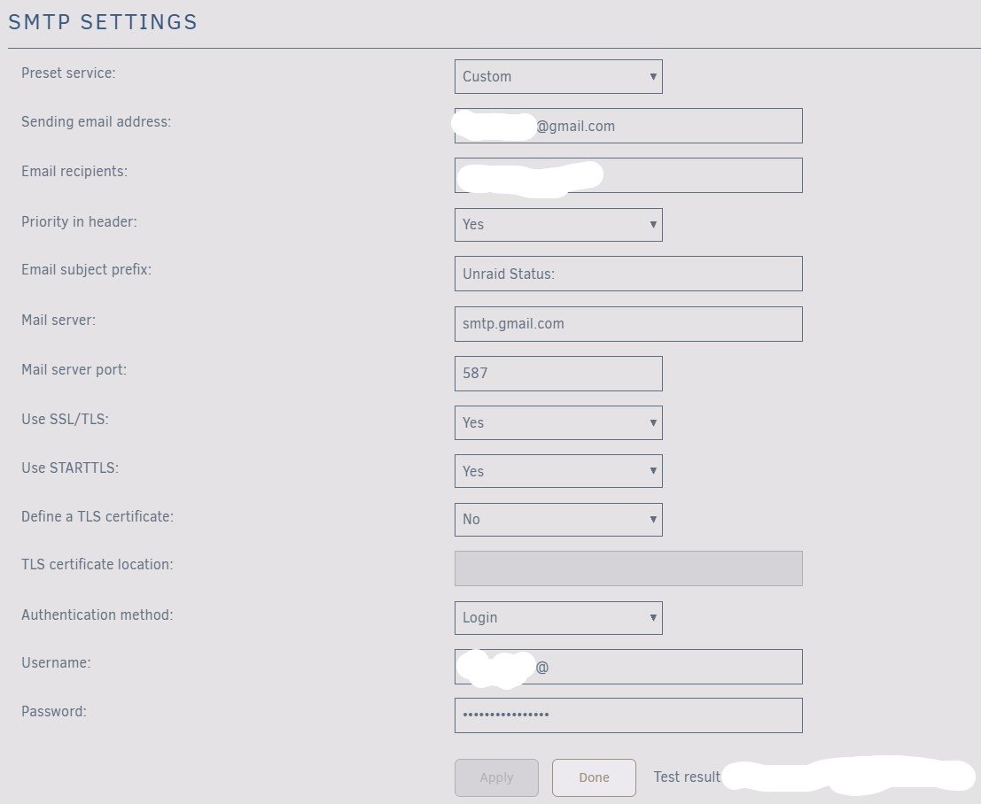

Okay I managed to fix it while typing but I'm still gonna upload for anyone having the same problem.
I tried both having username set as [email protected] and myname
But apparently it has to be myname@
This wasn't previously like that and it honestly is very weird but yeah it's google
Final settings ended being up like this:
the img for anyone blind states
Preset: Custom
Sending email address: [email protected]
Mail server: smtp.gmail.com
Mail server port: 587
Use SSL/TLS: yes
Use STARTTLS: yes
Define a TLS certificate: No
Authentication method: Login
Username: yourname@

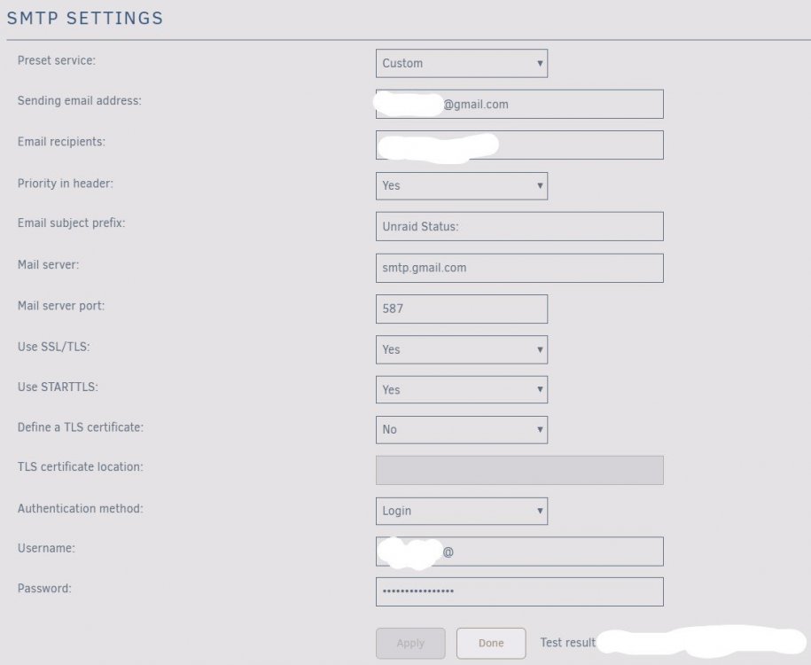

Interesting, I tried changing my username to just user@, but still fails for me now using an app password.
Edit: Nevermind, google just deleted the app password I had setup, created a new one and it works.
