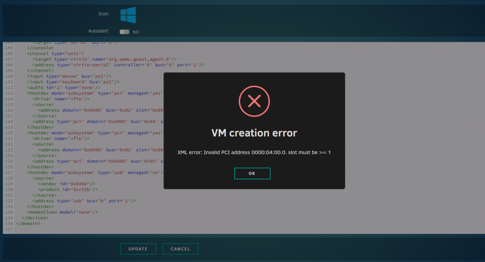

43 minutes ago, song said:
installed the graphics card driver on the graphics card gtx650ti, and the device manager reported an error "-43".
First make sure you are installing the latest drivers and not older ones.

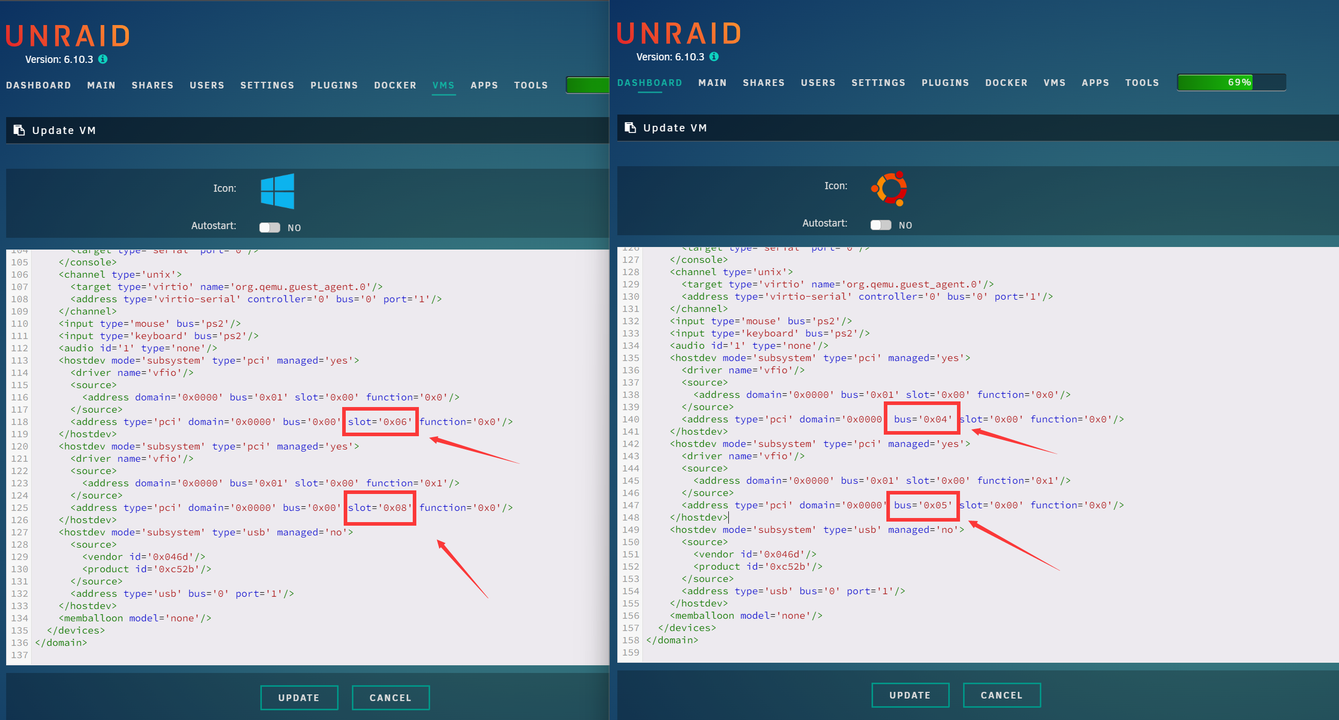

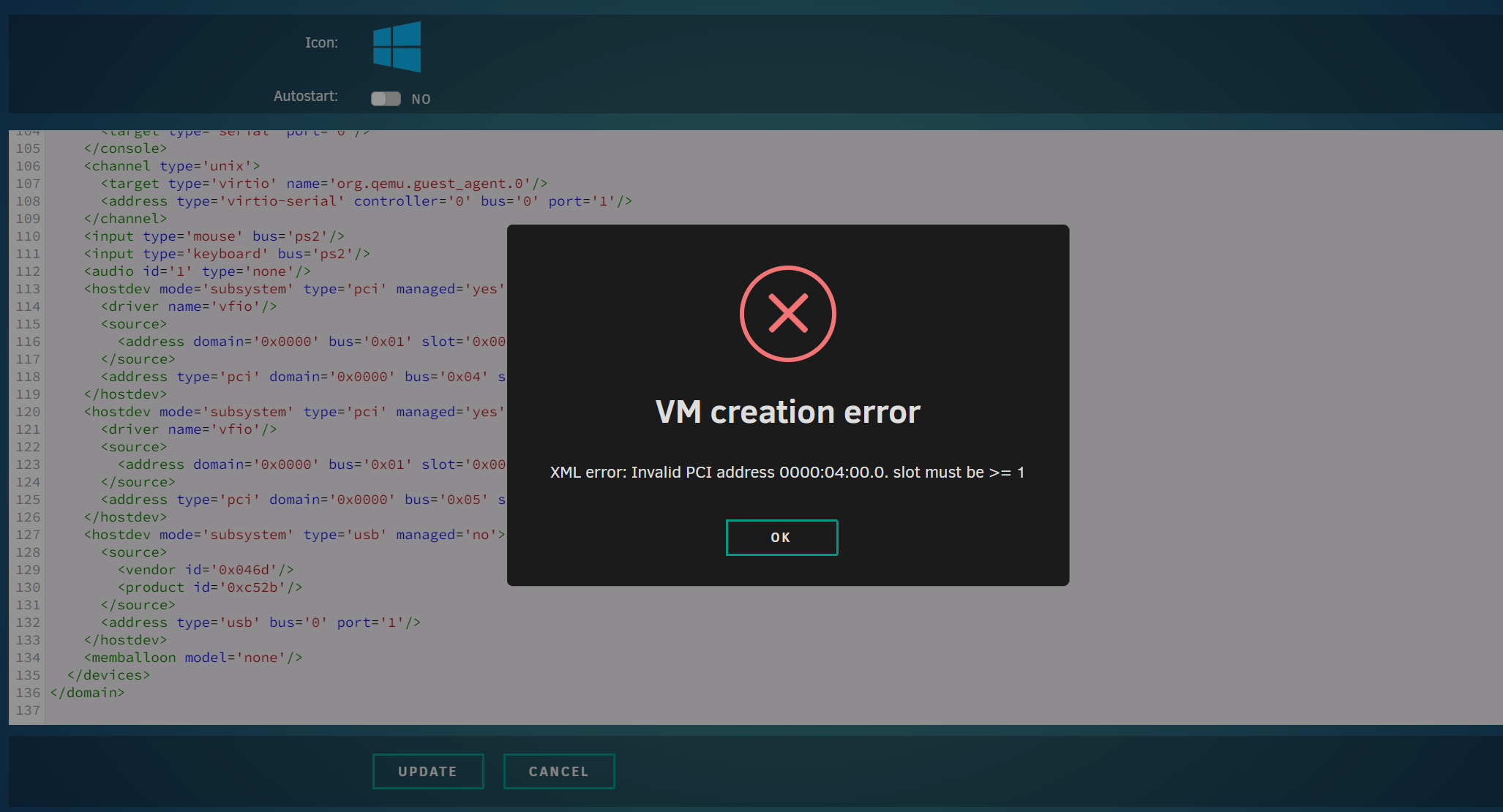

Main difference between the linux and windows vms is that the linux one is a q35 type, the windows one is i440fx.
i440fx has only bus 0, q35 has bus 0 and also pcie-root-ports to create bus 1, 2, 3 etc.
This is why you have that error, you cannot use a bus number greater than 0 in a i440fx machine.
In both vms the gpu is not set as multifunction, but if it works...however the preferred way is to set it as a multifunction device in the vm.
Better to attach diagnostics because your pictures say nothing.

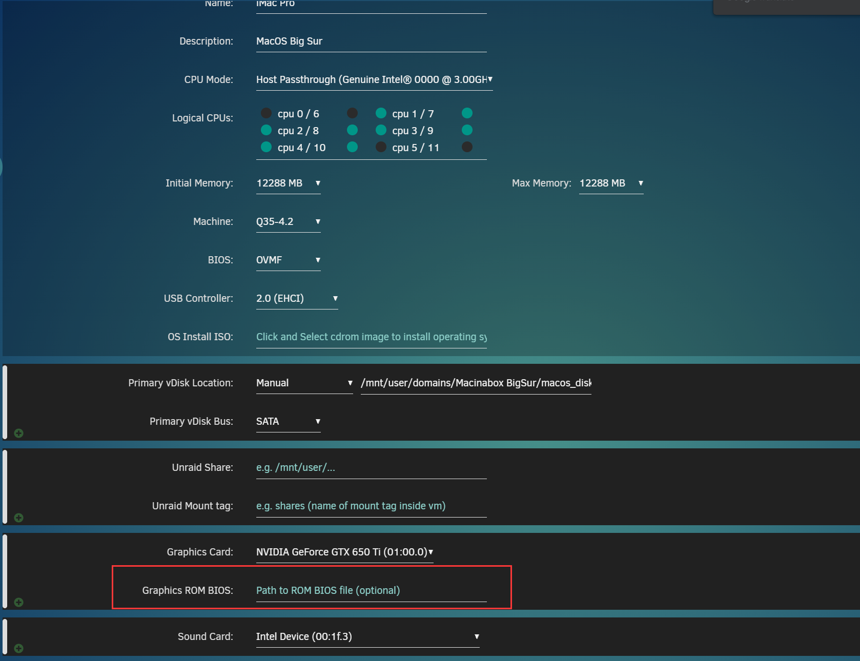

Thank you for your answer. I have tried to change the model to Q35, but they are the same, and the graphics card will report error 43. I have tried both models, MAC OS and Ubuntu, and they can drive the output screen normally. This error occurred after the 6.10 upgrade. What do you mean by diagnostic information?

I have never used the "VBIOS" of the graphics card in version 6.92. It can run perfectly. Once I use the VBIOS of the graphics card, it will lead to the paralysis of the entire server, requiring forced shutdown and restart. The windows system graphics card I installed in version 6.92 runs normally. If the windows virtual machine is not deleted and upgraded directly from version 6.92 to version 6.10, it will run normally in version 6.10. If I create a new windows virtual machine in version 6.10 and use my graphics card to install the graphics card driver, it will have 43 errors! In version 6.10, my "Mac OS and Ubuntu" can normally use my unique display. I do not provide VBIOS with a graphics card for "Mac OS and Ubuntu". They can run normally. In version 6.92, I also do not provide VBIOS with a graphics card for windows
Compare the generated XML VM profiles between what works and what doesn't.

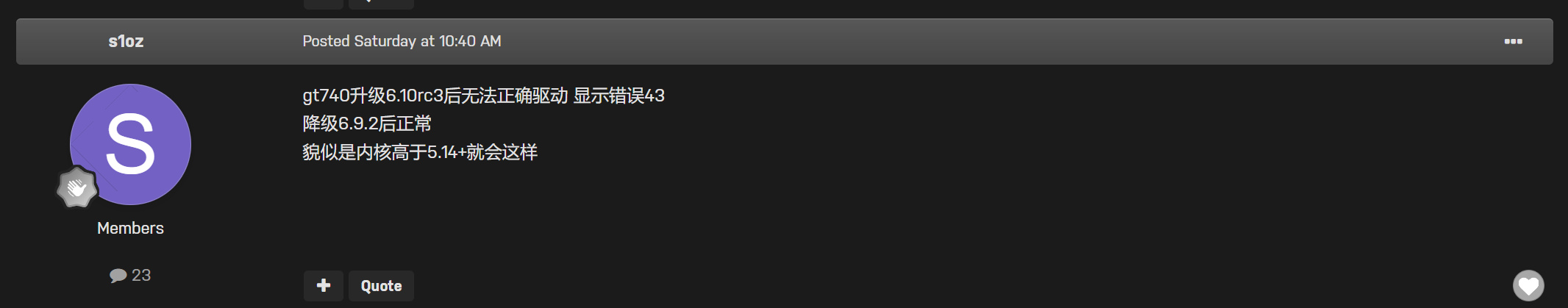

I have seen similar problems in the Chinese sub forum. He said that such errors will occur when the VM kernel is upgraded to version 5.14 or higher. He can also roll back to version 6.92 and install the graphics card driver normally. I suggest you collect the recent 43 error messages from the graphics card. I have found at least five similar problems in the forum
