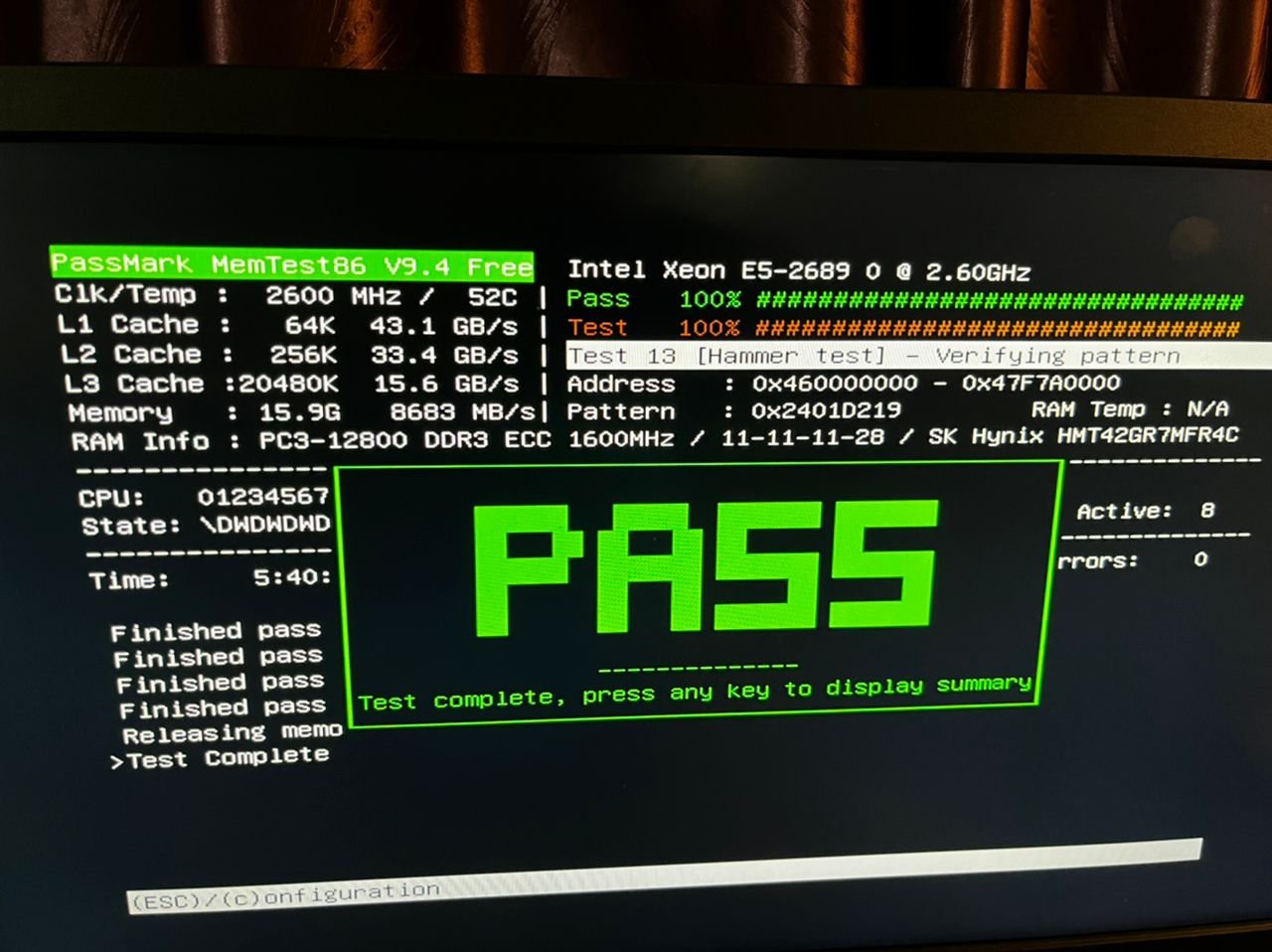

I've remove all ECC RAM and just use 16GB for now. After 5 hours later the result PASSED. Hence I will only use one RAM to perform parity sync and awaiting next 2 hours to complete and will update the outcome.

Seems doesn't solve the issue even the memory result has passed.

syslog MemTest86-Report-20220623-150250.html
i fixed the issue it is due to bad RAM slot evendo the memtest that i did on slot 12 are working fine.
Thanks everyone for the assistance.
