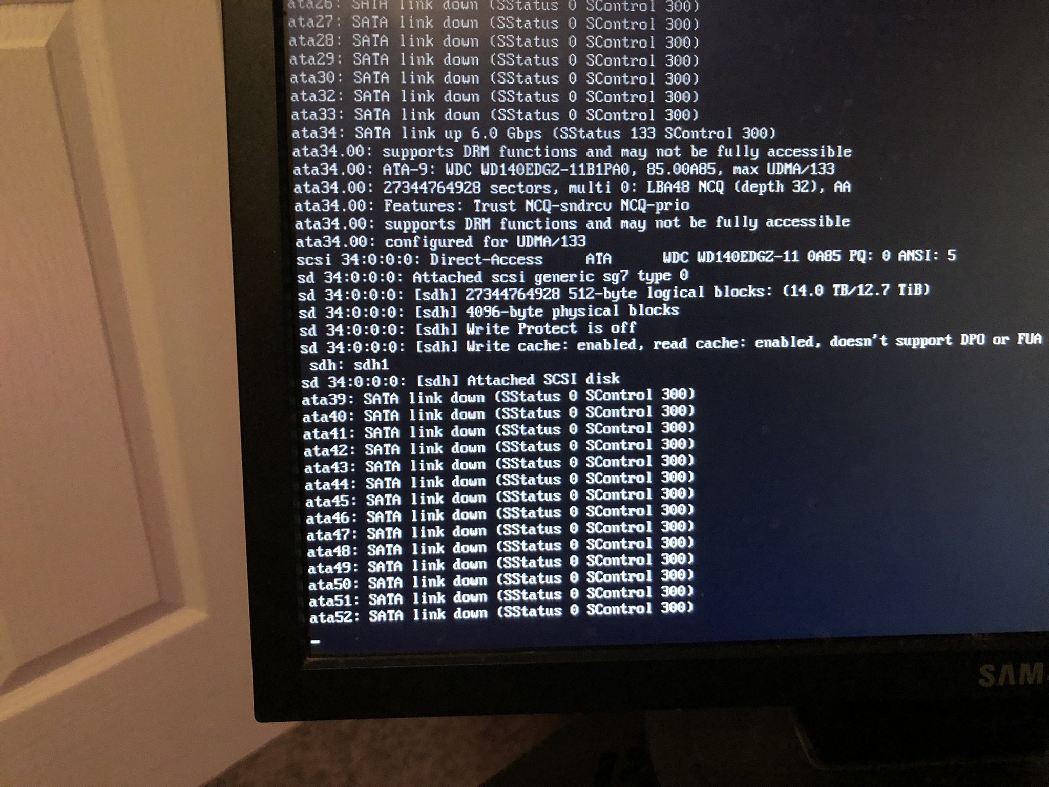

so I get 2 new SATA cards (mentioned above). Take the old Maxell cards out, put new ones in, hook everything up. Start it up, and the 2 drives that were out of sync don’t show up at all, as well as a third drive.
Shut down, replace the SATA cables for those 3 drives. Start it back up, now FOUR drives are missing. They don’t seem to be on the same card, ones even in the motherboard. Aaaaack…
Check power connections, including splitters
You can ignore all those SATA link down messages, it's typical with some Asmedia controllers, they are "phantom" ports, i.e., they don't exist.
I reset the cards, no luck.  Later today, I'll try seeing if Maxell cards fix it, if not, I'll recheck all the cables.
OK, I tried the Maxell cards, no difference.  I then pulled every drive out, and reset all the cables.  I think there was a MOLEX splitter that had come loose.  Now all drives are showing up, and my disc 7 and parity 2 are being rebuilt, and I have the non-Maxell cards in and running.
