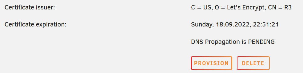

July 26, 20224 yr Hey, I'm providing a custom SSL certificate to Unraid and update it with a shellscript. Still, I need to click the "Provision" button under "Settings -> Management Access" manually: How can I invoke the functionality of that button from my shellscript that's running on the server?

July 26, 20224 yr Author This is the path it shows in the settings UI. I just replace that file with my custom certificate (it has nothing todo with Unraid.net or whatever server they offer), but nothing happens. Unraid only picks it up when I press "Provision". So I assume that I need to press that button. If there's a better way, please tell me

July 26, 20224 yr Solution The "Provision" button will provision a myunraid.net certificate. There is no need to press it if you are providing your own custom certificate. You can provide your own certificate if you want, but the filename is different. See https://wiki.unraid.net/Manual/Security#Custom_Certificates So have your shell script put the certificate here: /boot/config/ssl/certs/[servername]_unraid_bundle.pem And then run: /etc/rc.d/rc.nginx reload
