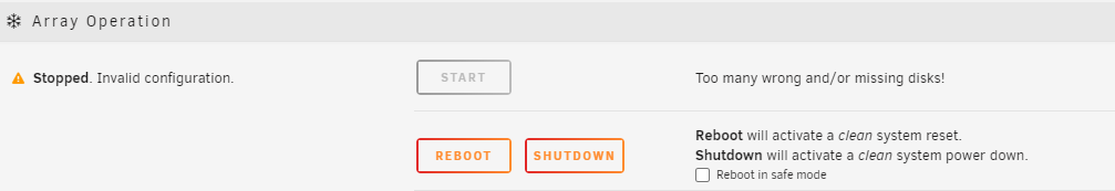

July 27, 20224 yr I just built a NAS and have a 40GB drive that had Open Media Vault installed on it. Foolishly I left it in the chassis when I built the array. Now I want to remove and replace it with a 3TB drive but I cannot. Acording the manual, you do this: "Unassign the disk you want to upgrade." Check. "Start the array to commit this change and make Unraid 'forget' the current assignment" No can do. "Start" button is greyed out and displays the following error message: "Too many wrong and/or missing disks!" I only unassigned the one disk, no others were unassigned and no drives have been physically removed from the chassis. I'm currently running the trial license.

July 27, 20224 yr 40 minutes ago, neowalla said: That sounds like the nuclear option. It's not. It allows you to keep existing data on any assigned data drives while rebuilding parity based on those drives. 40 minutes ago, neowalla said: I can't upgrade drives in an existing array. When the array is started are there any drives without the green indicator? The error message you are getting is an indication that Unraid already had a drive emulated before you tried to replace the 40GB drive, and each parity drive can only emulate one failed or removed drive at a time. All remaining data drives must participate in the reconstruction of a single (or double with 2 parity) drive. Post a screenshot of the main GUI with the array started, and attach the diagnostics zip file to your next post in this thread.
July 28, 20224 yr Author marksnas-diagnostics-20220727-2042.zipmarksnas_Main.pdf I had to save the Main page of the GUI as a PDF as I couldn't fit the whole thing in a screen grab. I do not have any parity drives assigned yet. Maybe that is why I cannot remove disk 4, the 40gb drive? Without going into a long-winded diatribe, I bought 3 Seagate 8TB drives for this NAS and one ended up being DOA. I shipped it back for warranty and have the 2 working ones in the array and plan on using the third as the parity drive once I get the replacement. In the meantime I have been dumping data into the array though I have not yet filled one 8TB drive yet. As I free up the 3 and 4TB drives I have kicking around, I plan on adding them to the array as they become free. I have a Wasabi cloud account and plan on using it for off-site BU of the array. What initially attracted me to Unraid is the ability to add drives adhoc without the need for them all to be the same size, speed, etc since I have acquired a lot of drives over the years that I have used for off-line storage so they all mostly have low hours.
July 28, 20224 yr 18 minutes ago, neowalla said: I do not have any parity drives assigned yet. Maybe that is why I cannot remove disk 4, the 40gb drive? You just need use new config tool and tick 'Preserve current assignments' then unassign the 40GB disk to remove it. If you want to add new disk, you can do it in same time. After confirm all as expect, then you can start array, if any wrong, just re-do new config. Edited July 28, 20224 yr by Vr2Io
July 28, 20224 yr Solution without a parity disk you cant do the standard disk swap procedure as there is no way to rebuild the data onto the new disk. Definitely need to go the New Config route to get it to forget that 40gb disk ever existed and not have to replace it with a new disk. Alternatively, add a parity disk now, let it rebuild, then you will be able to replace the 40gb with a proper disk after that.
