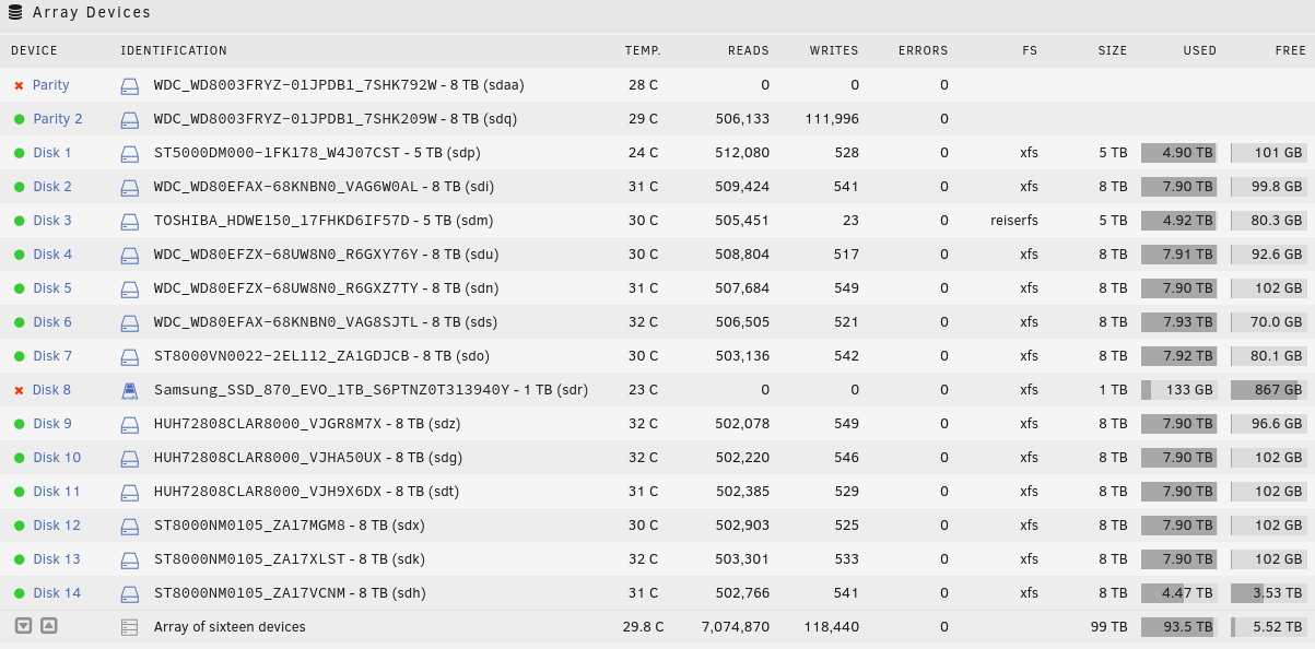

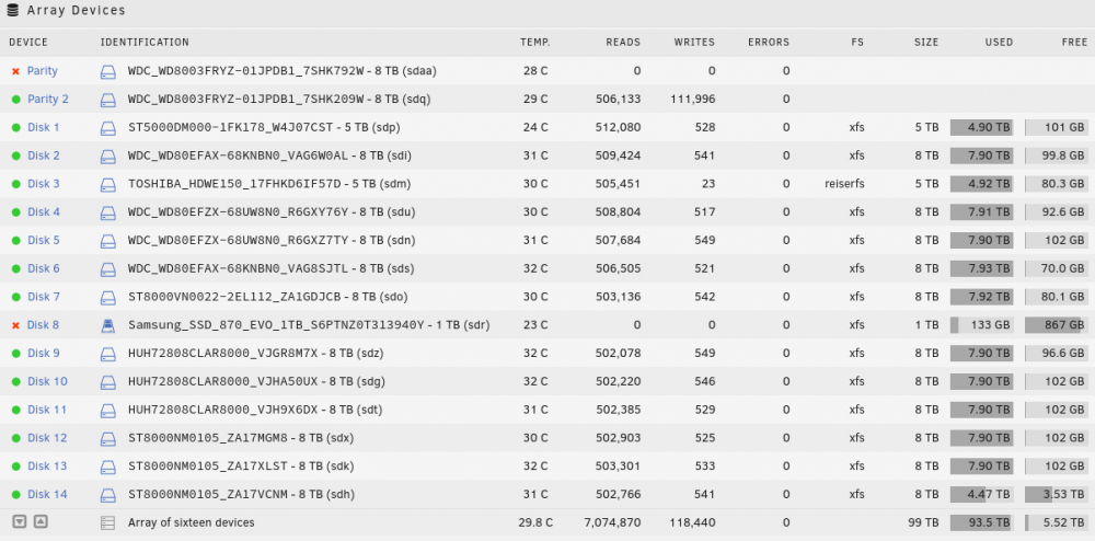

Post a screenshot of Main - Array Devices
