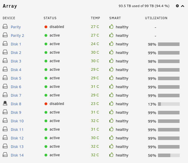

  • Controller is OK, only the LSI HBA is being used.   Initial issue appears to have been a power problem, multiple disks dropped at the same time.   Disk10 does appear to be showing
  • mathomas3
    mathomas3
    Both drives cleared on the extended check and thus far zero errors on disk 10... I will keep an eye on that disk...   Parity and disk 8 are being rebuilt now... decided to replace both of th

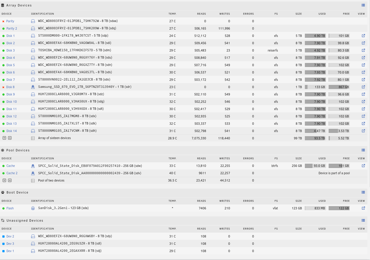

Here is a complete Main page. I have 3 disks attached and unassigned, waiting to be added to the array should the need arise

About your configuration.
To me, it would have made more sense to put that 1TB SSD (currently assigned as disk8) as a single disk pool for caching (XFS, no redundancy since it is going to eventually wind up on the array), and use those 2x256 SSDs (currently assigned as cache) as another fast pool, btrfs raid1, for appdata, domains, system shares.
To me, it would have made more sense to put that 1TB SSD (currently assigned as disk8) as a single disk pool for caching (since it is going to eventually wind up on the array), and use those 2x256 SSDs (currently assigned as cache) as another fast pool, raid1, for appdata, domains, system shares.
I do like that plan... Just havent took the time to get it done... The fast pools are something new that I havent touched on yet.

Disk 8 just completed with zero errors... Parity drive is still at 10% ;)
8TB HDD will take many hours for extended test, with updates every 10%. Might as well check back tomorrow.
Disk10 does appear to be showing some issues, run a long test and even if it passes any more read errors I would recommend replacing it.
Parity and disk 8 are being rebuilt now... decided to replace both of the disk with the spares that I had on hand and plan to use trurl's advise...

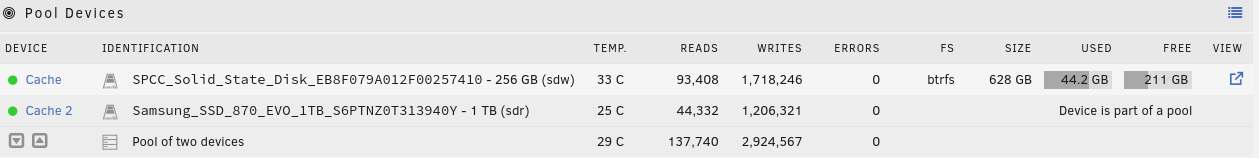

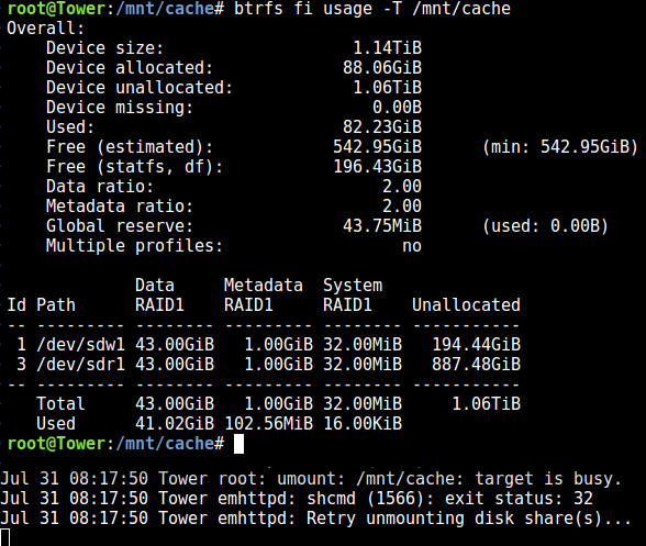

While attempting to get the cache setup with  the 1tb drive I tried to let mover clear off the data, which didnt work. So I ended up unassigning one of the cache drives and assigning the 1tb in it's place. I waited for a bit for the btrfs process to complete and validating that by using btrfs fi usage -T /mnt/cache and when everything was complete I tried stopping the array to unassign the last small drive from the cache, but I am getting the error 'umount: /mnt/cache : target busy' do I have to do a hard power off again?
tower-diagnostics-20220731-1018.zip
ended up doing a hard reset... everything seems fine
Nothing can move or delete open files. You have to disable Docker and VM Manager in Settings if you want to manage files in appdata, domains, system shares.

When I was trying to use mover to relocate data, everything was disabled and rebooted to ensure there were no file access issues... After leaving it over night it was still far away from where it needed to be... ended moving things by hand to where it needed to be and thus far it seems OK...
The cache needs to be cleaned up though... I still have to pull one 265gig drive from there and add it to new disk pool. From what I have read this isnt something that can be done without wiping out the cache system again?
My plan once I got back was to disable everything again and try mover(or by hand) once again... remove the cache setup... move the 256 to the disk pool and rebuild the cache with the single 1tb drive... and re-enable services
