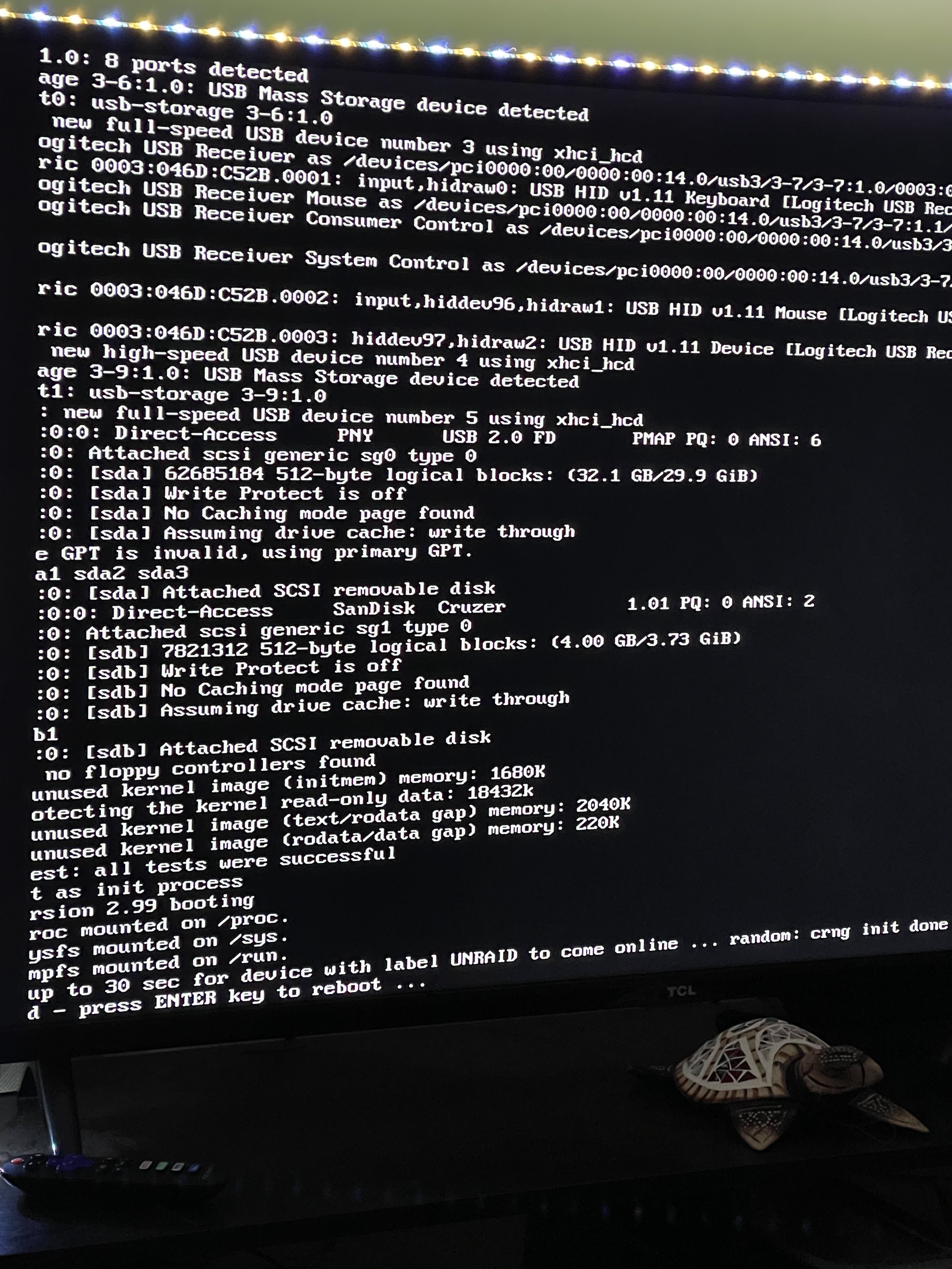

August 6, 20224 yr I am installing unraid for the first time. Followed the documentation on the website to created a bootable drive. This drive was create using unraid usb creator for MAC. After creating my bootable drive, I went and plugged my usb in a usb2.0 port, made sure it was the first bootable device and made sure vt-d was enable in bios. The device boots up but gets to a part saying “30 sec for device label UNRAID to come online … random: crng init done” and right under that I see - press enter to reboot. If I press enter it will reboot and do the same thing. I tried to recreate the bootable device with no luck. Any help would be appreciated. Edited August 6, 20224 yr by ZeroFcksGiven Typo

August 6, 20224 yr Community Expert 8 hours ago, trurl said: Is your flash drive named UNRAID? 8 hours ago, ZeroFcksGiven said: Yes. I made sure to double check that. I used the USB Flash creator from unraid docs under Getting Started How did you double check that? I know the creator is supposed to name it that, but did it? I seem to recall other reports that it didn't get named for some.
August 6, 20224 yr Author After it created, I look at the usb stick that was plug-in and the name was set to unraid. I ejected it and put it back into my Mac and verified the usb name reads as unraid.
August 6, 20224 yr Author Jorge, I will try another usb stick. The one I used was a Sandisk cruiser. I’ll try another brand.
August 6, 20224 yr Community Expert 19 minutes ago, ZeroFcksGiven said: After it created, I look at the usb stick that was plug-in and the name was set to unraid. I ejected it and put it back into my Mac and verified the usb name reads as unraid. Make sure the name is UNRAID (I.e. all upper-case).
August 7, 20224 yr Author Tried a different usb san disk drive I had laying around and that worked for me. Thanks for the help everyone!
