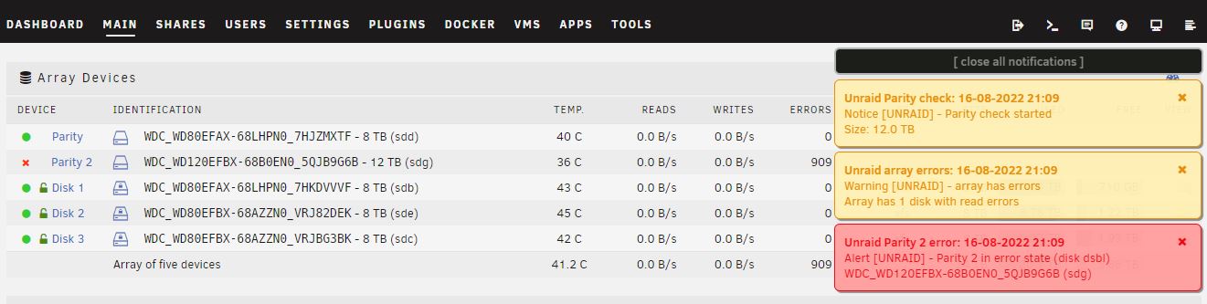

However, when I've assigned the new 12TB drive to parity slot 2 and started the array, things go south. The parity rebuild pretty much instantly pauses and unRAID gives me the error messages you can see in the attached file. The new 12TB drive reports errors and unRAID tells me that the new drive is in an error state.

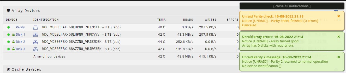

In order to get back to normal I:
  • Cancel the paused parity build.
  • Stop the array
  • Remove the 12TB drive from the parity 2 slot.
  • Start the array
unRAID then tells me everything is fine:
If I then repeat the process above the error occurs again in the same way, and that is where I am at right now.
First thought is obviously a broken disk, but that doesn't seem too likely since the disk is brand new. So I ran an extended SMART-test on the disk yesterday and the disk reported no error at all, you can find the SMART report in the attached Diagnostics file.
