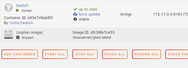

August 19, 20224 yr I'm not sure what to do from here. Do i reinstall the linuxserver plex docker? I'm nervous i'll lose all my settings.
August 19, 20224 yr Author Here are the diagnostics. plexdockerimagebroken-diagnostics-20220819-1512.zip
August 19, 20224 yr Community Expert Not clear what happened. Delete orphan and reinstall from Previous Apps https://wiki.unraid.net/Manual/Docker_Management#Re-Installing_Docker_Applications

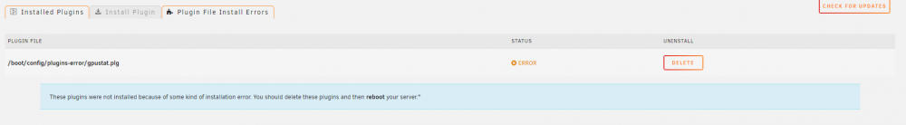

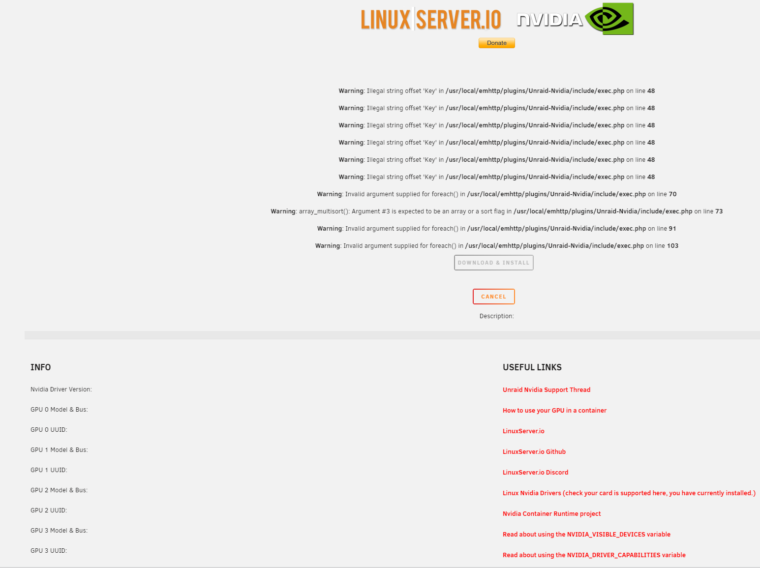

August 19, 20224 yr Author I have found this message. Should i do what the pop up says, or just roll back my unRAID operating system to 6.8.3 do you think?
August 20, 20224 yr Author I ended up rolling back the OS update and I was able to get everything working again with some minor work. Thanks for taking the time to reply.
August 20, 20224 yr 2 hours ago, bytock said: I ended up rolling back the OS update and I was able to get everything working again with some minor work. Thanks for taking the time to reply. You jumped two major revision, did you read the release notes? https://wiki.unraid.net/Manual/Release_Notes I think that the Nvidia plugin you are using is obsolete for quite some time now and is not compatible with 6.10 (or 6.9).
