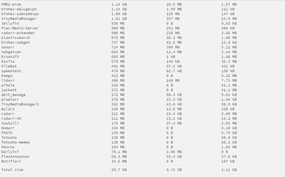

image.png.cdb0e81a804cc67cc9fcd5db990f47d8.pngIs this what I am looking for size?

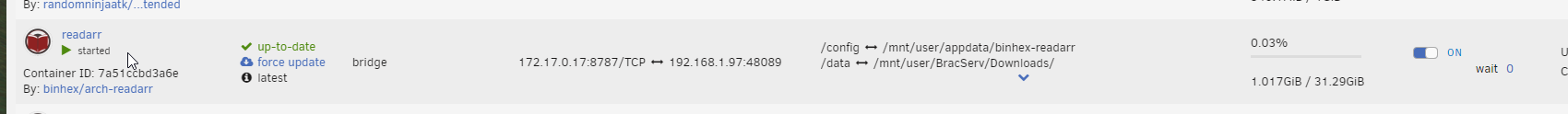

On the Docker page, at the very bottom is a button that says Container Size. Click that button and post a complete screenshot of the results.
Maybe you need to increase the size another 10G.

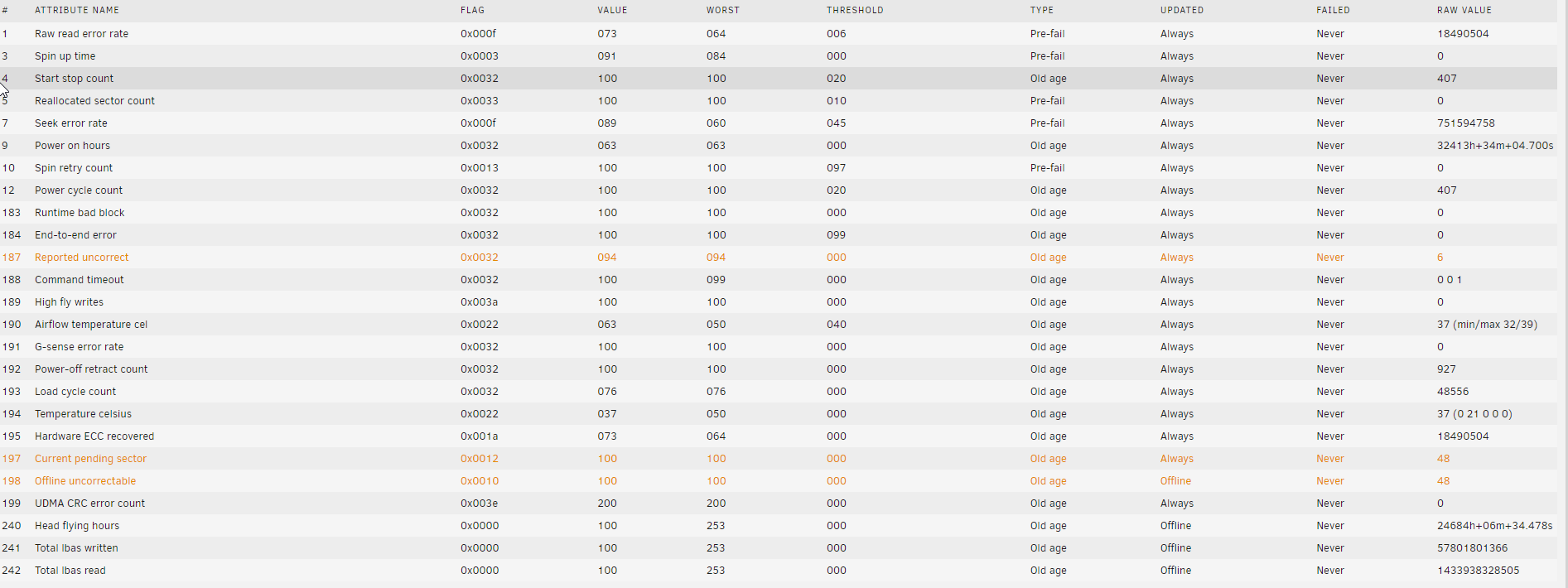

I did extended smart test on this diskimage.thumb.png.0f41532c52f315f03bbacc9cb43e78d9.png
The reason I suggested leaving that one out is just to simplify your array since it is empty. If parity rebuild succeeds without problems you can add it back later.
