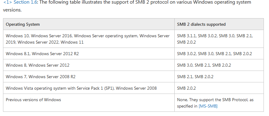

I'm assuming it might have something to do with "SMB: remove NTLMv1 support".
Edited by Jaybau
11 minutes ago, Jaybau said:
No domain.  Home network.  "WORKGROUP".

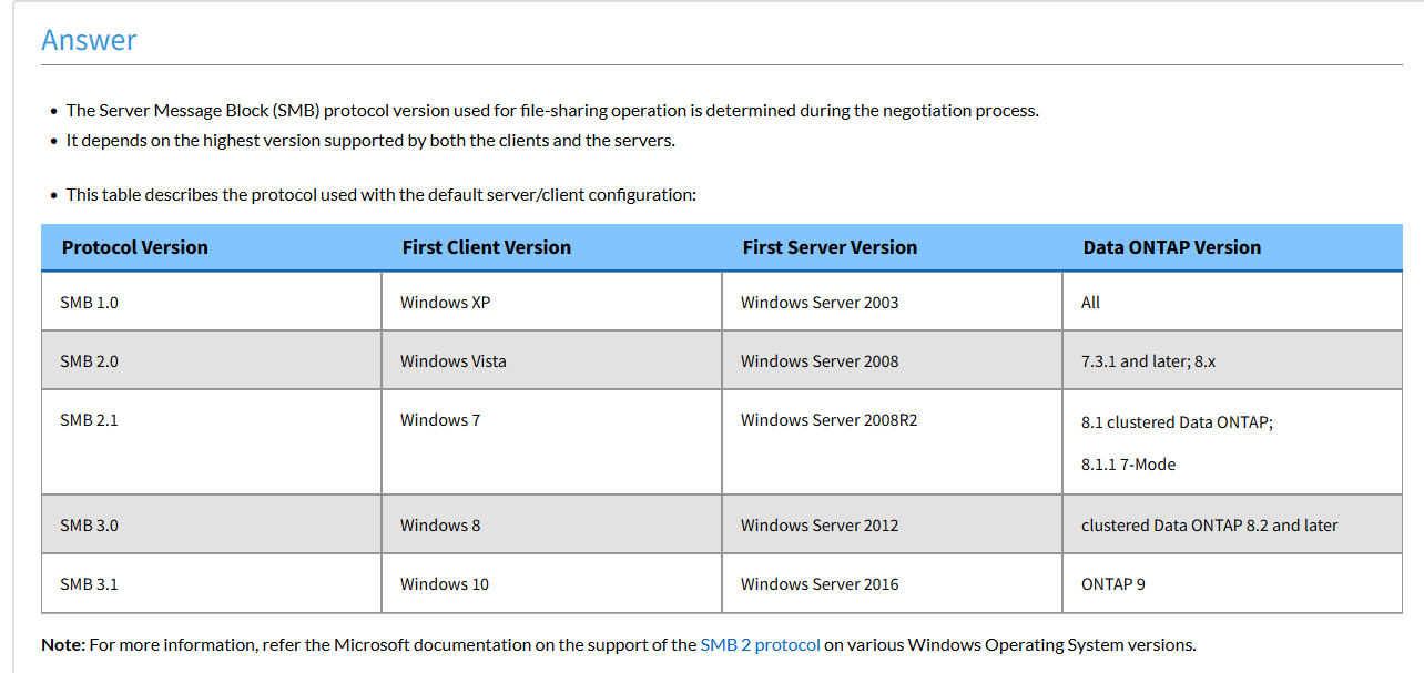

Should not be an issue as Window 7 support SMB 2.1  as shown here:
And this:
Edited by Frank1940

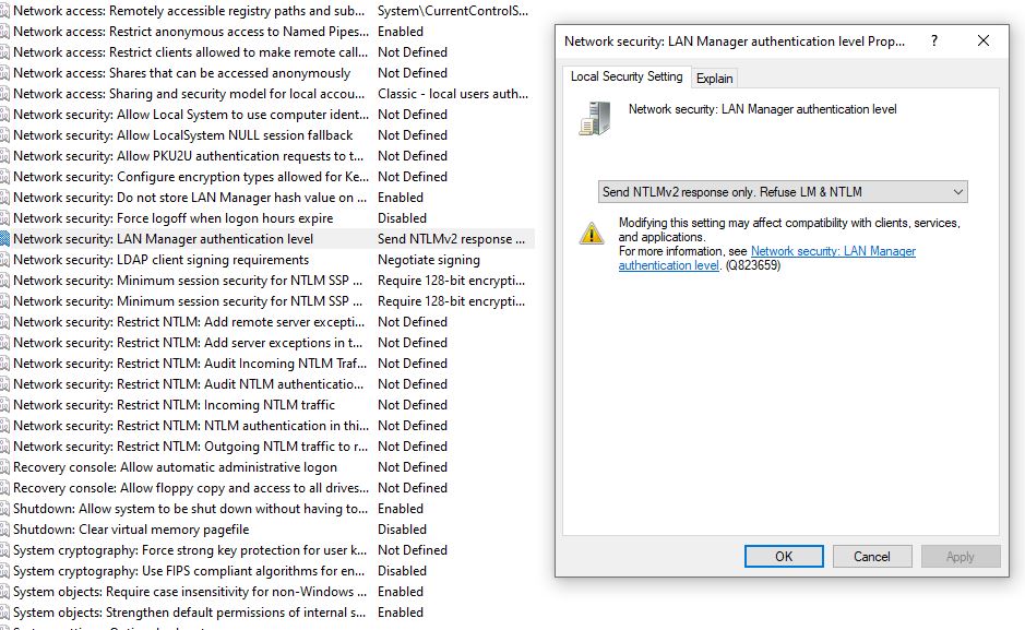

Same thing happened to me there, updating from 6.10.3 to 6.11 - no smb access to any of my exported shares, credential errors. I reverted back to 6.10.3 and all is good again.
Sorted there on Windows 10, I changed the attached setting to display as shown. It was set to "Use NTLMv2 Security Session if needed", and I vaguely remember changing this setting ages ago to help with slow SMB speeds, so maybe that's the issue? Unfortunately though, I'm still seeing fluctuating/slow smb transfers to my cache drive (980 Evo x2 in BTRFS)
Edited by Unrayed

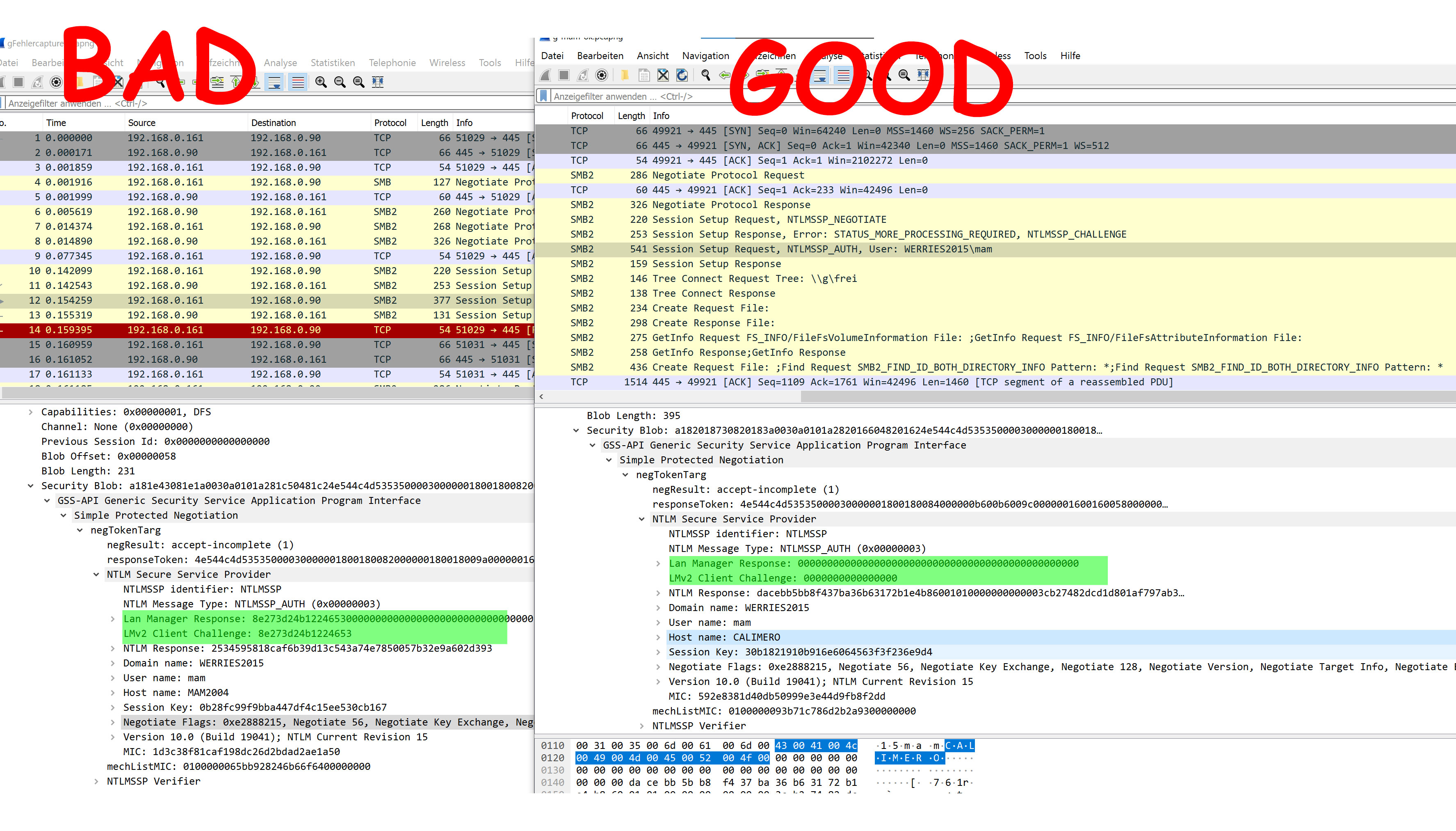

this is really tricky. so far I did not find the difference between "working" clients and non working ones.
It is NOT :
* windows version and edtion
* Domain membership or not
Anyway, I have a working and nonworking client on the same lan now and can do measurements against a 6.10 and a 6.11 server at the same time. But debugging SMB is not really my thing...
At least I was able to do some captures, two clients, domain members, same user, same command issued ("dir \\g\frei") to view a public share on an 6.11 server. One client works, one gets "wrong password" denial. Comparing the packets I found the first difference in the session setup packet:
the green lines mark the spot. the "good" client sends zeros as challenges, the "bad" one sends some data (and UNRAID answers with "don't like you error" and cancels the connection (red frame on the left).
(I did the same with 6.10, looks alike, but this time Unraid is pleased to get a challenge and lets the user access the data)
I have no idea what makes windows to insert a challenge or not and even fewer ideas how to control/stop it.
Maybe somebody can make an educated guess?
