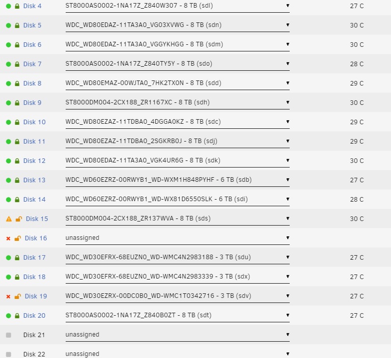

Here is current state of things.
Disk 15 is the new disk, formerly "unmountable," which got 30-60 seconds through a format before I aborted and shut down the array.  I have the original Disk 15, the one with SMART errors.
Disk 16 is physically present, but not showing as assigned.
Disk 19 is also red x'd.
I have two new-in-box 8TB disks waiting, arrived a few hours ago.
I have absolutely no idea how to proceed at this point (two parity disks if it matters).  At the very least I'd like to get 16 and 19 back in the game, and worry about 15 later.  Unless there is a better order to this.....
Diags are after rebooting so we can't see what happened, but disks 16 and 19 look mostly OK, disable disk spin down and run an extended test on both, then post new diags.

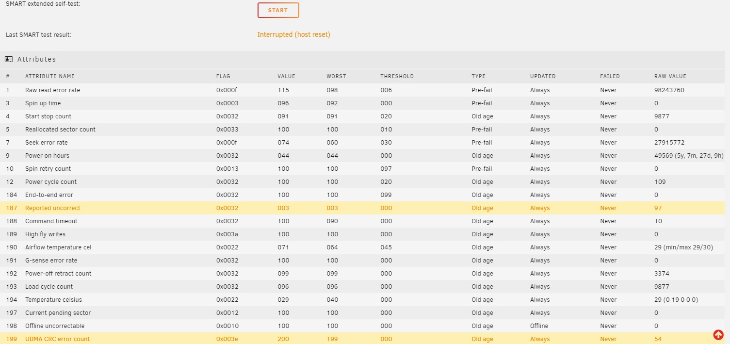

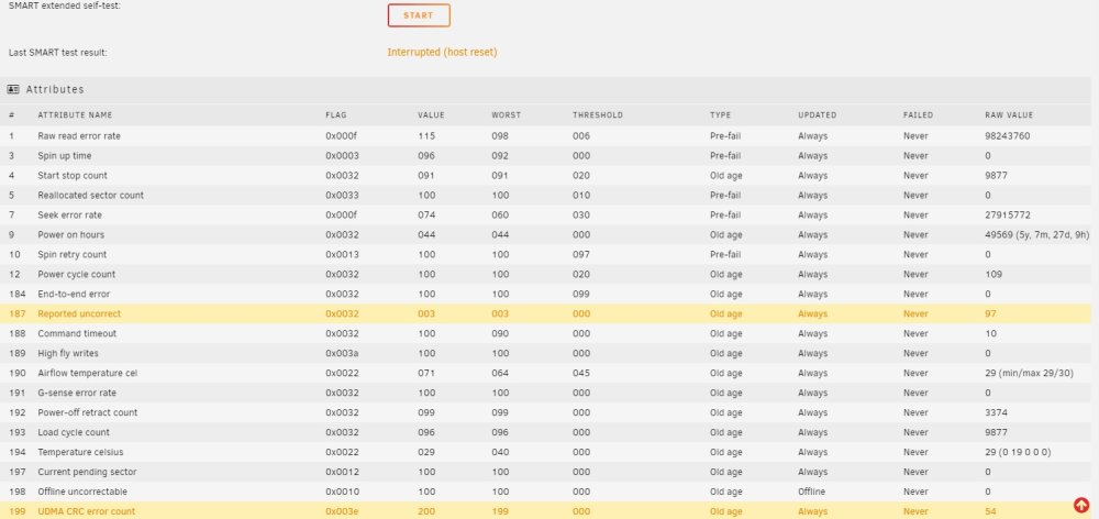

Test didn't run for very long (not sure how long as I wasn't babysitting but it wasn't more than 30 minutes) before the host interrupt error popped again.  See attached.
You need to disable disk spindown for extended tests, otherwise it'll get interrupted when unraid tells the drives to spin down.
Unless I'm missing it somewhere else, under Settings -> Disk Settings, I set "default spindown delay" to "Never," and the extended SMART on #16 isn't running for more than a few minutes without "Interrupted (host reset)" being the result.
I see there is a place to set individual disk spindown as well -- I have set it to "never" for #16 specifically and run extended SMART yet again.
No effect.  Extended SMART won't even run for a few minutes before host interrupt occurs.
Short SMART test lasted 33 seconds and got to 50% before I got the host interrupt message on #16.
