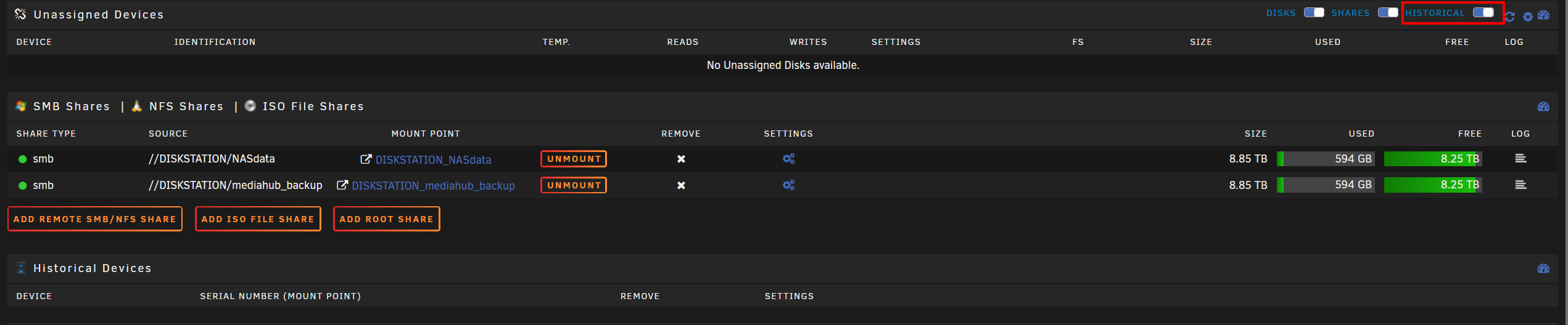

There are several (four) disks under "Historical Devices."  I have never seen that before.
This is part of the Unassigned Devices plugin. It would show drives that were connected to UD and are not anymore.
You can remove this panel (or any UD panel) with the toggle on the top right of the plugin section.
