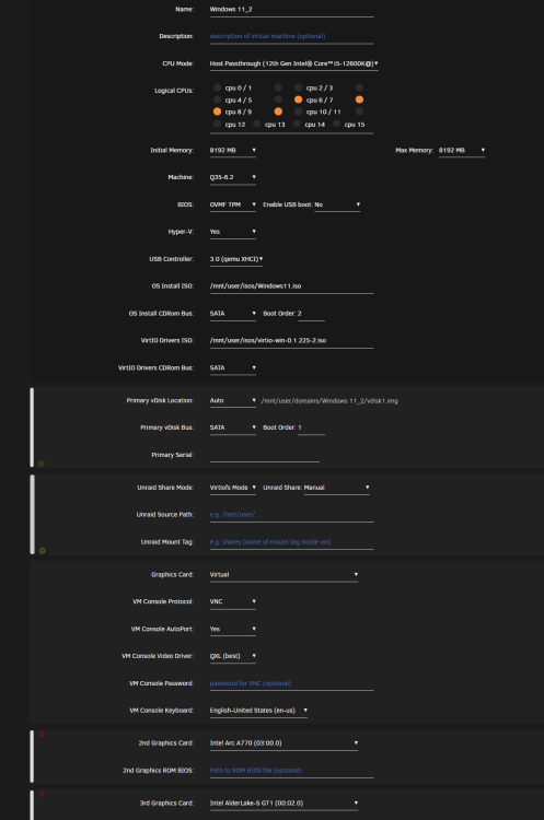

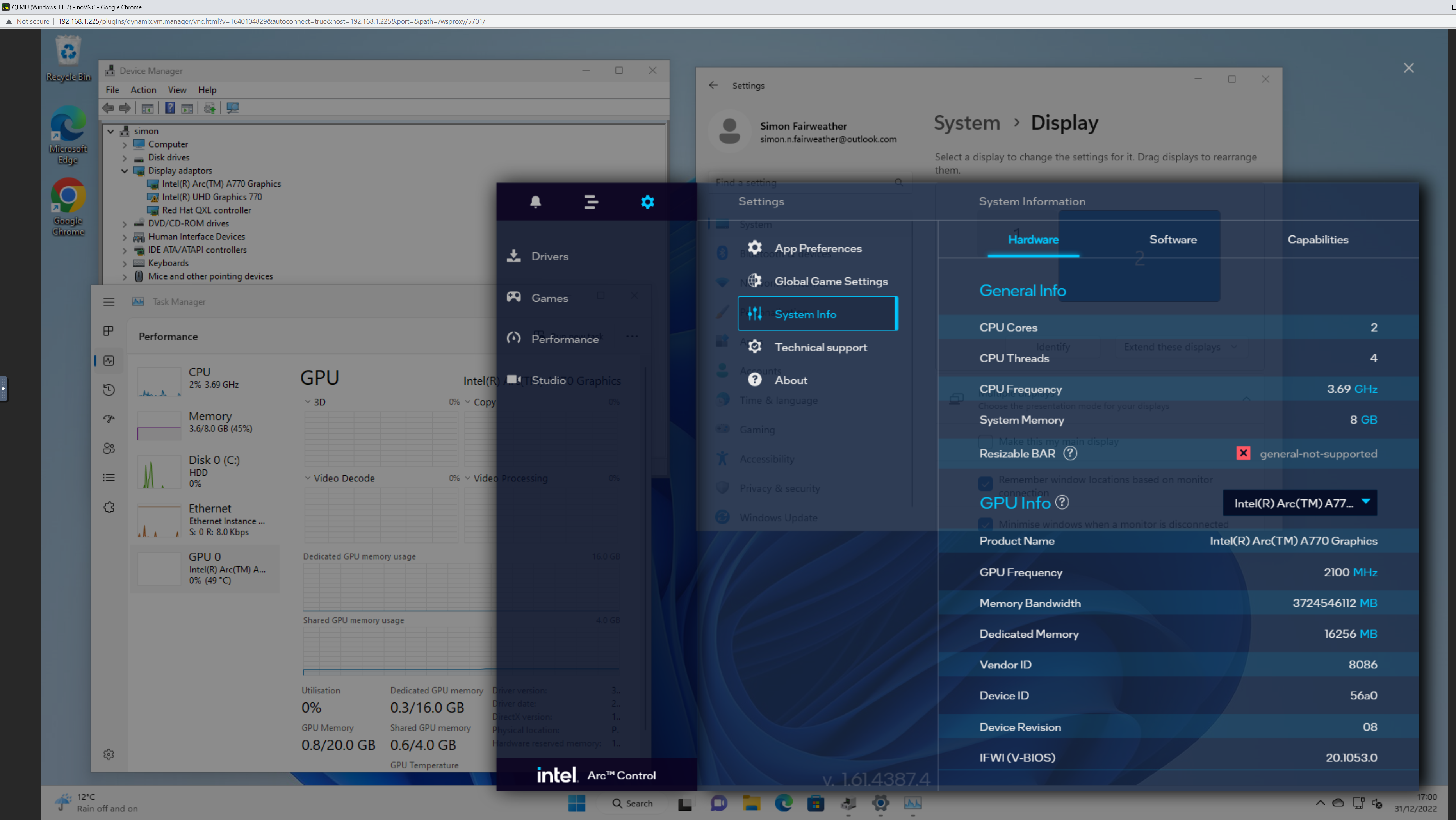

    Oke so this weekend i had some free time to spend and checked out support on unraid 6.12 rc2. I started of fresh by reinstalling my flash drive and putting back a copy of the config folder on to it.

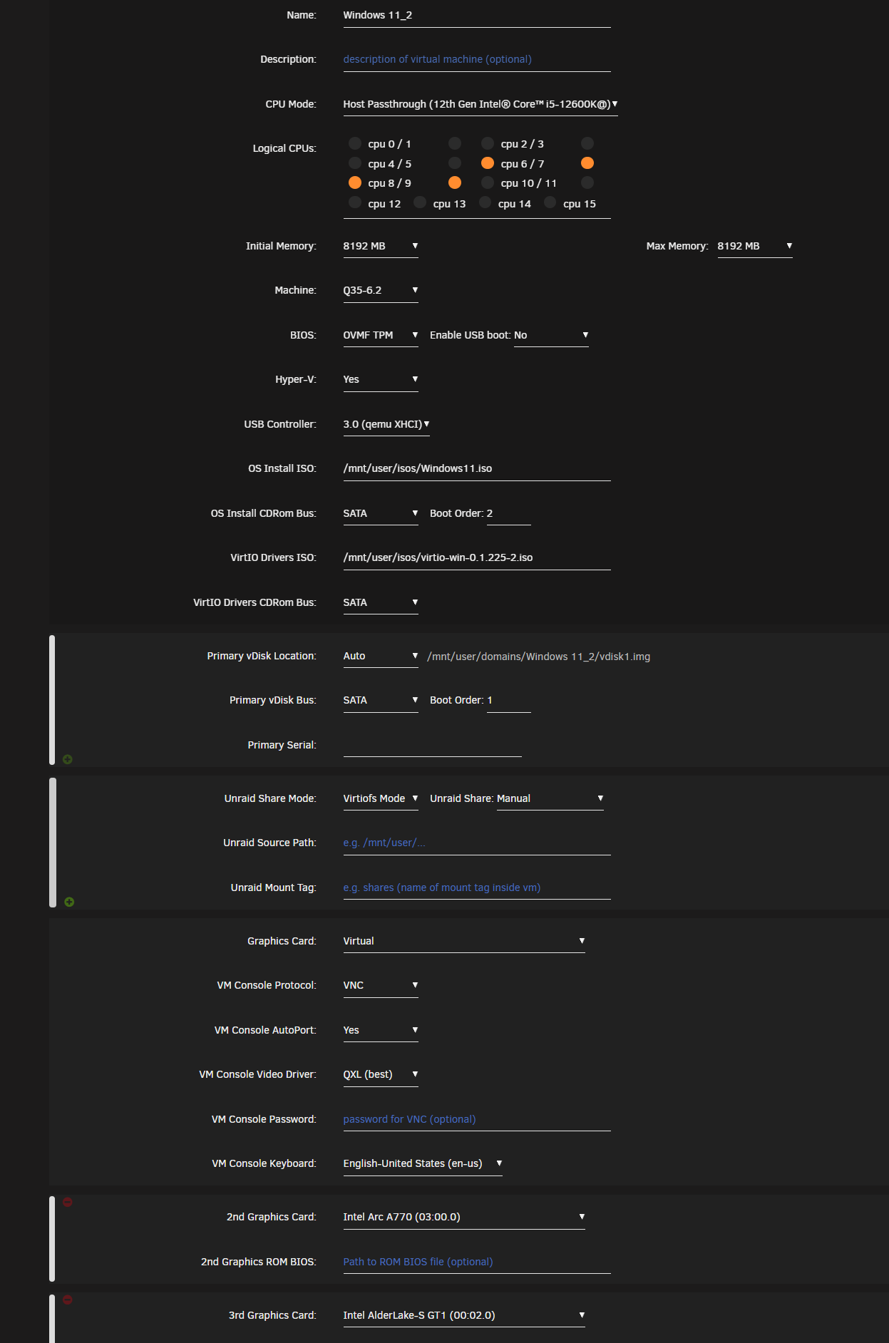

  • What are your vm settings for the guys getting passthrough working? Any special steps taken? I keep getting code 43 after installing the latest beta drivers.
People that it working please show the basic setting for your VM
FYI it works without the Virtual and igp also.
Looks like my VM config is almost identical. Changed my BIOS to match yours and reinstalled the OS and still looks like I'm getting a Code 43.
8 minutes ago, technicavivunt said:
Looks like my config is almost identical. Changed my BIOS to match yours and reinstalled the OS and still looks like I'm getting a Code 43.
What cpu do you have?
Threadripper 3955WX
This time I got an error report when trying to install the driver.
|ERROR|Something went wrong while converting string to pci identifier
|ERROR|Something went wrong while loading "DisplayDevice"
|ERROR|Something went wrong while loading device
|ERROR|Something went wrong while creating device. Guid = "4d36e96c-e325-11ce-bfc1-08002be10318"
My CPU is an intel i7700k so maybe a little old? Looks like I need a 10th gen or newer. I thought having resizable bar was optional.
Edited by AndyLively
Ok only a slight difference I will try to rebuild to match.
Managed to get it working for me. I needed to make sure a couple settings were set in Bios no changes from what SimonF put in his screenshot.
- I set my bios to UFEI boot only
- Enabled resizable bar (not sure if needed)
- MSI bios had an option to detect VGA devices it was set to auto. Turned it off.
- IGPu set to default display
- Rebooted
I will likely test some encoding. So far its been good. CPU AV1 was giving me 2hr estimates on a 30 minute file. Now I see 6-10 minutes with Intel profile.
This is in your host bios?
Yeah bios of my rackmount nas in this case

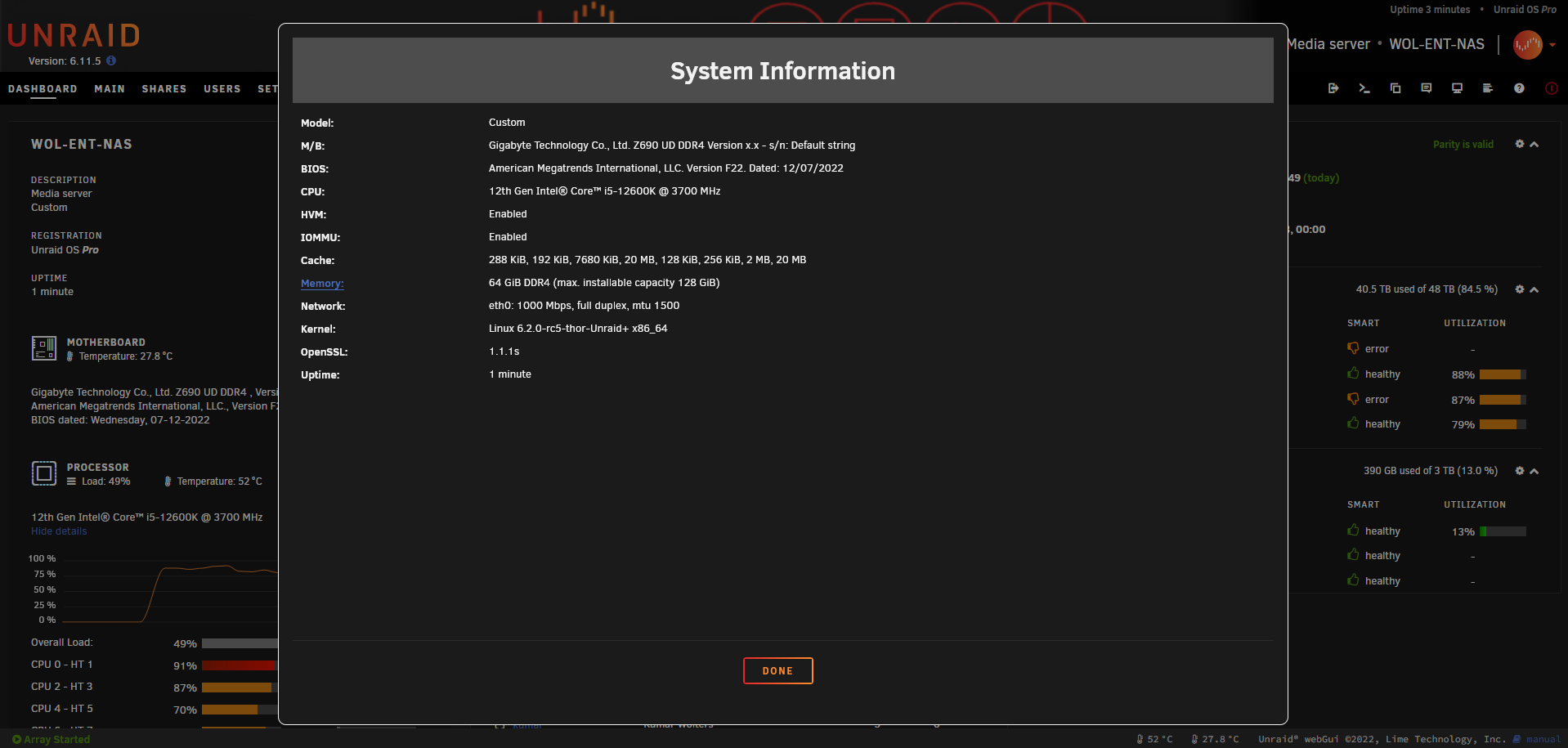

I finally got the kernel to work, See print screen below, Also The DG2 card shows up in terminal: ls /dev/dri. Now let's see how far we can get this to work. I also dit de syslinux edit for i915 to force probe the dg2 card.
The main problem was my netowrk.cfg file, for some reason the official unraid 6.11.5 worked normal but replaceing the files from thor2002's kernels broke everything. I took a plain version of the network.cfg file from the manual install zip and changed all neccessary netowrk info accordingly and now I have hopefully a working kernel with the A380 GPU

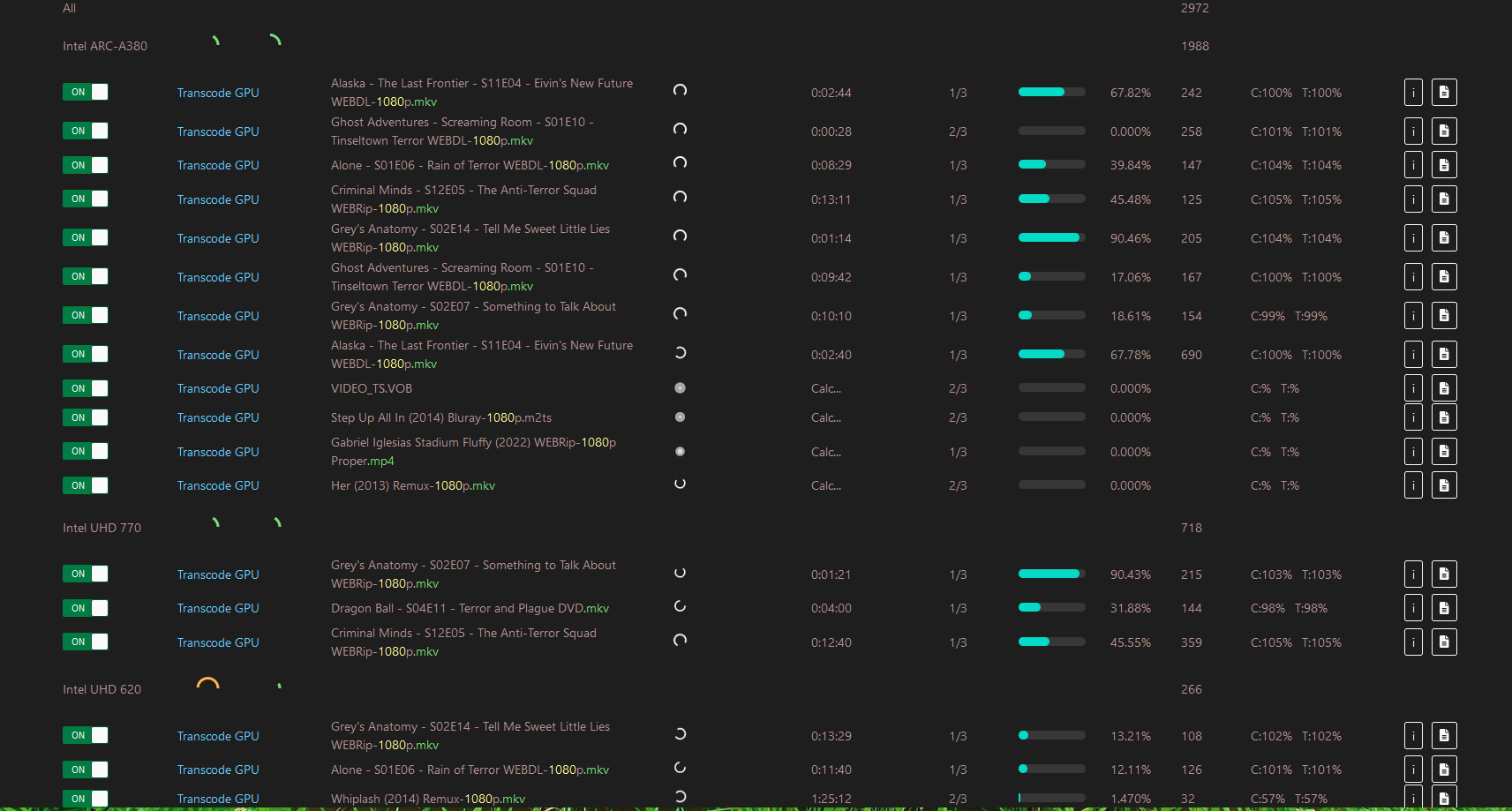

I got everything to work, The ARC A380 is converting H264 to h265 files at this moment. After the changes of yesterday I didn't change to much I'm checking my notes and will make a good Short tutorial for those wanting to get on some support in docker
Looking forward to the tutorial!  Also curious, what application is the image showing here?  I'm looking at options for transcoding with the A380 on the software side and whatever it is you're running looks pretty nice!
The software used is Tdarr, it's one of the only if not the only docker that supports the ARC gpu, Unmanic, and Plex are not working at this moment and I think that is because the intel-media-va-driver-non-free is missing from those dockers.
So i wrote down a little tutorial it's in the attachments, For those needing gvt-g I have not tested the need of this but the arc gpu doesn;t work with intel gvt-g installed thnx to the blacklist.i915 line in modeprobe.d/i915.conf My platform also is not supported so i didn't test this part maybe someone can do it and help at that end.
And if you follow my tutorial and come across problems feel free to ask for help by dm or on the forum, If you want a deeper dive on my problems with getting this to work feel free to ask. I did not mention a lot of them only the one that kept me busy for two days.
And last I'm still testing to the arc gpu is only working in tdarr at this point. And only HEVC no AV1 tested yet, In the coming days I will start testing other dockers and find differences to get good support.
