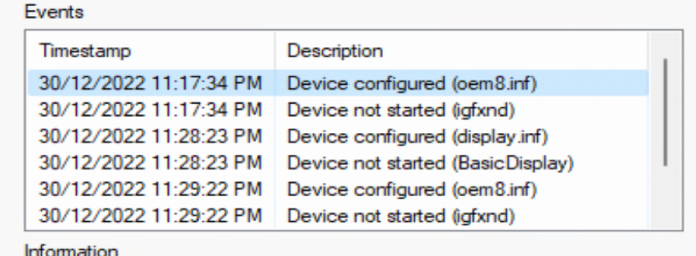

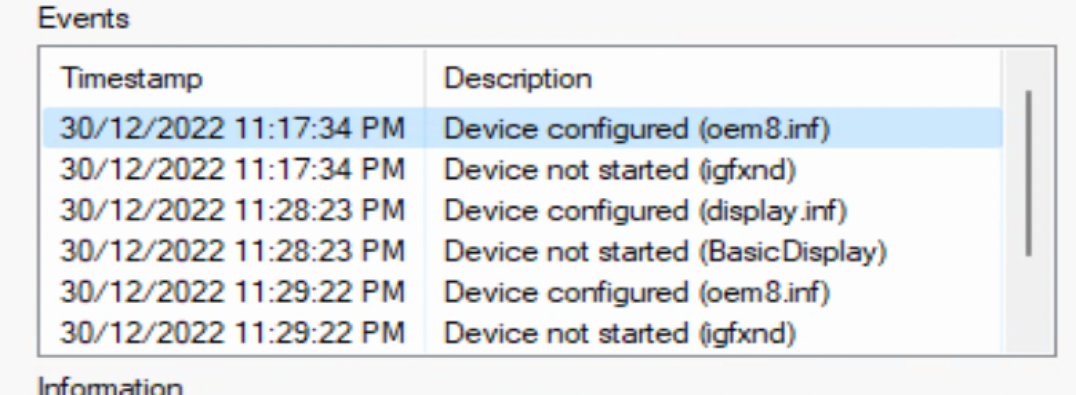

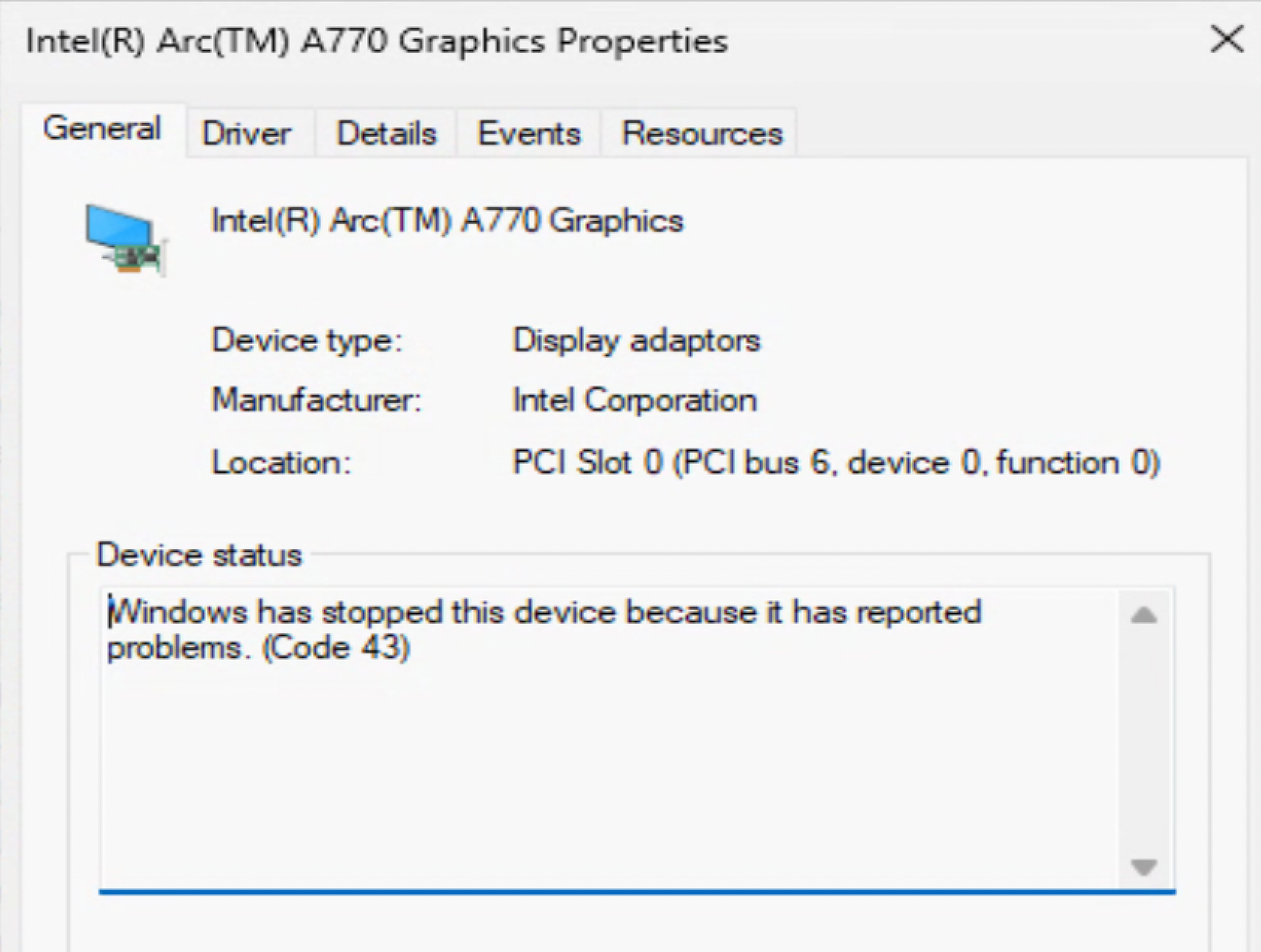

I cant get passthough to work either. I have nomachine on the VM and can connect to it but it fails to install the driver. Its a bit hard to operate as in this mode the resolution is 640x480
It doesnt show up on the monitor at all, I have also tried display port and hdmi.
I get error 43.
My other GPU works for passthough in this machine fine.
I also tried windows 10 and now 11 but same problem.
The card is not the primary when booting (in bios) and I am using the inbuilt GPU for that.
Edited by AndyLively

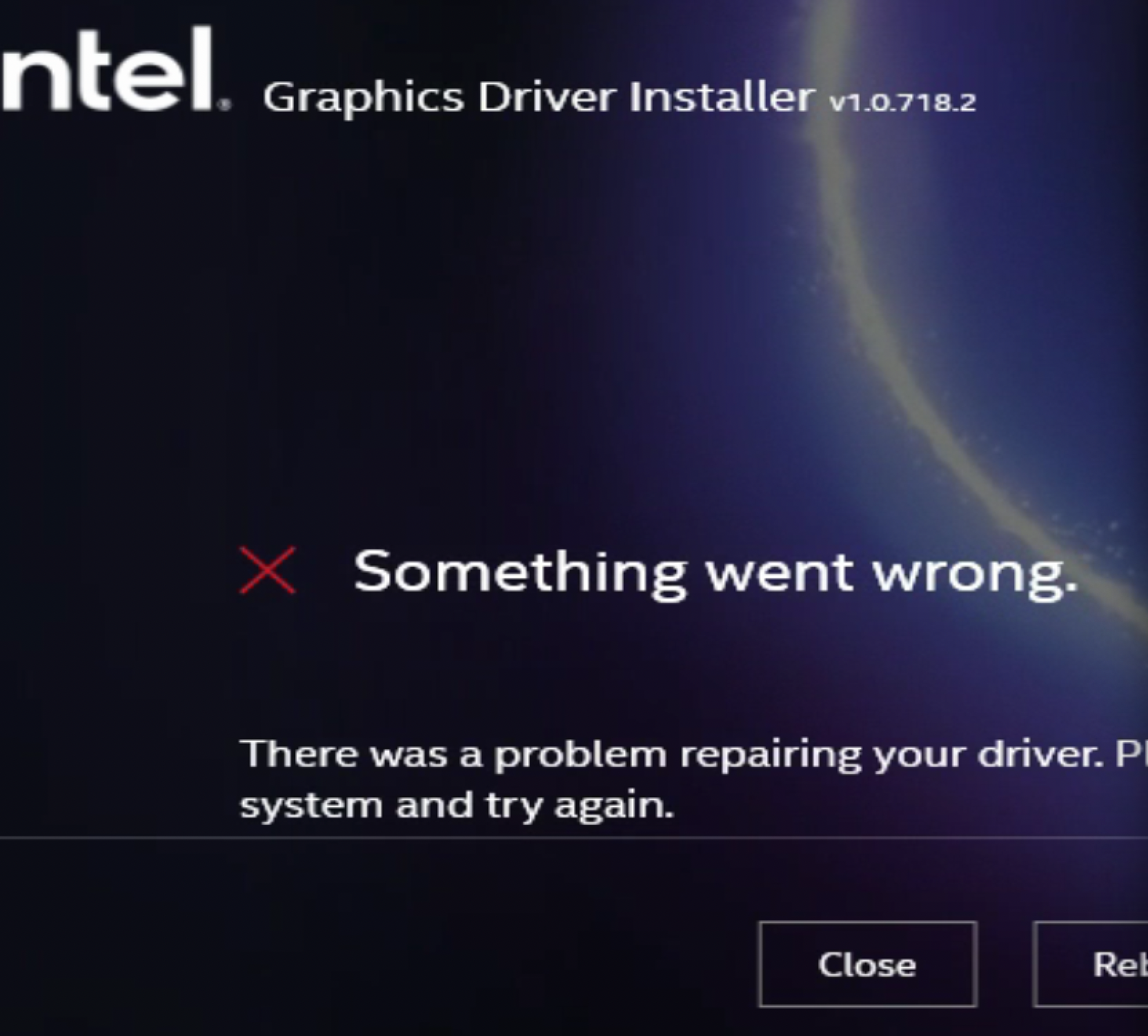

I can get it to install but when I reboot it is code 43. I can disable and then enable and the code will go away but the gpu is not usable. Reboot and its code 43 again.
Same thing here while using my threadripper build. 2 GPUs, one 1060 and one a380
have you tried the beta drivers?
This is with the beta drivers with the regular driver it cannot be enabled in when in OS at all. Just curious how it works for some people.
8 hours ago, AndyLively said:
There is a new driver released yesterday on the stable channel. 4032. This doesnt work for me either
https://www.intel.com/content/www/us/en/download/726609/intel-arc-iris-xe-graphics-whql-windows.html?
I have just updated to these drivers and they work for me.
Ithink I don't have resizeable bar enabled in the BIOS as could not get it work with it enabled.
Disabling ReBAR right now and trying the 4032 driver to see if that helps.
