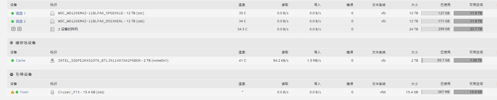

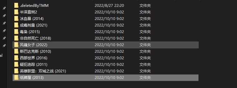

shallwei Posted October 10, 2022 Share Posted October 10, 2022 (edited) OS:6.10.3 2 x 12tb disk 1 x 2tb cache disk i found the all my 12tb disk data delete on 10/10 9:00PM and the cache disk is OK. the file folder is exsit but all my file is delete. it's urgent for me some important video is on the disk still not backup. homelab-diagnostics-20221011-0015.zip Edited October 10, 2022 by shallwei add the diagnostics Quote Link to comment

JorgeB Posted October 10, 2022 Share Posted October 10, 2022 Disks are empty, that suggests something (or someone) deleted the data, is the server directly exposed to the internet? Quote Link to comment
shallwei Posted October 10, 2022 Author Share Posted October 10, 2022 11 minutes ago, JorgeB said: Disks are empty, that suggests something (or someone) deleted the data, is the server directly exposed to the internet? yes open to the internet Quote Link to comment
