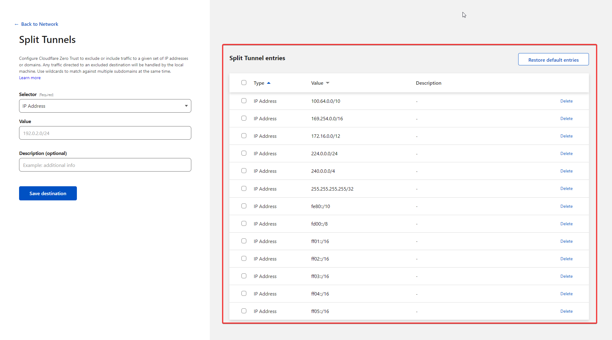

OK guys, I got this working... I can now access my home SERVERS/lan which is being the CGNAT. Everything is accessible, just like it was with wireguard...
I just needed to remove my home IP subnet range from the exclude list in the cloudflare zerotrust dashboard.
Hooe this helps other people... It would be great to have something like this built directly into Unraid, but am happy with the docker for now.
Just tried this. Took a couple mins to propagate but it is working for me as well. Very cool. Thanks for sharing this :)

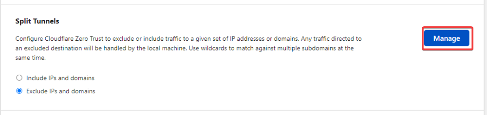

This here is the only thing I added under the tunnel in cloudflare's zero trust dashboard.
Then under zero trust settings (not under the tunnel) in settings > network, under firewall you will see split tunnels
in the manage page make sure the CIDR of your network that you added to the tunnel before is not in this list if you have "Exclude IPs and domains" selected. If you have Include selected make sure it is in the list.
After this I just connected to the warp client (make sure you are authenticated with your zero trust login) and you should be able to access local IPs from outside your network via Warp. Hope this helps :)

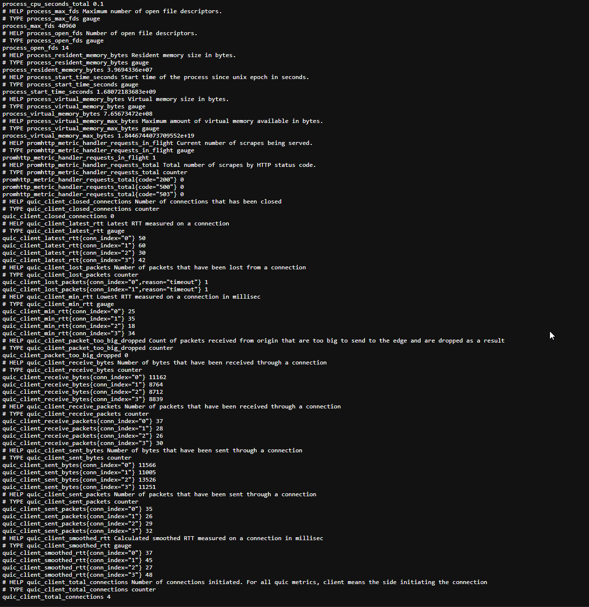

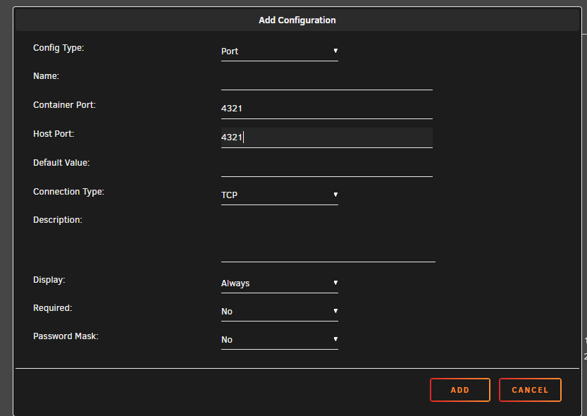

On 3/19/2023 at 5:26 PM, Retrogamer137 said:
Is there a known issue that the cloudflared tunnel is causing packetloss in games? Since I use this container instead of exposing my services with nginx proxy manager I have often packet loss in Hunt: Showdown.
Still investigating this issue but it seems that the packet loss is gone when I stop the container.
Logs of container seems not special.
I don't have much experience with hosting game servers through cloudflared tunnels as I usually just use a ddns service such as duckdns for my own servers that I share with a couple of friends. I do know that there are limitations in terms of upload limits on the free tier which im guessing you are on (as am I). I tried putting nextcloud behind my cloudflared tunnel and it would rate limit me or tell me The entity I was uploading was too large (HTTP 413). Thats what I would guess would be causing the packet loss issues in your game server. I would just avoid using cf tunnels for certain things such as this. Here are some things you can try to diagnose the cause if you are interested.
You can add a port to the unraid template and use the console for the container to launch the metrics server on that port to get further information from the tunnel. I will plan to add this as an addition env port that can be setup for this type of thing. I have some related screenshots below for this.
Open cosole for the container and run:
./cloudflared tunnel --metrics 0.0.0.0:4321 run --token $token
these metrics can also be put into grafana to make a more friendly looking UI with graphs that is easier to read. more information on the cloudflare docs here: https://developers.cloudflare.com/cloudflare-one/connections/connect-apps/do-more-with-tunnels/grafana/
Edited by Figro
