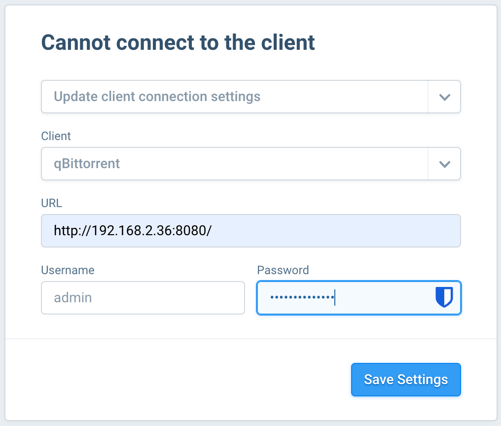

Is Flood-UI supposed to be working with the most recent qbit? I can't get it to connect. I have seen some older posts saying that it doesn't support newer releases, but I wonder if maybe they're dated.

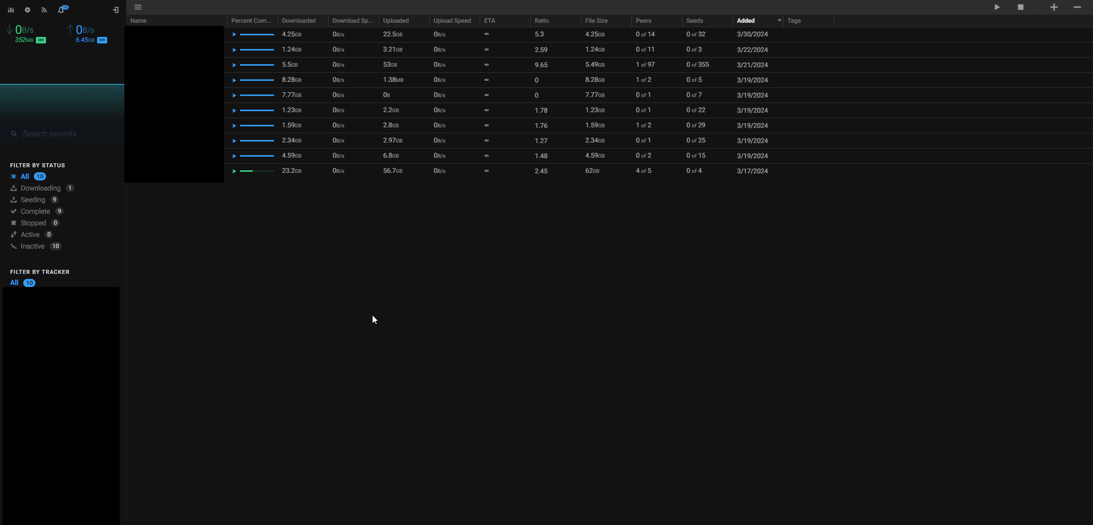

It should work, I am using qbittorrentvpn by markusmcnugen from the Unraid CA. Can you try removing the container and getting the latest template of my flood-ui container from CA. I did a update to the container and template for the :latest tag. If you are using :dev you should try and use :latest and see how it does. Let me know if anything changes or what you are experiencing
Edit: Screenshot of my instance
Edited by Figro

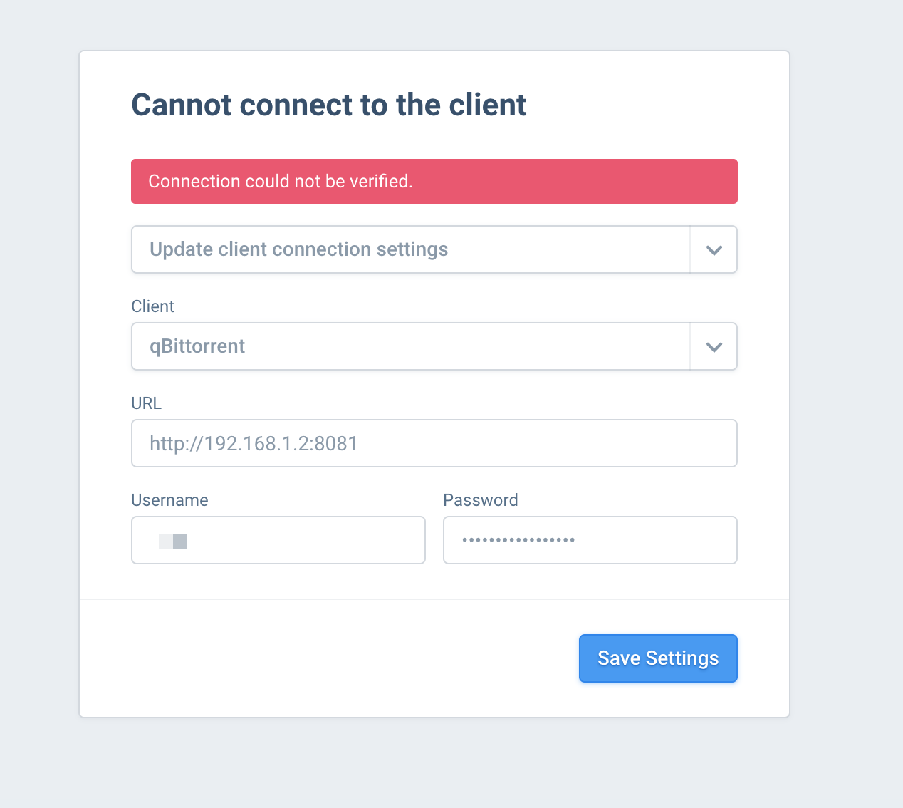

Thanks for the quick response. I have the latest binhex-qbittorrentvpn and I just uninstalled and reinstalled :latest Flood-UI. I'm getting "Can't connect to client." I have qbitmanage and cross-seed interacting with qbit just fine. Attached a couple screenshots.
I just tried the setup with the binhex container and i also get the same issue. Either these 2 containers are using different versions of qbit and there is a breaking change that flood-ui has not updated to fix yet or there is something in the binhex container that stops this from allowing it to connect. I am guessing its the containers are using different versions of qbit and that flood-ui isn't updated to support that yet. I know in the past there was similar issue. I will look into the 2 containers and let you know what I find.
Weird. Thanks for looking into it! Hopefully we can get it sorted out.
So it looks like the container you are using uses binhex/arch-int-vpn:latest which is an arch linux container and according to AUR its using version 4.6.4 https://archlinux.org/packages/extra/x86_64/qbittorrent-nox/. The container I am using seems to use ubuntu:20.04 the important bit being the 20.04 its not the latest so its also pulling a older version of qbit https://manpages.ubuntu.com/manpages/focal/man1/qbittorrent-nox.1.html 4.1.7. I am assuming this version difference is causing the differences between the two containers. I think version 4.6 of qbit broke some things inside of flood-ui. Have you tried using `:dev` to any luck? If I remember right the development code in github has fixes for this but flood-ui never released a build with fixes for 4.6. Not sure if flood povides nightly builds or something that I can use instead? Not sure there is much Me or you can do until they address the fix. Are you able to use the other container for your use case? Do you have any suggestions?

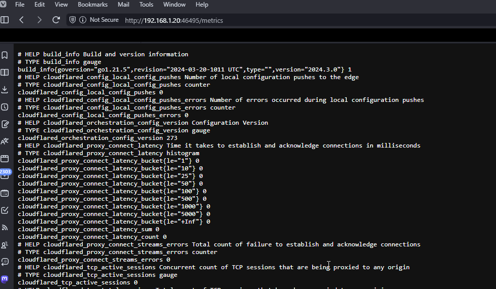

I'm trying to add the metrics to Prometheus, I've gone into the docker template, added a specific port, and also added the Port to the container - looks positive when I Apply, I can see the mapping on the Docker page, and the Logs tell me that the metrics server has started on that port, however when I try to add to Prometheus, or even just navigate to the path, it doesn't work :(
Anyone know where I'm going wrong?
Edited by erf89
2 minutes ago, erf89 said:
Just installed the cloudflare tunnel and all setup with hostnames now! :)
Hey, Thanks for your message. I have not touched the metrics portion of this but would love to get this sorted out for you and anyone else who would like to use this. My first guess for this is that the container has no exposed port defined in the dockerfile that was used to build this container. I can make an update to include this and see if this fixes your issue. Please go ahead and force check for updates you should have one there now and let me know if it works after this with the same settings shown in the screenshot.
If this works I will make some changes to the template for future users. Thanks for bringing this issue to my attention
Thanks for the quick response! Just did a force update but still not working, the Logs are very much the same though, says it's started the metrics server
Edited by erf89
Did some of my own testing. I think i made a mistake when putting the default value for TUNNEL_METRICS.
Change it from `localhost:46495` to `0.0.0.0:46495`
You should see something like this after. Let me know if you are still having issues with this.
Ahh yes, that's working now! Thanks for your help!
Awesome, I will update the CA template so that this is easier to do. Thanks!

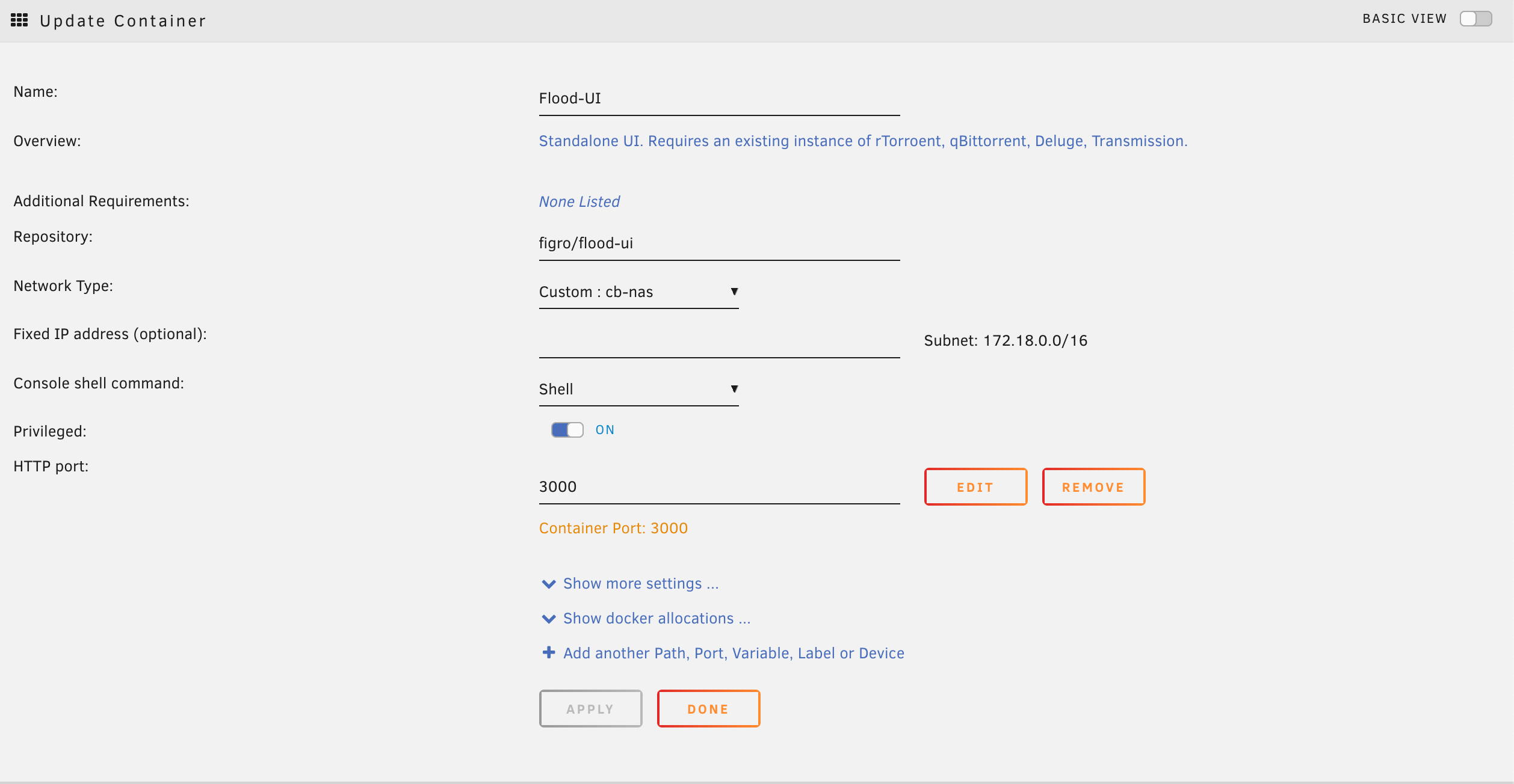

Should the FloodUI docker use PUID 99 and PGID 100 for safer security practice?
Done! Update the container and you should be running as 99:100 (nobody).
