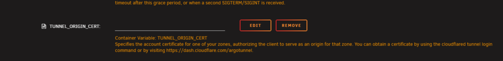

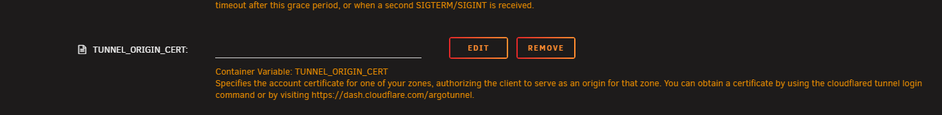

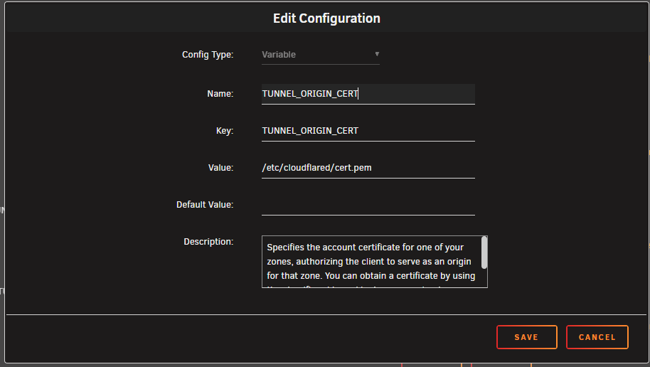

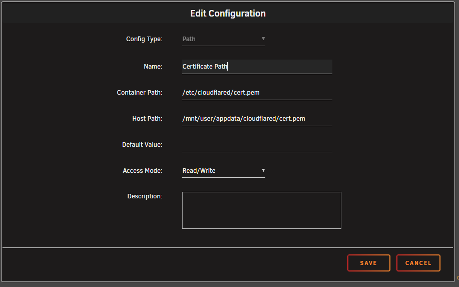

  • This here is the only thing I added under the tunnel in cloudflare's zero trust dashboard.     Then under zero trust settings (not under the tunnel) in settings > network, under firewal
  • So I did address this before but it seems like somewhere that got reverted. I added the --no-autoupdate flag back to the script. Updating the container should show this line on startup.   2023-06

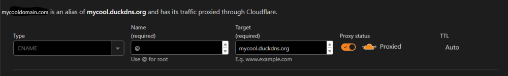

I have been using the Cloudflare tunnel successfully for a few days now. Yesterday, however, the Internet connection was reestablished (I was not at home) and my IP was changed. Since then, I have no longer been able to access my services via DNS.
After checking Cloudflare, I saw that my IP had not been updated in A-Record. When I did this manually, I was able to access my services again.
Does the container update the IP automatically or do I need to optimize it?
Translated with DeepL.com (free version)
If you use an A-record with a dynamic DNS, you will have to manually update in the Cloudflare DNS portion.
I recommend not setting an A-Record with IP for the domain; instead use a CNAME pointing the domain to a dynamic DNS host (one that can monitor your IP changes and updates automatically.)
I.E. (Not recommending any specific dynamic DNS hosts - just an example):
-Create a DuckDNS account and domain through them.
-Install the DuckDNS plugin on UnRAID
-In the Cloudflare DNS page for your "traditional" domain (i.e. mycooldomain.com)
Edited by timekills

2025-08-25T20:25:38Z ERR Cannot determine default origin certificate path. No file cert.pem in [~/.cloudflared ~/.cloudflare-warp ~/cloudflare-warp /etc/cloudflared /usr/local/etc/cloudflared]. You need to specify the origin certificate path by specifying the origincert option in the configuration file, or set TUNNEL_ORIGIN_CERT environment variable originCertPath=
When I was looking at the variable in the container said to go to download a cert.pem at this link: https://dash.cloudflare.com/argotunnel
I did this, but how do I put this file in this variable:
Also is this really needed? Or can I ignore the error?

Managed to get it working.
What I needed to do wat map the directory of the cert.pem to /etc/cloudflared/cert.pem
And set the variable TUNNEL_ORIGIN_CERT to /etc/cloudflared/cert.pem
Now it is working!
