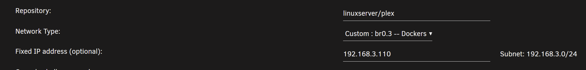

I have created a VLAN just for Docker containers.  This VLAN is 192.168.3.x.  My unRAID server and many other devices in my home are on the 192.168.1.x subnet.  UnRIAD server IP is 192.168.1.10
As long as this VLAN is something unRAID knows about and is visible in the docker container configuration page as a custom network (br0.3 in my situation), nothing special needs to be done to "connect" the Plex docker container on the 3.x subnet to the unRAID server on the 1.x subnet.

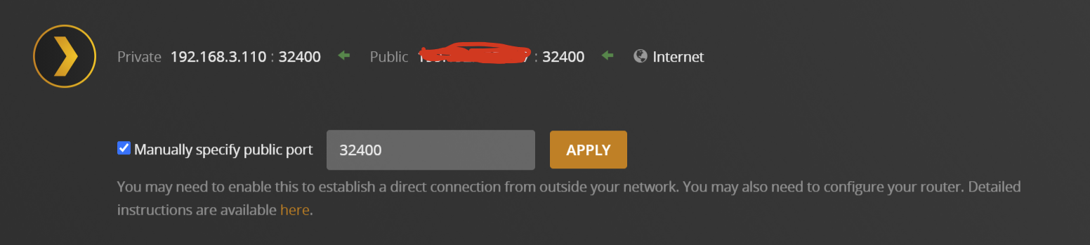

Plex clients
Because the router is configured to pass traffic between all LANs/VLANs automatically, Plex clients local and remote connect to 192.168.3.110:32400 without issue.  Here is the remote setup.
Plex clients
