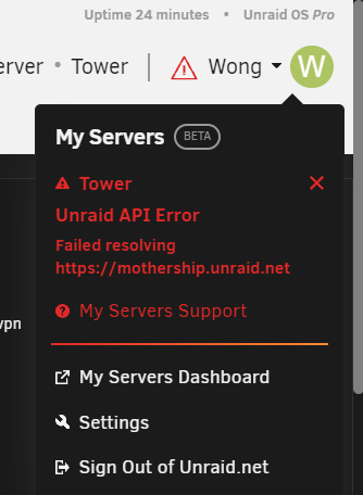

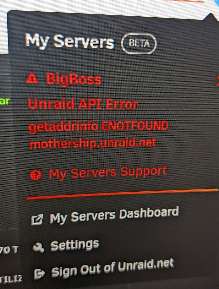

Failed resolving https://mothership.unraid.net
Just installed recently, I restarted my unraid after installing the plugin. It does show online from time to time but it doesn't last longer than 10 seconds. I have seen different type of errors as well, such as Unexpected token and Timed-out connecting to "https://mothership.unraid.net/relay" . Anyone could help me with this?

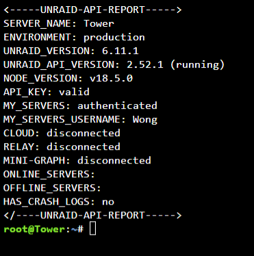

What's the command to run the api report?

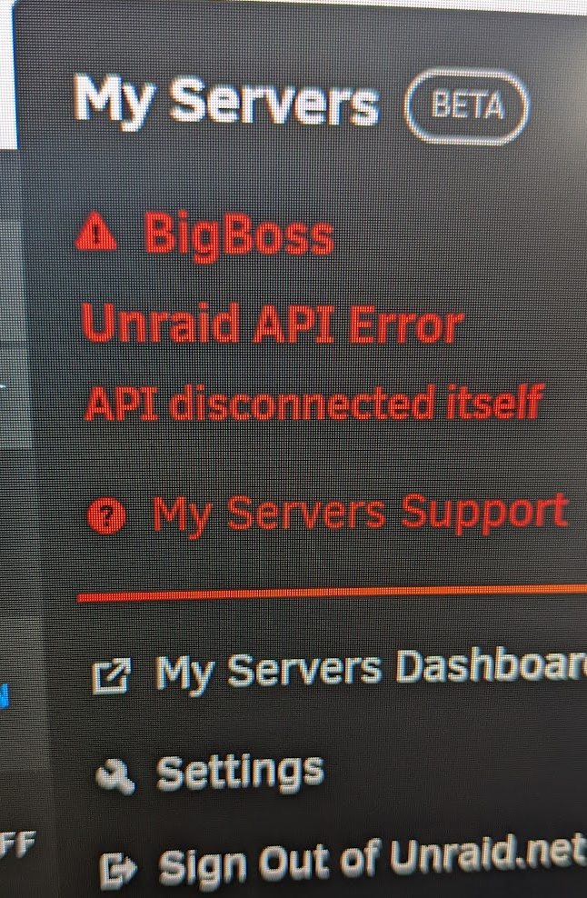

I am getting constant local disconnects, server disappears and becomes inaccessible every 30 mins or so for 3-4 mins at a time and comes back with an Disconnected from Unraid API error. really lost here please help
Just happened to me.
chrome_j25hqIgZLi.thumb.png.c2276575e4edd623f958c620ff2068fc.pngchrome_KnhO11W9TL.thumb.png.9b4d6fa5d2ead38d67255acb73f592a8.pngchrome_gYconS0a96.thumb.png.2fa07b5f4b2ff4d7200c40c6941f75cb.pngchrome_Buj7IeTRHG.thumb.png.341b8a25128b49c10e13ca05817f2dcc.png

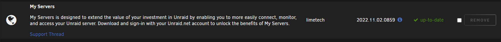

What version of the My Servers plugin do you have? Please update to yesterday's release:
  https://forums.unraid.net/topic/112073-my-servers-releases-and-announcements/#comment-1186943
This can happen if there is a temporary Internet outage between your server and ours. If it is short then it really isn't a big deal, maybe we can look at toning down the messaging so it isn't so scary.
If you have long outages on the latest release and your Internet is up please, upload your diagnostics.zip (from Tools -> Diagnostics)

it is a big deal. my server is not functioning, goes offline every 20-30 mins for 3-4 mins at a time.
diags attached.
no internet outages on my end.
bigboss-diagnostics-20221103-1609.zip

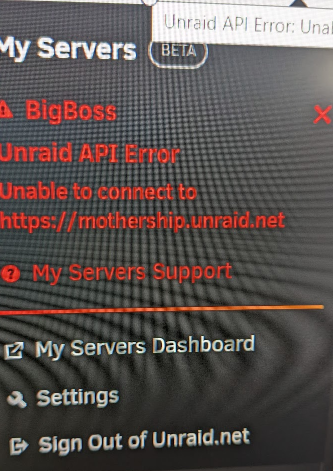

Same issue as the other poster, like I mentioned. It resolved itself, but then just happened again today. I got this error:
ERROR [getaddrinfo ENOTFOUND mothership.unraid.net]
Do you want the whole diagnostics file? Because everything else is working just fine. It's just the My Servers plugin that fails and every single time it appears mothership.unraid.net becomes unavailable. Is it normally pingable? Because it's not as I type this.
This is a DNS error. It likely means that the network connection between your server and your DNS server was down.
If the only thing that is affected is this error message then you can probably just ignore it. However, if your whole server has network connectivity issues during this time then this is a symptom and not the cause.
