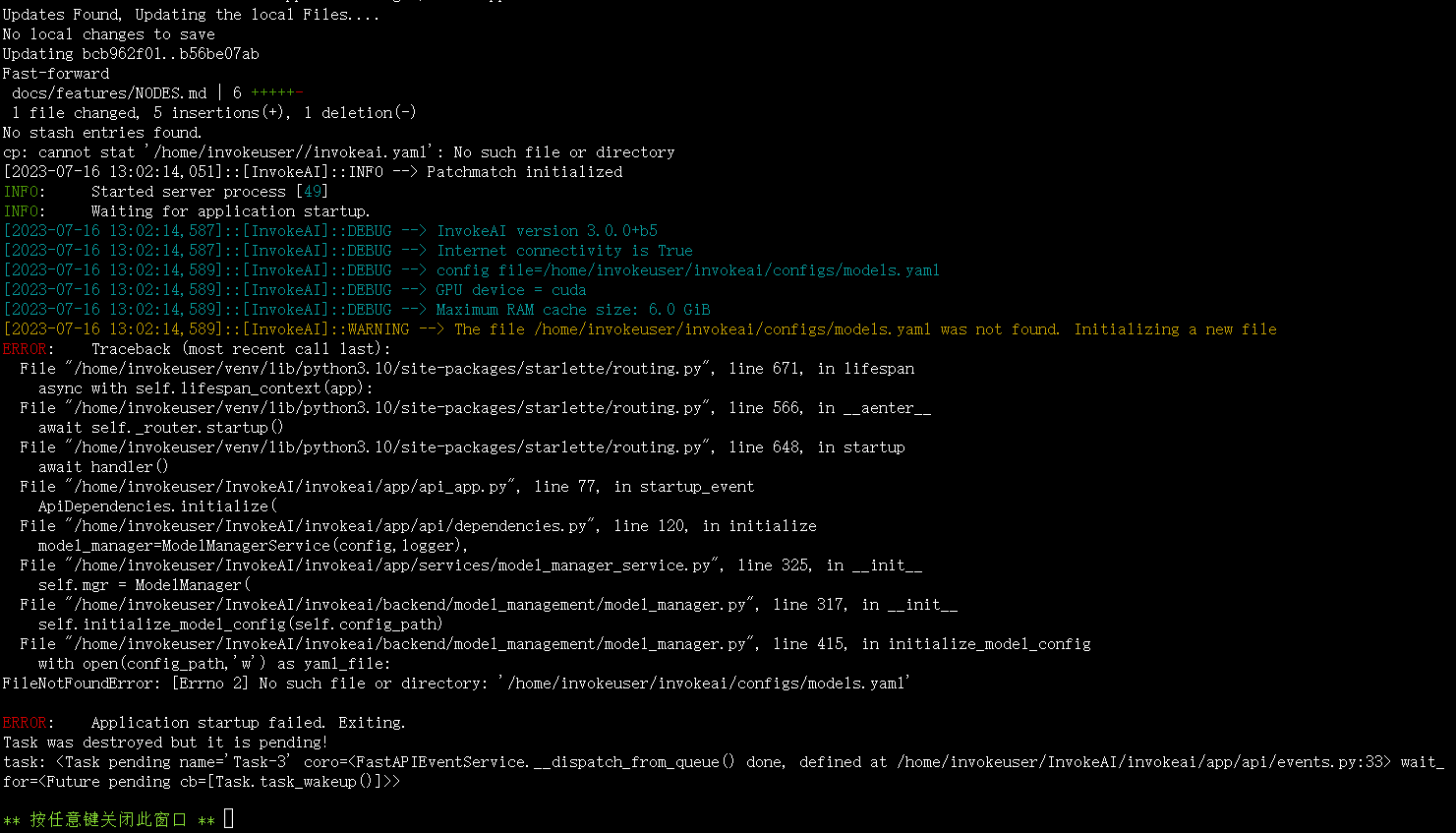

I am get the erro,I am using the full manuel install,I tried many times always showed this erro. Can you help me check it?
Checking if The Git Repo Has Changed....
remote: Enumerating objects: 39, done.
remote: Counting objects: 100% (39/39), done.
remote: Compressing objects: 100% (11/11), done.
remote: Total 39 (delta 28), reused 39 (delta 28), pack-reused 0
Unpacking objects: 100% (39/39), 7.85 KiB | 618.00 KiB/s, done.
From https://github.com/invoke-ai/InvokeAI
   9fb0b0959..ccbfa5d86  sdxl-support -> origin/sdxl-support
Local Files Are Up to Date
cp: cannot stat '/home/invokeuser//invokeai.yaml': No such file or directory
[2023-07-16 07:49:31,847]::[InvokeAI]::INFO --> Patchmatch initialized
INFO:     Started server process [71]
INFO:     Waiting for application startup.
[2023-07-16 07:49:32,396]::[InvokeAI]::DEBUG --> InvokeAI version 3.0.0+b5
[2023-07-16 07:49:32,396]::[InvokeAI]::DEBUG --> Internet connectivity is True
[2023-07-16 07:49:32,765]::[InvokeAI]::DEBUG --> config file=/home/invokeuser/invokeai/configs/models.yaml
[2023-07-16 07:49:32,765]::[InvokeAI]::DEBUG --> GPU device = cuda
[2023-07-16 07:49:32,765]::[InvokeAI]::DEBUG --> Maximum RAM cache size: 6.0 GiB
[2023-07-16 07:49:32,765]::[InvokeAI]::WARNING --> The file /home/invokeuser/invokeai/configs/models.yaml was not found. Initializing a new file
ERROR:    Traceback (most recent call last):
  File "/home/invokeuser/venv/lib/python3.10/site-packages/starlette/routing.py", line 671, in lifespan
    async with self.lifespan_context(app):
  File "/home/invokeuser/venv/lib/python3.10/site-packages/starlette/routing.py", line 566, in __aenter__
    await self._router.startup()
  File "/home/invokeuser/venv/lib/python3.10/site-packages/starlette/routing.py", line 648, in startup
    await handler()
  File "/home/invokeuser/InvokeAI/invokeai/app/api_app.py", line 77, in startup_event
    ApiDependencies.initialize(
  File "/home/invokeuser/InvokeAI/invokeai/app/api/dependencies.py", line 120, in initialize
    model_manager=ModelManagerService(config,logger),
  File "/home/invokeuser/InvokeAI/invokeai/app/services/model_manager_service.py", line 325, in __init__
    self.mgr = ModelManager(
  File "/home/invokeuser/InvokeAI/invokeai/backend/model_management/model_manager.py", line 317, in __init__
    self.initialize_model_config(self.config_path)
  File "/home/invokeuser/InvokeAI/invokeai/backend/model_management/model_manager.py", line 415, in initialize_model_config
    with open(config_path,'w') as yaml_file:
FileNotFoundError: [Errno 2] No such file or directory: '/home/invokeuser/invokeai/configs/models.yaml'
ERROR:    Application startup failed. Exiting.
Task was destroyed but it is pending!
task: <Task pending name='Task-3' coro=<FastAPIEventService.__dispatch_from_queue() done, defined at /home/invokeuser/InvokeAI/invokeai/app/api/events.py:33> wait_for=<Future pending cb=[Task.task_wakeup()]>>

I am getting this same exact error.  I just tried installing this today.
Edited by Spiffy
models.yaml
can you do a test for me copy the attached models.yaml into your appdata/invokeai/userfiles/configs/ folder and see if the same error happens
Edited by mickr777
1 hour ago, mickr777 said:
Thank you so much, I tried just now, but it still can not work
Are you sure we should put this in the userfile? but this erro said can not find in invokeAI/config
there shouldn't be any config folder in the invokeai folder but you can add the folder and models.yaml there and see if that helps
I tried , it doesn't work either.
looks like they changed the way the invokeai-configure script works I will have to do some testing
found the issue (I think) grab the updated start.sh file info from main post and delete container (but remove delete image tick box)
recreate the container, as the main post
or used the Simplified Install for main, as I pushed an update to it
(use either way but make sure to delete the appdata/invokeai/venv/pyvenv.cfg and if you have it appdata/invokeai/userfiles/invokeai.init files)
Edited by mickr777
Thank you for the help, it works now. It troubled me in the past few days😂

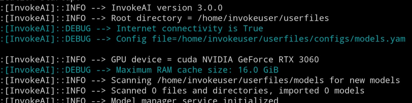

Also if it using the gpu you should see it on start in your docker logs
Edited by mickr777
13 hours ago, mickr777 said:
https://invoke-ai.github.io/InvokeAI/features/PROMPTS/#how-dynamic-prompts-work
That might help
If you have discord you should join the invokeai server
https://discord.gg/ZmtBAhwWhy
Greta, thanks
Yep seems its detected
[2023-07-26 21:18:04,801]::[InvokeAI]::INFO --> InvokeAI version 3.0.0[0m
[2023-07-26 21:18:04,801]::[InvokeAI]::INFO --> Root directory = /home/invokeuser/userfiles[0m
[2023-07-26 21:18:04,801]::[InvokeAI]::DEBUG --> Internet connectivity is True[0m
[2023-07-26 21:18:05,101]::[InvokeAI]::DEBUG --> Config file=/home/invokeuser/userfiles/configs/models.yaml[0m
[2023-07-26 21:18:05,101]::[InvokeAI]::INFO --> GPU device = cuda NVIDIA GeForce RTX 2070[0m
[2023-07-26 21:18:05,101]::[InvokeAI]::DEBUG --> Maximum RAM cache size: 6.0 GiB[0m
[2023-07-26 21:18:05,104]::[InvokeAI]::INFO --> Scanning /home/invokeuser/userfiles/models for new models[0m
[2023-07-26 21:18:05,303]::[InvokeAI]::INFO --> Scanned 0 files and directories, imported 0 models[0m
[2023-07-26 21:18:05,303]::[InvokeAI]::INFO --> Model manager service initialized[0m
O[0m: Application startup complete.

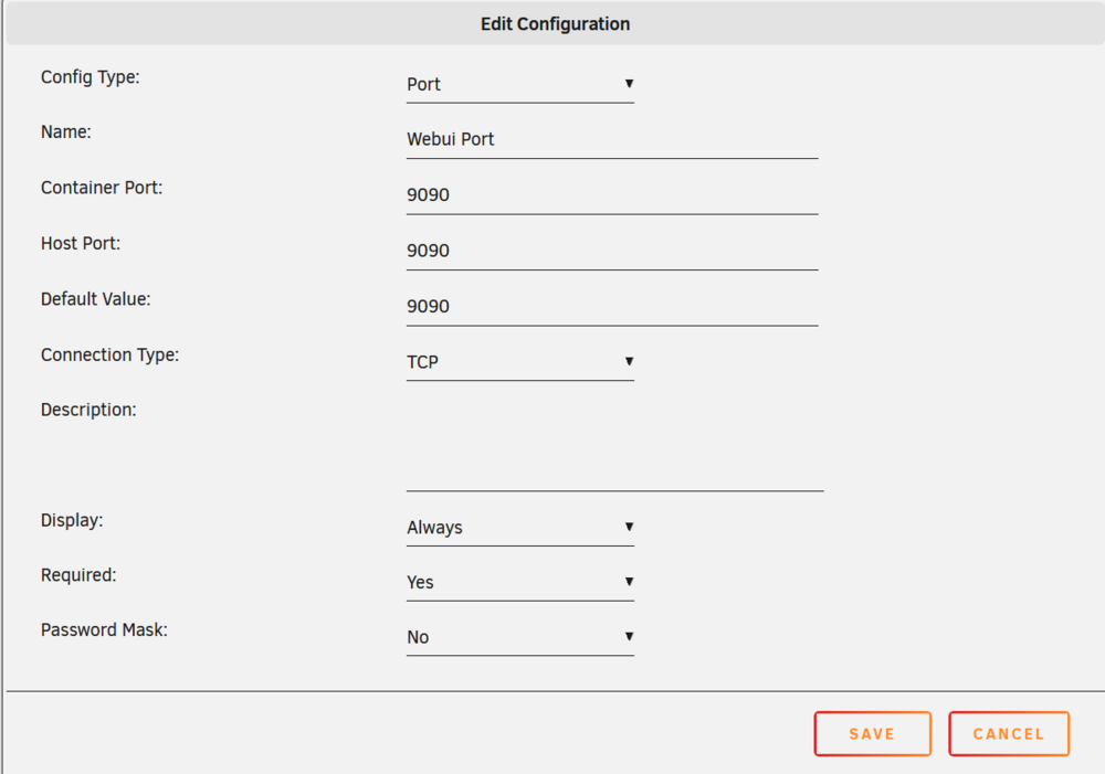

fix for UI not loading I forced the docker to use the dev WebUI.
if you are using the Dockerhub file:
click the invokeai container and click update
once updated right click the container and go edit
change this line to the following
next find webui port and click edit and change it to the following
to access the webui now you have to use yourunraidip:5173.
if you used the manual install:
I have updated the files in main post you will need to rebuild your image and container with them.
once built change the ports as the same as above
also if you get startup aborted:
there was a issue where the needed models were not downloaded, to force a download, delete the file /invokeai/venv/pyvenv.cfg and rerun the docker, this will force the download of missing models.
Edited by mickr777

Friends, I figured it out. The console output says this
[2023-08-23 16:50:41,249]::[uvicorn.error]::INFO --> Uvicorn running on http://0.0.0.0:9090 (Press CTRL+C to quit)
So I pointed to http://<my-docker-IP>:9090 and tried to use the app there.
Do not use 9090, use 5173 instead, as configured in the docker template.
