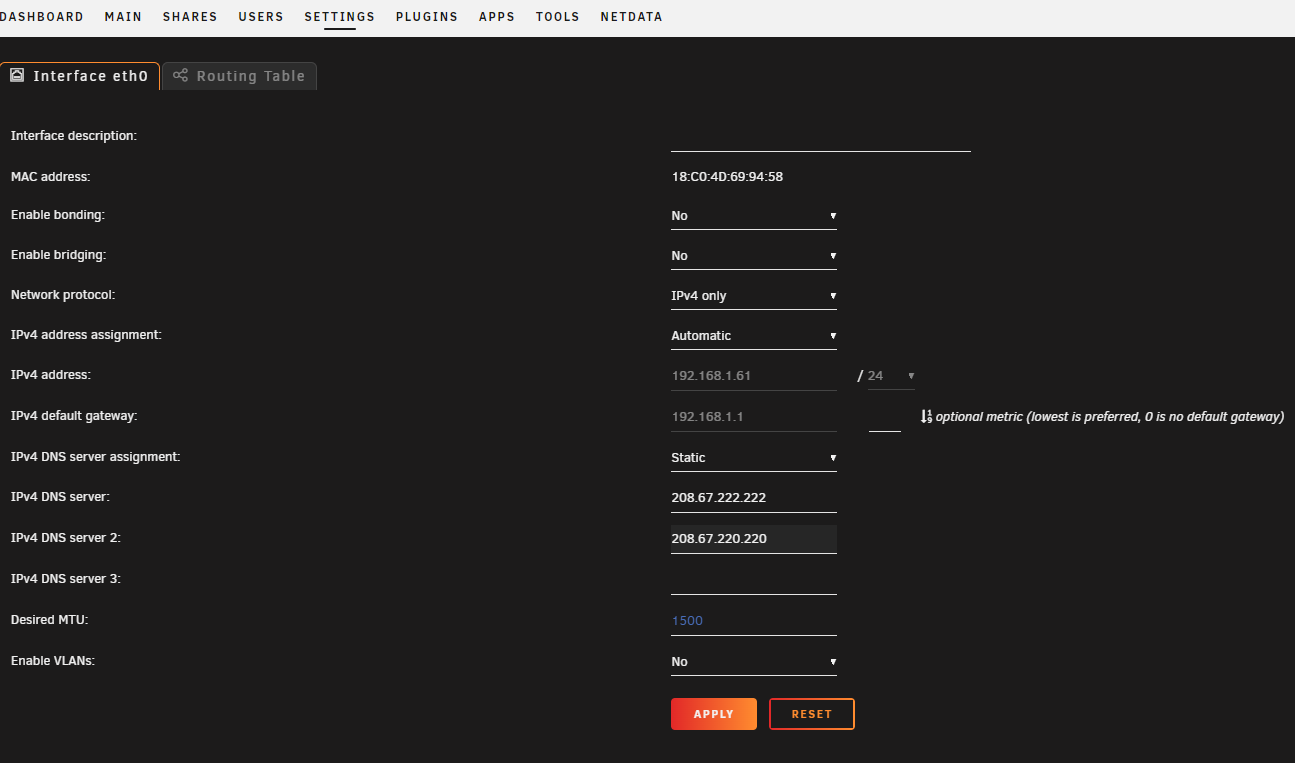

You can also try setting static DNS addresses (I'm a fan of 208.67.222.222 and 208.67.220.220) instead of pointing the DNS to the router's IP address
I updated dns to these still no internet internally

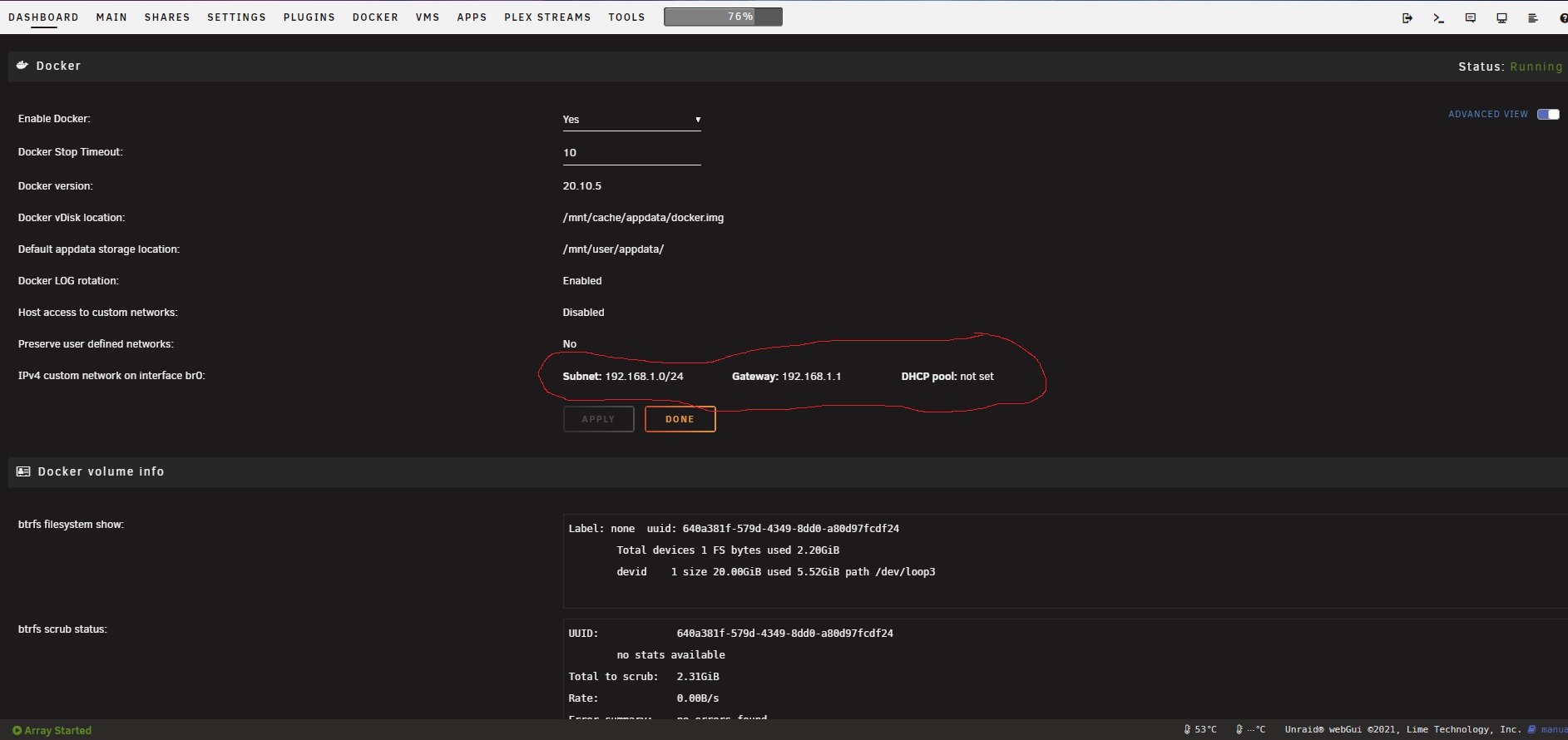

Are these settings ment to be set to these at all?

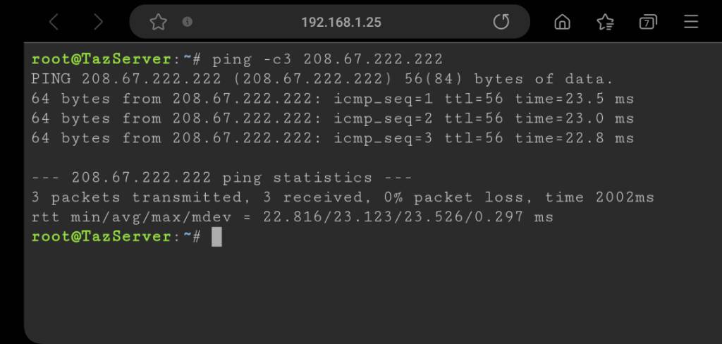

So, from a command prompt
ping -c3 208.67.222.222
Says destination unreachable?
This is what it came back with Screenshot_20221213_084459_Samsung Internet.jpg

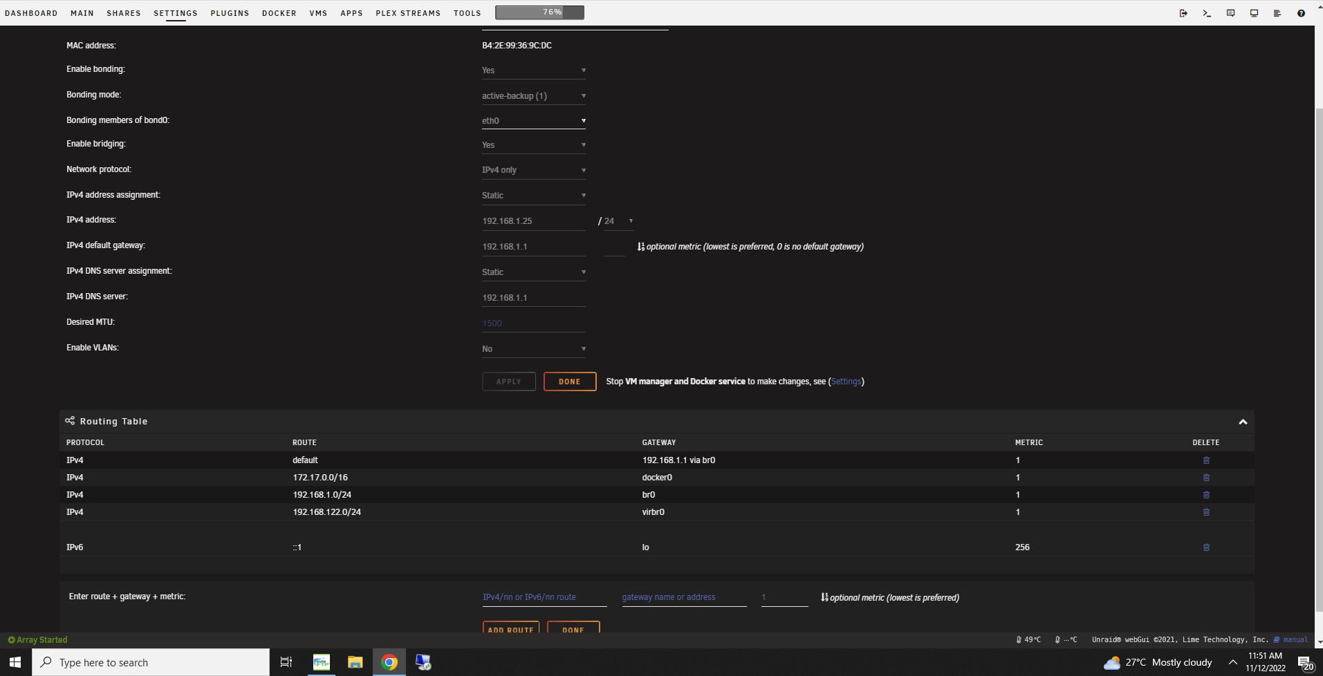

ok is this setting normal
