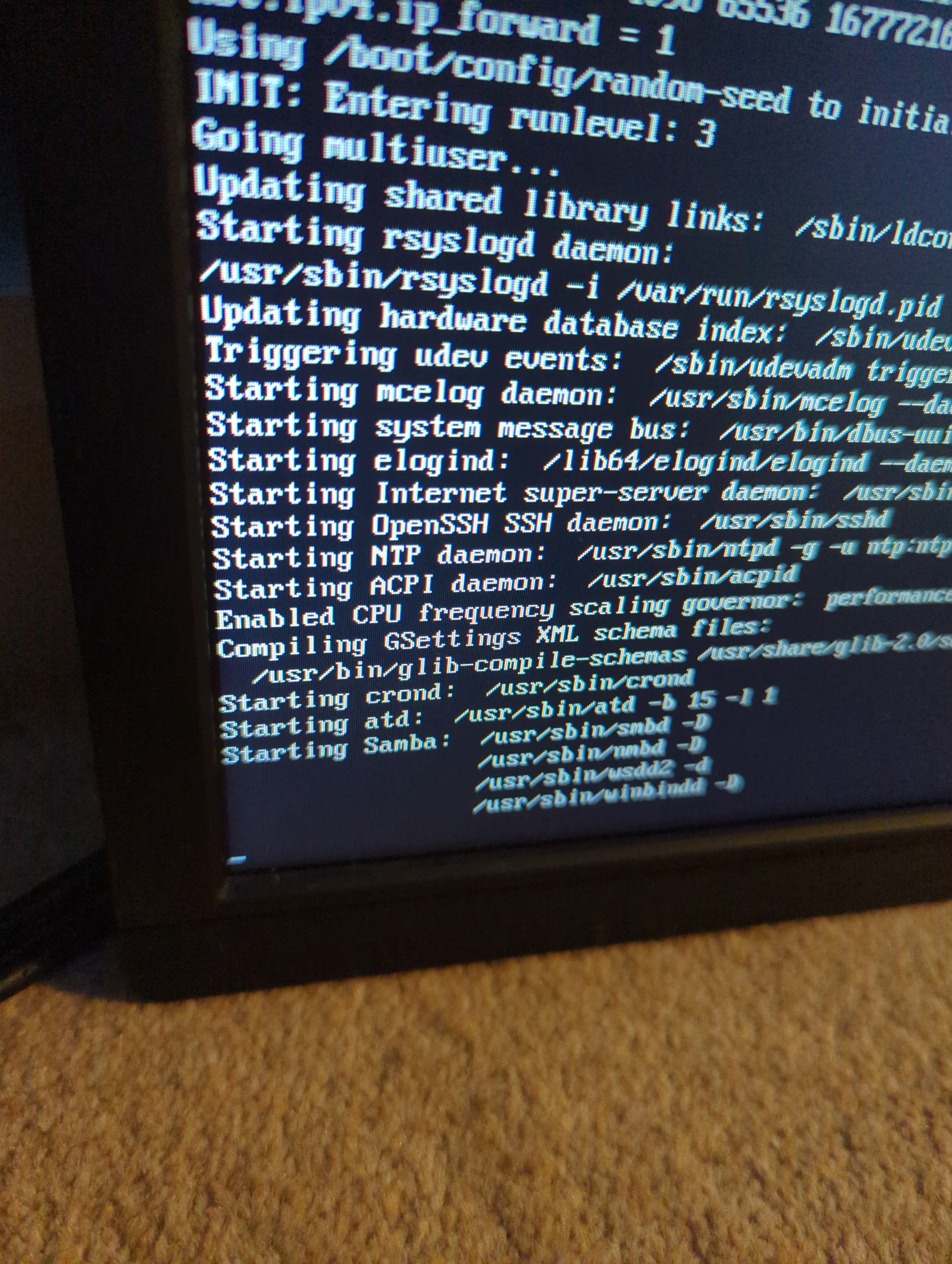

server not booting, stuck starting samba
My server is hanging at winbindd, I can't boot into safe mode either.
I tried deleting nvidia plug in folder and network.cfg aswell. Nothing I try seems to be working.
If there's no internet access it can be there for a few minutes.
