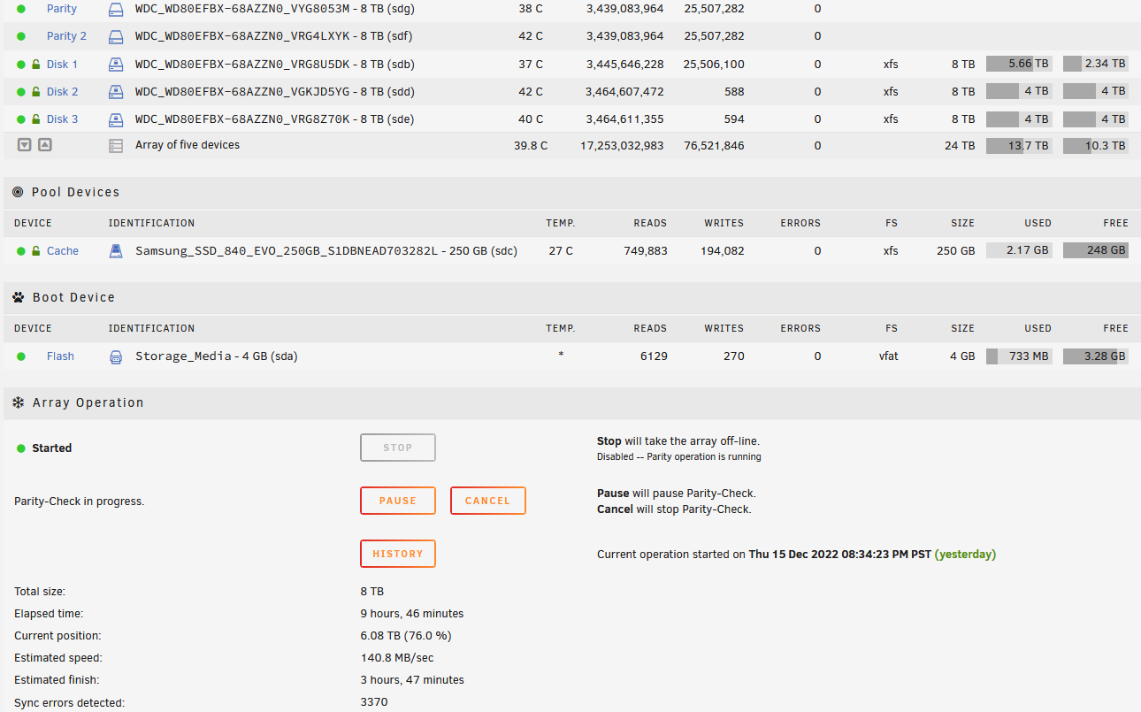

My monthly parity check ran today and I am getting conflicting info. The pop up notification says 0 errors found but the dashboard says 3370 found. I am rerunning the check now but how should I proceed if there is conflicting information? IMG-0797.thumb.jpg.b432f14e142ee792071b0ed896588a18.jpg

Also says parity check was currently running. Did you let it complete?

syslog shows you were running a noncorrecting parity check and getting sync errors on parity2 (you probably don't need dual parity with so few disks).

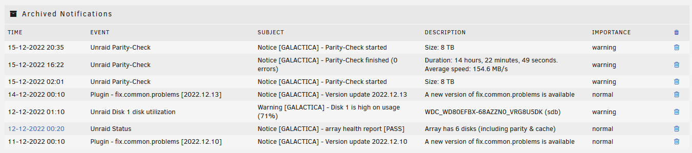

Screenshot 2022-12-16 062024.png2122348728_Screenshot2022-12-16062113.thumb.png.791395d822cfc0695a1bca12a04a3f1c.pngI did get a successful parity build when I set up the array. The second item on the first screen grab I am posting now is the archived notifications showing there were 0 errors on the parity check. Unless I am reading this wrong. I should have waited but got nervous and started a new parity check.
