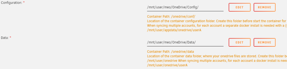

Create a ‘onedrive’ folder under /mnt/user/appdata/ and again create subfolders (userA, userB etc.) for different users
Step 5:

            - /mnt/user/appdata/onedrive/userA:/onedrive/conf/
            - /mnt/user/onedrive/userA:/onedrive/data

·       Under volumes change the path left from the colon to the correct config and data folder (so ‘/mnt/user/appdata/onedrive/userA’ and ‘/mnt/user/onedrive/userA’ if the example above has been followed. Don't touch the values right from the colon.

Here is how I fixed the permission issue:
1. stop the onedrive docker
2. go to the folder you selected for the "Configuration:" of the docker
3. download the original config file from here https://raw.githubusercontent.com/abraunegg/onedrive/master/config
4. remove the # ONLY infront of the settings you want to change, and change the setting accordingly (i.e. sync_dir_permissions = "777" and sync_file_permissions = "777")
5. do not touch any of the other settings you dont want to change!
6. (optional) delete the items.sqlite3, items.sqlite3-wal and all your allready synced files to start fresh
6. start the docker
7. all newly synced files will have their permissions set to drwxrwxrwx / -rwxrwxrwx
