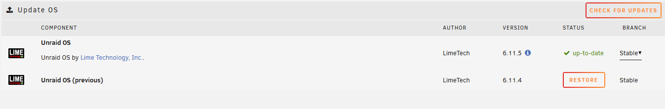

19 minutes ago, Steve1985 said:
About an hour ago i pressed the update button in the UnRAID GUI. My unraid server was on version 6.10.3. Should be straight forward.
Was it here that you pressed the update button?
The reason for the question is that it is necessary to know if you were updating the flash drive with the files for the new versions or rebooting the server to install the new version of Unraid on the server from that updated flash drive.
Edited by Frank1940
Yes it was there. And i did press "reboot now" when it appeared.
