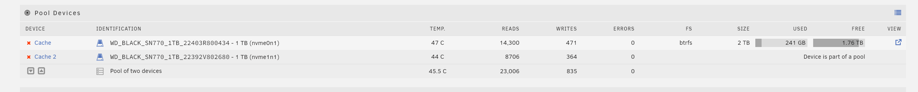

The cache drives are disabled with contents emulated. Not sure why. The cache drives are NVME and as far as I know haven't had an issue before.

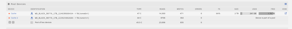

pool drives can't be emulated since there is no parity. Not clear what that is about since pool does seem to be mounted. Post a screenshot of Main - Pool Devices.

new diagnostics are attached.

To correct the pool problem, stop array, unassign both cache devices, start array, stop array, re-assign both cache devices, start array.
Thank you. Everything looks to be working correctly now.
