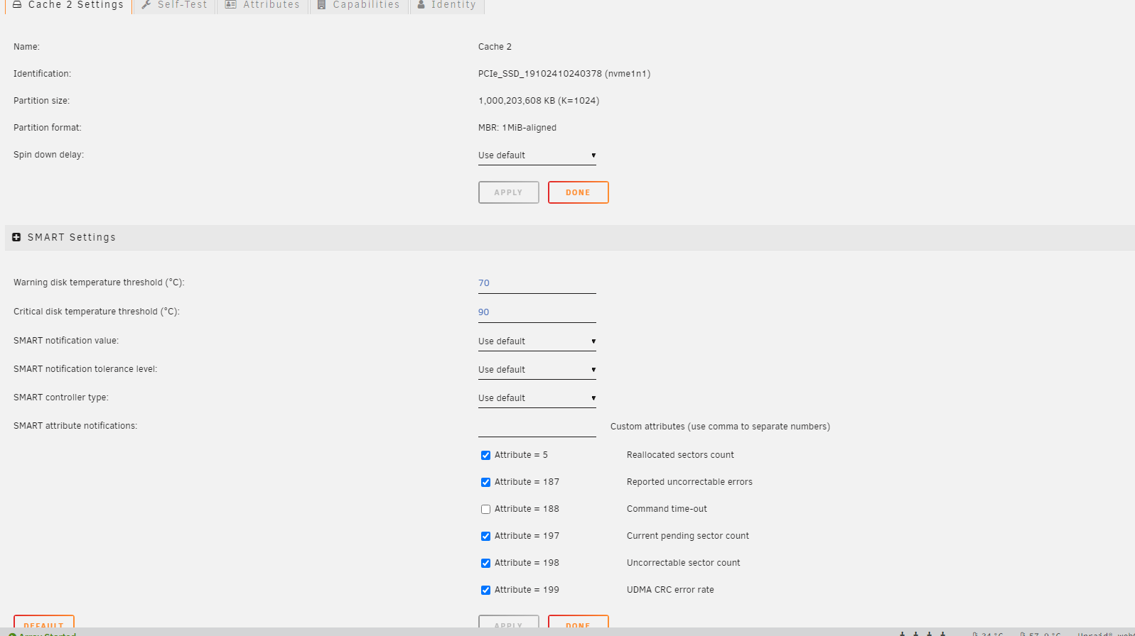

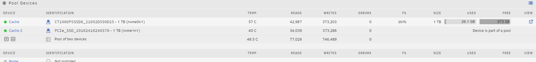

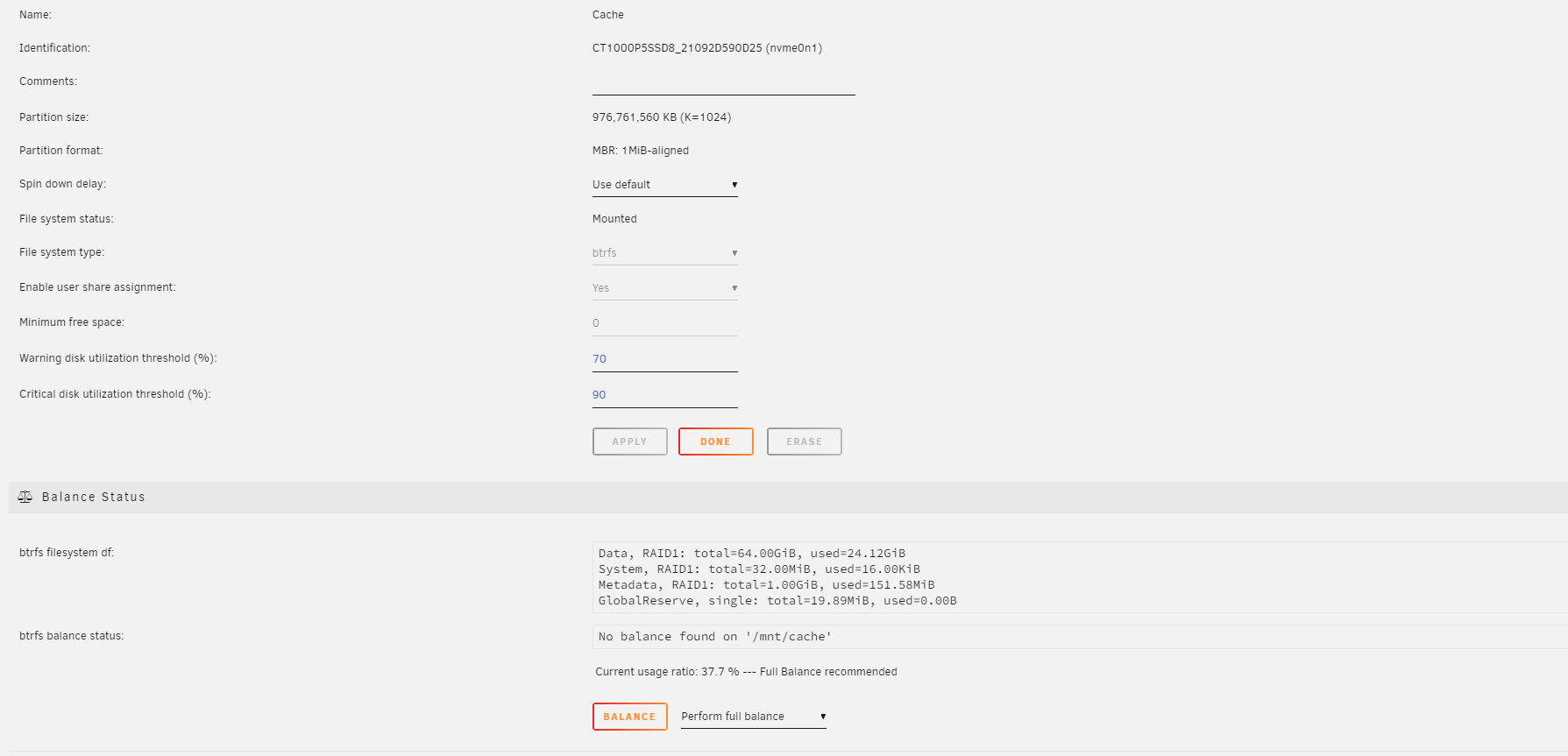

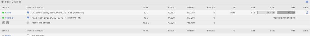

I accidentally mis-allocated a new NVME drive I put in the system.   I meant to make it a new cache pool that I was going to use for VMs only, but accidentally added it to the existing cache pool which houses mover/appdata/etc.
I would like to remove it.... but it seems that breaks the entire cache pool if i do that.   What is the procedure for removing a disk from the cache pool.
Screenshots attached of the cache details.

Unassign the device you want to remove (leave it unassigned for now) and start the array, once the removal is complete you can assign to a new pool.

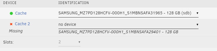

ill try again, but that resulted in the cache pool not mounting due to a missing device.

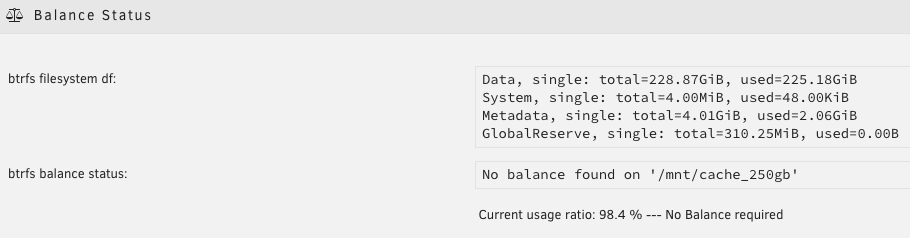

Clicking through to the 'cache_250gb' pool in the Unraid GUI, in the 'Balance Status' section, says that 'Balance is only available when array is Started'.

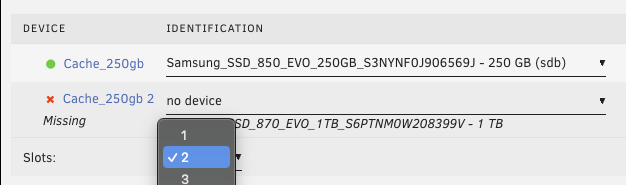

After stopping the array again, the 2nd slot is no longer showing as a 'missing' disk:
I think I got to this state before (or something that looked like it) on my own, but then when the 1TB disk was re-introduced, it seemed to break things. I'll wait for your next steps so as not to assume; but wondering if that will be the case again.

9 hours ago, devalias said:
Interesting.. I can't guarantee that my description isn't missing any steps; but as a 'current' example, here is the UI showing the pool with 2 slots, and the missing device, and I can definitely change those slots. Which I believe is the same sort of state it was in when I first got myself into this situation. Maybe a bug, if that's not meant to be possible?
Hmm, not sure how that is happening, if I unassign a pool device I see this:
Note that the number of slots is greydout, it's not selectable, I thought that it might be different if the device is missing, vs you unassign it, but I see the same if I make the device drop, can you detail all the steps done to see if you are doing something different?
Regarding the pool, good that it's mounting now but I do see a warning:
May 25 09:54:29 Dalekanium kernel: BTRFS warning (device sdb1): devid 1 physical 0 len 4194304 inside the reserved space
It's just a warning, not an error, so it may not be serious, and from what I can see a balance may fix it, so you have two options:
- backup that pool somewhere else and then reformat
- free up some space on that filesystem, since it's very full, at least 20GB, then run a balance to see if the error goes away, before doing this I would recommend at least making sure anything important in the pool is backed up somewhere else, in case it goes wrong.

These are the steps I followed just now:
  • Made a backup of all the files on my 250GB drive: `rsync -av --delete /mnt/cache_250gb/ /mnt/disk6/TempDumpBackups/cache_250gb/`
  • Set 'Unraid -> Settings -> Disk Settings -> Enable auto start' to 'No'.
  • Rebooted my NAS
  • Logged back in to the Unraid web GUI
  • Confirmed that the 250GB drive is showing as the only device in the 'cache_250gb' pool
  • Confirmed that the 1TB drive is showing in 'Unassigned disk devices'
  • Checking the BTRFS filesystem, the 1TB drive is still showing:
    • # btrfs filesystem show
      Label: none  uuid: f71d2fa8-91a0-4495-8baf-e1f77bd40eb2
      	Total devices 1 FS bytes used 226.42GiB
      	devid    1 size 232.89GiB used 232.89GiB path /dev/sdb1
      	devid    2 size 931.51GiB used 0.00B path /dev/sde1
  • Checking the mapping for the 1TB drive after rebooting (and noting that it has changed from what it was previously)
    • # fdisk -l | grep -B 1 -A 5 "Samsung"
      Disk /dev/sdb: 232.89 GiB, 250059350016 bytes, 488397168 sectors
      Disk model: Samsung SSD 850
      Units: sectors of 1 * 512 = 512 bytes
      Sector size (logical/physical): 512 bytes / 512 bytes
      I/O size (minimum/optimal): 512 bytes / 512 bytes
      Disklabel type: dos
      Disk identifier: 0x00000000
      Disk /dev/sde: 931.51 GiB, 1000204886016 bytes, 1953525168 sectors
      Disk model: Samsung SSD 870
      Disklabel type: dos
  • Tried checking the BTRFS filesystem on the 1TB drive
    • # btrfs check /dev/sde
      Opening filesystem to check...
      No valid Btrfs found on /dev/sde
      ERROR: cannot open file system
      # btrfs check /dev/sde1
      parent transid verify failed on 166051840 wanted 100181326 found 100181352
      Ignoring transid failure
      ERROR: root [2 0] level 0 does not match 2
      ERROR: could not setup extent tree
  • Ran `blkdiscard` to wipe the 1TB drive:
    • # blkdiscard -f /dev/sde
      blkdiscard: Operation forced, data will be lost!
  • Confirmed that the 1TB drive is no longer showing in BTRFS
  • Checked that no filesystem was shown for the 1TB drive in Unraid web GUI
  • Set the 'cache_250gb' slots back to 1
  • Checked/updated all 'Shares' that used to be on 'cache' were now updated to properly be set to 'cache_250gb'
  • Started the array

  • Went to the 'cache_250gb' pool settings, and ran the 'Balance' command (which is still running now)
    • ## From the Unraid Web UI
      Balance Status
      btrfs filesystem df:
        Data, single: total=228.87GiB, used=225.71GiB
        System, single: total=4.00MiB, used=48.00KiB
        Metadata, single: total=4.01GiB, used=1.24GiB
        GlobalReserve, single: total=304.28MiB, used=16.00KiB
      btrfs balance status:
        Balance on '/mnt/cache_250gb/' is running
        5 out of about 236 chunks balanced (6 considered),  98% left
      ## From SSH / Terminal
      # btrfs balance status /mnt/cache_250gb/
I'll edit this post with further info once the balance command finishes running; and then potentially post another diagnostics .zip to go along with it.
Edit: Part way through the balance I realised I hadn't removed the old `docker.img` file from the 'cache_250gb' pool; so have done that now.. we'll see if that causes any issues that requires another balance again after this I guess..
Edited by devalias
Yes, re-start the array once the balance finishes and post new diags.
Balance finished:
Balance Status
  Data, single: total=106.00GiB, used=105.37GiB System, single: total=32.00MiB, used=16.00KiB Metadata, single: total=2.00GiB, used=1.22GiB GlobalReserve, single: total=292.67MiB, used=0.00B
  No balance found on '/mnt/cache_250gb'
Current usage ratio: 99.4 % --- No Balance required
Diagnostics: dalekanium-diagnostics-20240528-2105.zip
The btrfs warning is gone, so everything should be OK now, you can now also create the new pool with the other device.

Hey all,
Playing with UNRAID since 5 days, I have a read only problem and i can't seem to solve it.
I think i did something stupid. I had some read only problems due to full disk.
  • So i removed some stuff, to make space. Didn't work
  • Convert to single mode. Didnt really do anything...
  • Removed my second cache drive, rebooted and added it again. (don't do this, it almost made my cache 'unmountable')
  • rebooted several times
Now i can see the files on my disk, but still i can't start any dockers or VMs. What should I do (and how)? Any input would be welcome.
Diagnostics in attachment.
Just can't get any writes on them.
Main screen screenshot:
The cache is now read only and i can't seem to solve my problem. Also when I remove my second cache drive it doesn't want to work.
Fix common problems screenshot:
image.thumb.png.c84c6446dbdc1eef6331c938da4d0185.pngimage.thumb.png.303e11ae0af3f9cefd0746979bdb01f8.png
Greets,
Stijn
tower-diagnostics-20241116-1608.zip
nvme0 is only formatted as a 100MB device, backup the pool contents, then wipe/erase the pool and reformat, post new diags to confirm it's correct before restoring the data.
